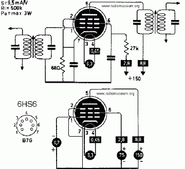

I have a couple radios that use these. There doesn't seem to be a suitable replacement for them. I assume low noise?
It appears to be like a 6BA6 but 2.5 times its transconductance, or a 12BY7 in a 7 pin base.
I think the nearest replacement would be a 6CB6.
Special? What do you mean?
It was made as an IF amplifier and limiter for FM receivers. It has a sharp cut off and the anode voltage of around 150volts.
7 pin B7G socket.
Nothing special that I can see.
7 pin B7G socket.
Its transconductance in 9.5mS, much higher than an ordinary IF pentode.
The only "special" is controlled heat-up time. Otherwise, 6AH6, 6AC7, 6AJ7, 6Ж5П are slightly better. 6AH6 and 6Ж5П are pin to pin compatible.
You can use also 6Ж38П or even 6Ж1П, but with lower gain.

Many Drake receivers wire two heaters in series across a 12.6 volt winding. Their heater current's MUST match to avoid blown or under heated tubes. The controlled warm up characteristic is also highly desirable. It also draws 450 mA of heater current which is not too common.
The 6HS6 has a much higher transconductance than the more common 6AU6 or 6BA6. The transconductance of the 6HS6 is what determines the ability of the receiver to perform good in weak signal, especially on the higher frequency bands like 10 meters.
Some people have successfully used the 6AH6A or 6AH6WA, but it has a different pinout and requires rewiring the socket. I have used the 6EW6 in a Heathkit radio, but the radio must have pin 1 and 7 connected together (often the case) since these pins are swapped, AND you must add a resistor across the heater to eat the extra 50 mA.
I've not heard of using the 6AH6 in place of 6HS6 but that would be great if it works. NJ7P does list it as a sub, and it has the right heater current. Some people use 6AU6, but it is a 0.3 amp heater and 6HS6 is 0.45 so
