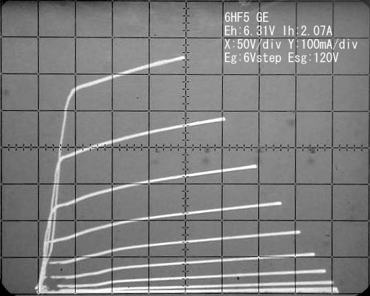

Davorin, thank you for the curves.
So if I am reading this one correctly, 3.3KΩ is not a good P-P load for these tubes. I'm seeing 2.5KΩ as the better choice when the plate is 500V. Anyone else agree with me on this?

So if I am reading this one correctly, 3.3KΩ is not a good P-P load for these tubes........Maybee 2,2-2,3 KOhm including SAG of PS.
That number sounded familiar so I used the SEARCH feature.
The 6HF5's met the red board in post #168. With 520 volts of B+, 150 volts on the screen, and a 3300 ohm load I got 125 WPC out of 6HF5's.
In post #218 I tested the same tubes with a 2500 ohm load. Power did not increase, distortion went up and redness appeared.

Rough estimate (no consideration of dist.) of power for a given loading in class B or AB (tube diss. limit and max current not considered) (and OT resistive loss not considered):
Vknee is plate voltage of knee for 0 V on g1 at the given screen voltage (top plate curve usually)
R is loading per OT side (so P-P Ohms is 4xR)
Watts = (B+ - Vknee)x(B+ -Vknee)/(2R)
You do have to check the tube dissipation then and current capability against the load line and also leave some safety margin on diss. Current required = Iknee = (B+ -Vknee)/R
so at 120V on g2 (from curves), Vknee is around 50 V, and with 500 V for B+, and 3300 P-P OT:
Watts = (500 - 50)(500-50)/(1650) => 122.7 Watts
Iknee required: 545 mA
and at 150 V on g2 Vknee is around 62.5 V [ 62.5V = (150V/120V)x50V) ], and with 520 V for B+, and 3300 P-P:
Watts = (520-62.5)(520-62.5)/1650 => 126.8 Watts (George got 125 W after OT losses)
Iknee required: 554 mA
Usually you want to increase the above Vknee a little (maybe 10 V) over the graph Vknee to avoid heavy screen grid heating if over driven, for safety.
A higher B+ and higher P-P Ohm OT will usually get you lower distortion. (again within the max tube limits and assuming such an OT is practical)
looking at davorin's graphs, this tube can produce large plate currents at Vg2 of 120 volts, which brings me to thinking, maybe this tube is another candidate for screen grid drive....
