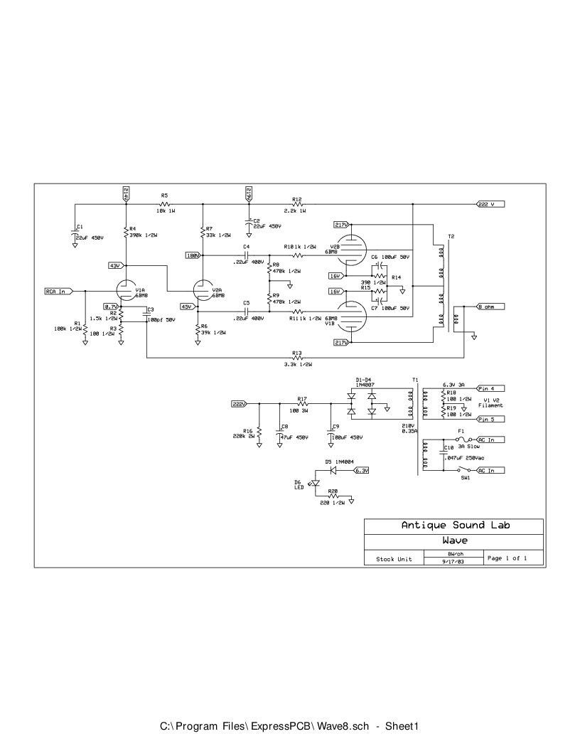

The ASL AV-8 circuit (schematic uploaded) is (IMO) a reasonable point of departure, for this project. Look at the topology, not the parts values and voltage specifications. The 12AT7/ECC81 should nicely take care of triode requirements. BTW, the AV-8 uses self, AKA cathode, biased O/P tubes. That's OK for pairs, but PPP needs close control of each tube's "idle" current. A 10 Ω resistor between each cathode and ground provides the necessary test points.

Hi Eli Duttman
thanks for schematic , i will look into that idea yes somewhere to start, no not guitar amp.

Keeping with the theme of doubled up gm, and using Jazbo's linked schematic, one could put a 6LQ8 in place of the 6JN8. (both cheap tubes) Should be quite linear with all the gm. Would have to check the microphonics of that front stage then.

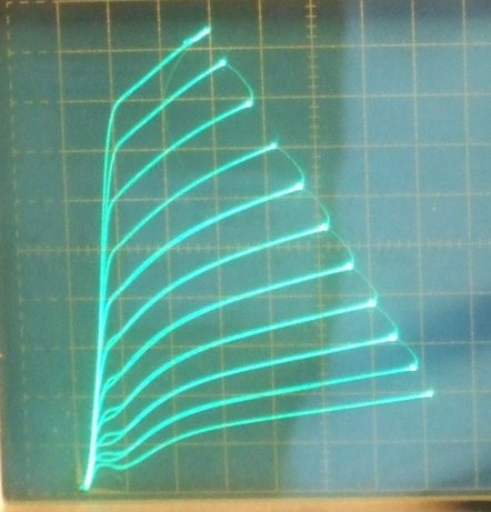

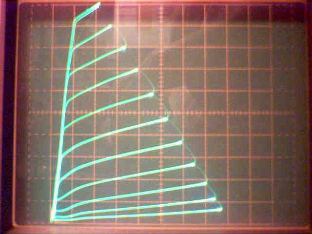

I traced several 6HA6's which is suppose to the same as 6HB6, and all of them had similar curves to the one that you posted, so at this point I have to conclude that the datasheets are somehow in-correct... Anyway, here is the plate characteristic with with 6k load line for your reference:

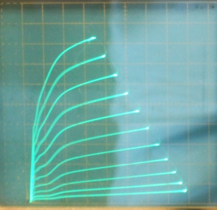

Most of the 6HB6 tubes here are RCA and GE, with a few Motorola and Raytheon and Westinghouse. Many are marked 6HA6/6HB6. I put an RCA and a GE 6HB6 (not likely the exact same ones) on the tracer again, and it looks like the 1st trace below is the RCA and the 2nd is the GE. (10 mA/div Vert, 50 V/div Horiz.)
Although I had to turn the g2 up to 150 V or push the g1 span well positive to get the max current up to the full screen. While the data recorded for the original GE curve says 100V on g2. So either an error made before or there is some significant spread in the characteristics of these. ( sometimes used as V regulator tubes, although the GE datasheet says Vertical deflection and Video amp.)

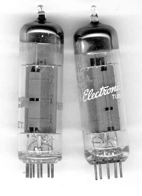

If you are referring to the rounded curve knees versus squared ones. Most all of the tubes I have looked at are square knee. However, I do have some RCA ones labeled 6HA6/6HB6 that have a smaller plate structure and are clearly pentodes. They are marked "GT BRITAIN". These DO have rounded knees.
Pics attached of the tube types. Left is the pentode version from GB, right is the more typical beam pentode version.

I looked at the Westinghouse 6HB6 here and it is a true pentode also, and it looks exactly like the RCA made in GB tube, except it says made in Japan!
Looking at the Motorola and Zenith tubes, exactly the same as the GE and RCA beam pentode tubes. Although some RCA tubes do not have the two narrow windows in the edge end of the plate.

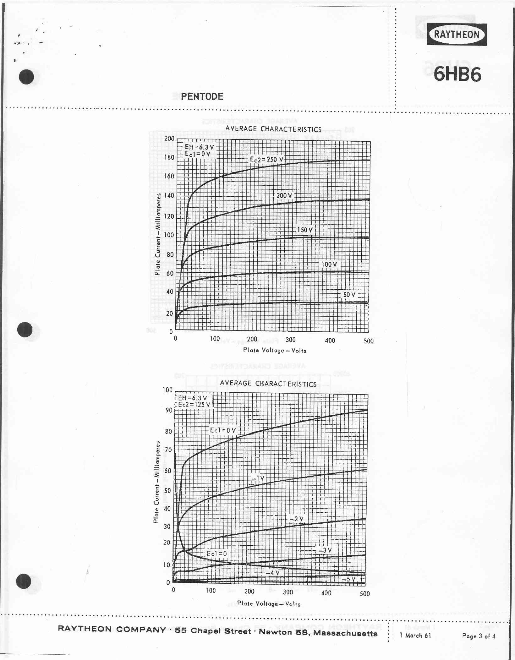

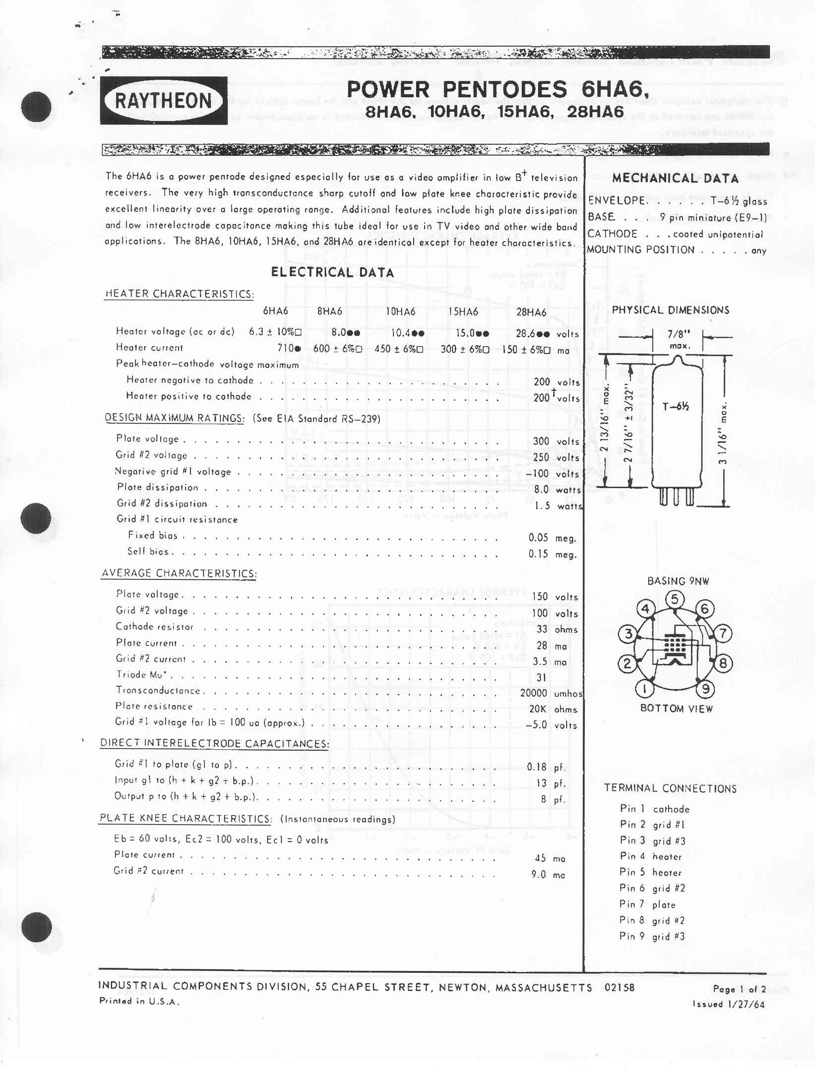

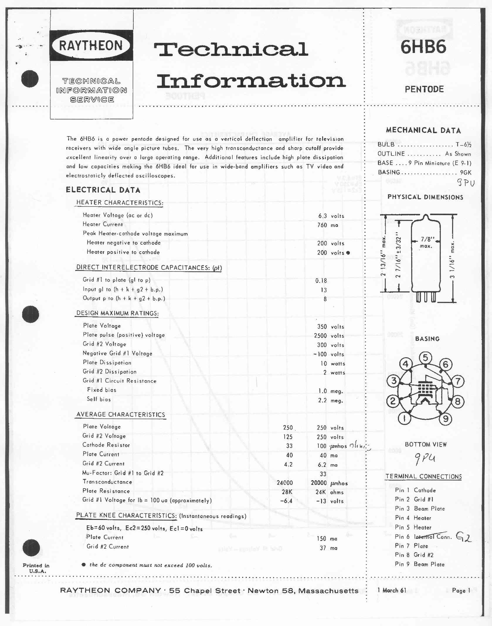

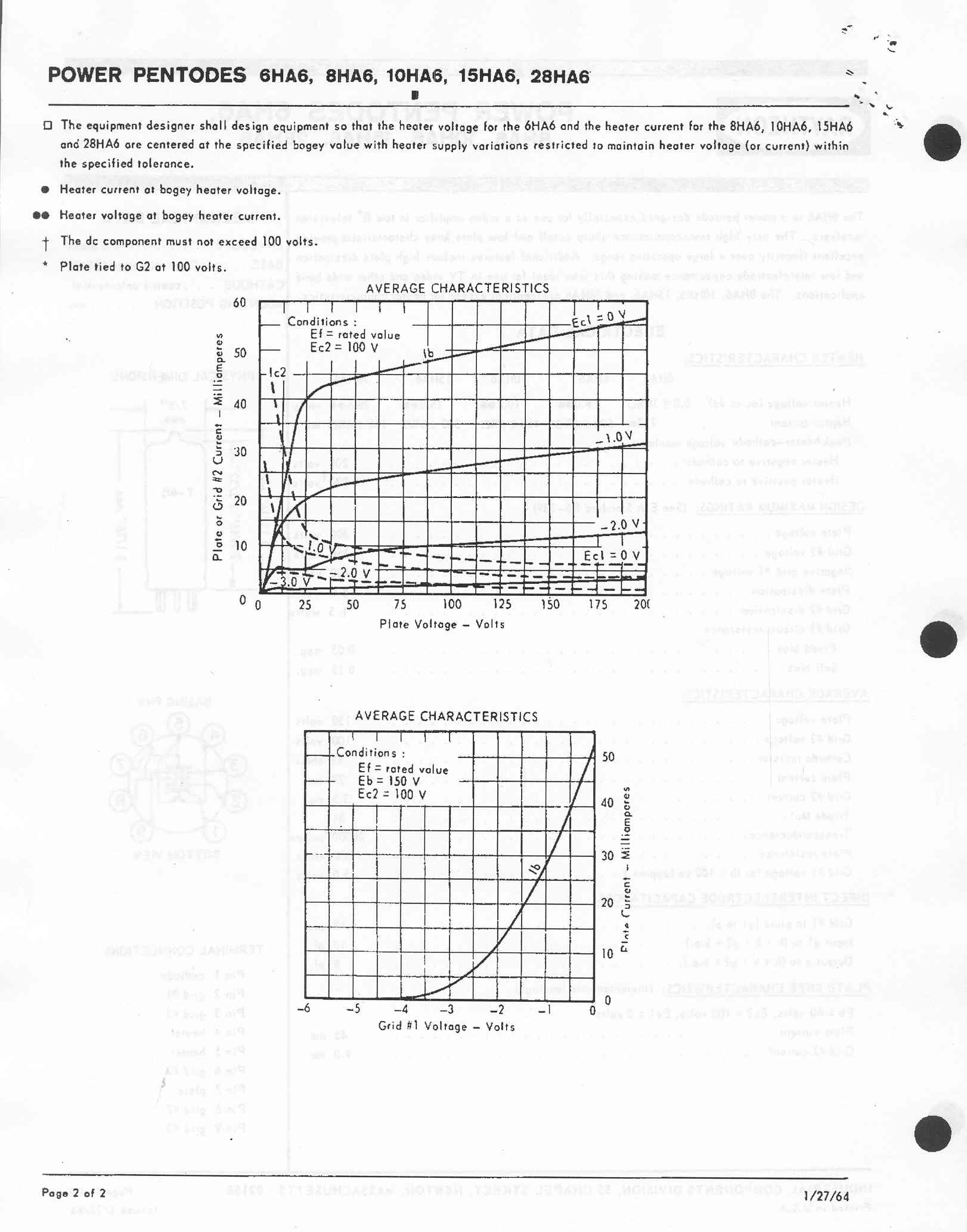

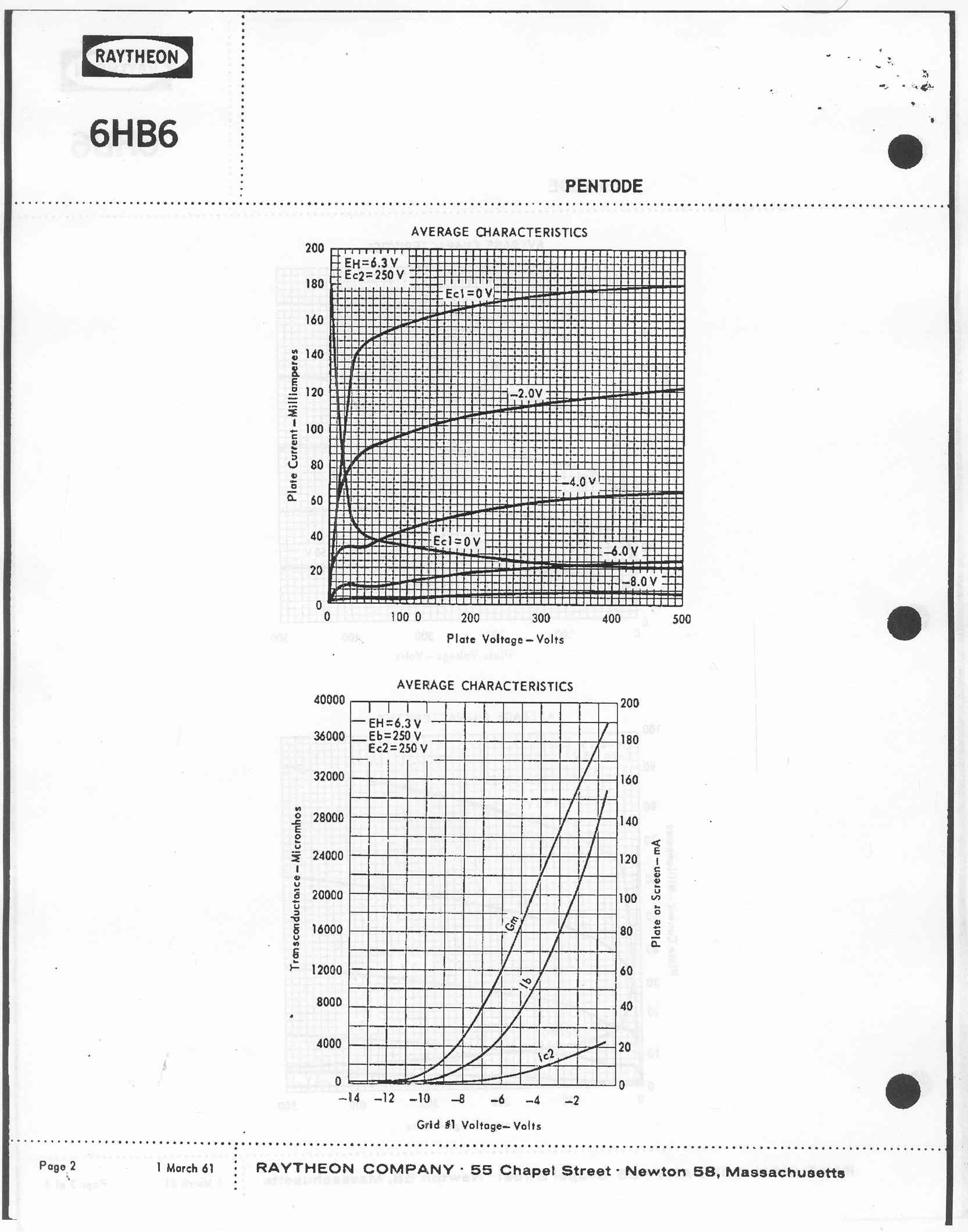

I think Raytheon eventually got out of the commercial tube line, mainly making military and radar tubes. So their later 6HB6 tubes may have been made by someone else. But Raytheon is registered as the design originator for the 6HB6 in 1961. They are also registered as the design originator of the 6HA6 in 1964. Somewhat odd that the up-rated tube came 1st.
Here are the original Raytheon datasheets for the 6HB6 and 6HA6.
It says its a power pentode with a sharp g1 cutoff.
The later 6HA6 datasheet adds that it has a low plate knee. It also drops the plate dissipation to 8 Watts. Obviously the 6HB6 already did too, with 10 Watts diss.
So that's how the plate curves are SUPPOSED to look for 6HB6/6HA6. Looks like RCA or GE came out with a beam re-design later, but never registered it separately.

Here are some plate curves for the RCA 6HB6 made in GB real pentode version. 10 mA/div Vert., 50 V/div Horiz., 170 Vg2
Doesn't look all that close to the Raytheon specs either. Good luck trying to get some matched tubes!
I just tried the Westinghouse real pentode version (made in Japan), and it has identical curves. Someone not telling the truth about mfg. origin.
Tube pics again. Left tube type (real pentode version) corresponds to the 1st curves shown. Right tube type (beam type) corresponds to the last curves shown.

Are there any etched codes on the GB version?
If they are made by Phillips/Mullard these codes can be used to find their euro designation.
Didn't Philips work with Matsushita in Japanese valve production? That could explain the similar construction.
