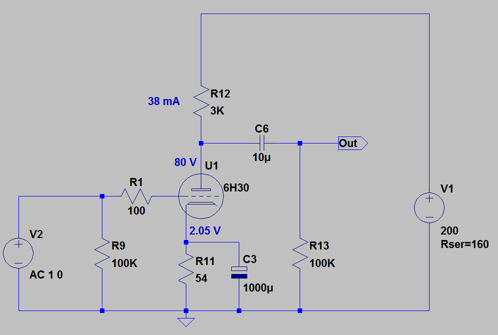

Thank you! I can find the tube data, but I wanted to see if anyone had a working schematic of this tube as the VA stage of their or a commercial amplifier. In my amp, I have:
Using a 28.8K plate resistor and 1.5K cathode resistor:
184V on the plate, and 11.7V on my cathodes.
I have never seen cathode voltage that high in a VA stage and wondered if it looked OK to run like this.

You are running 7.8mA for cathode current, which is well within the spec of the tube.
However, this is a low for best performance for this tube. Also your anode voltage is a too high. The two together will put you out of the most linear bias region.
I would suggest decreasing your cathode resistor significantly, to increase anode current and lower anode voltage.

Looking at the tube specs, it looks like I need to also decrease the plate resistor from almost 30k to around 6-10K and change my dropping resistor in my PS to lower the plate voltage.
You think 250-560 ohms for the cathode resistor?

I tinkered with it a bit by changing the dropping resistor, plate and cathode resistor.
Now, I have a B+ of around 150V
72V on the plates, and 3.45V on the cathodes.
Look better?

It was a single side. I ditched the 6H30. It acted very unstable and both that I have are fairly noisy. I had some wicked 120hz artifacts.
I swapped plate resistors, changed my cathode resistor, dropped a 6CG7 in and away went the noise and wobbly sine waves.
I got the 6H30s from a buddy, so god knows what they went through.

When I was using this tube I had to use little ferrite beads wrapped around the wires directly connected to the grid pins along with a 1k grid stopper before things settled down.

Did you build anything like post #8. Yeah, 38mA, with a 3k plate resistor would be ok. That would keep the output impedance nice and low.
I think the reason your 6N30P was behaving badly was that it's running with such low plate current. I really think it sounds best with at least 15mA plate current, per triode section. That gets it out of the "knee" in the plate curves.

Yes, regardless of how I swapped things according to various schematics for the tube, they were noticeably noisier than the 6CG7.
I have two, and one was worse than the other for noise. I really only used them because they were here. I'm not bent on using them really.
