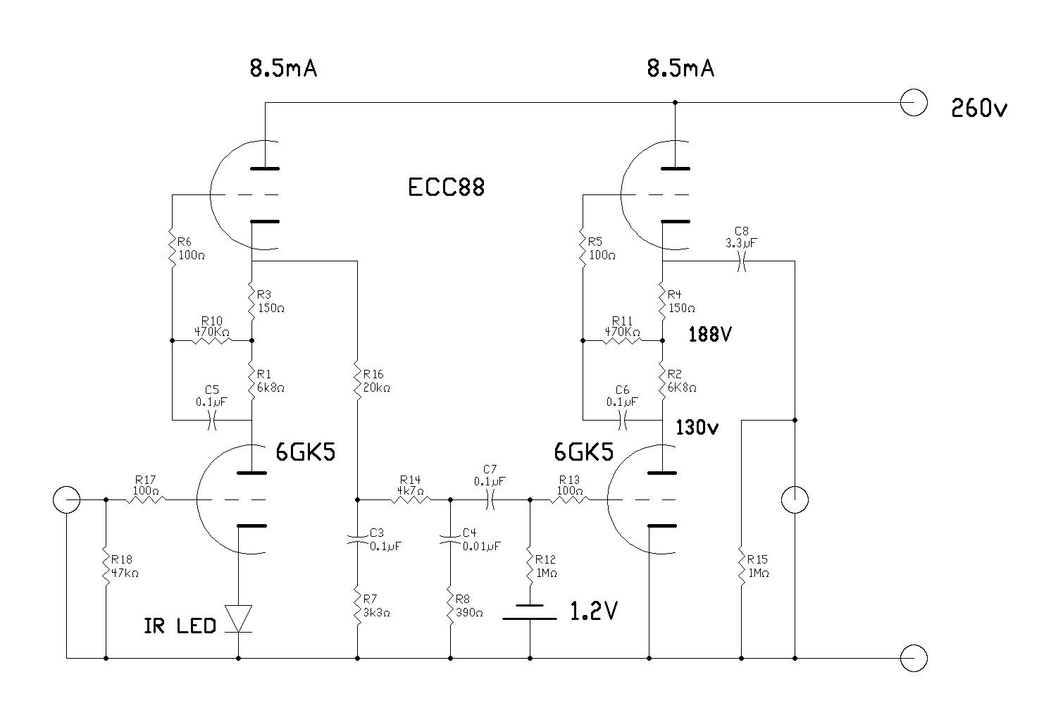

6gk5/ECC88 Phono any comments.
Posted this on the Analogue source forum, where it was suggested i move it here.
Looking for a similar phono stage to the Garry Pimm/Kurt strain design but all tube.
Ht voltage is limited to around 260V. So i have chosen to use an ECC88 as upper section of the mu follower.
Any comments or suggestions on this proposed circuit? Whats the noise performance of the 6Gk5 in the front end of a phono?
Cheers.
