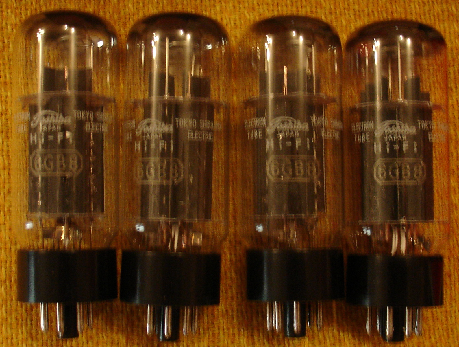

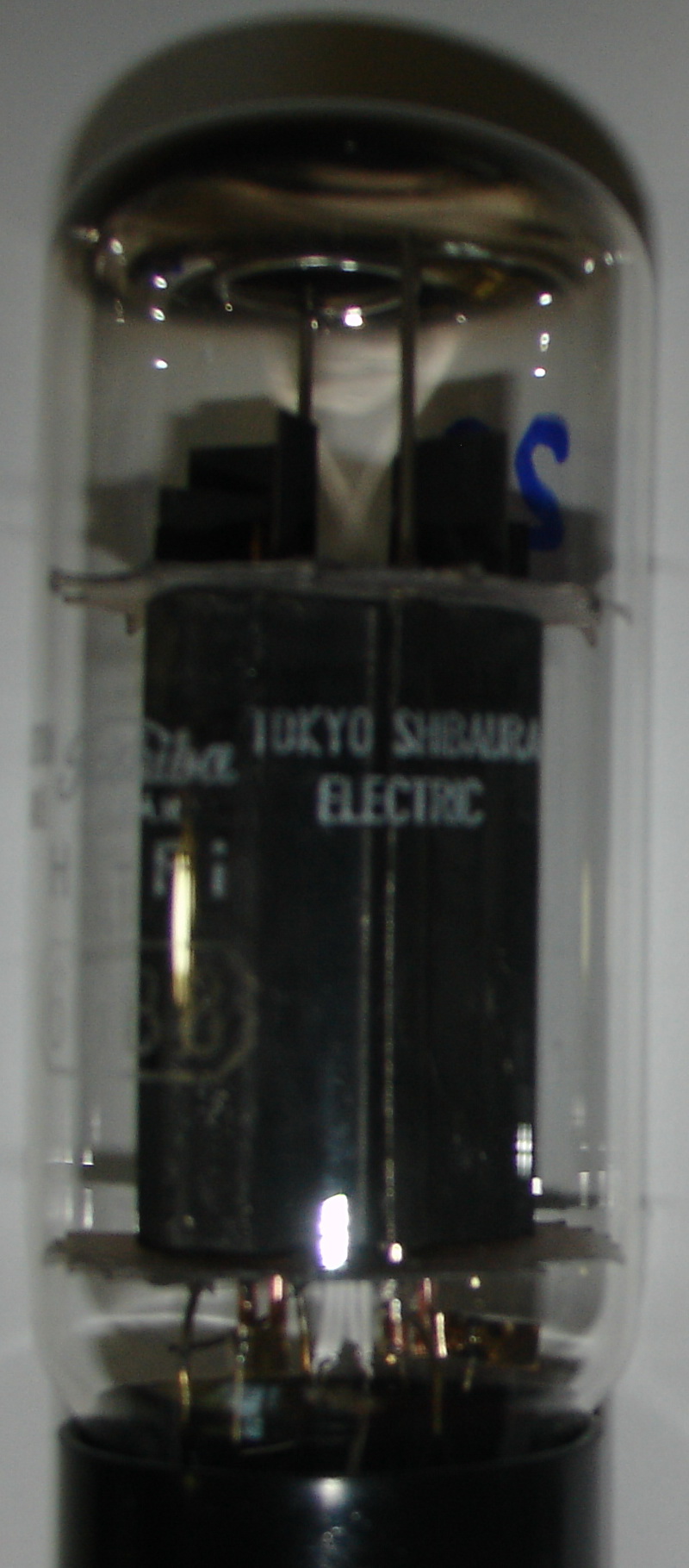

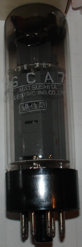

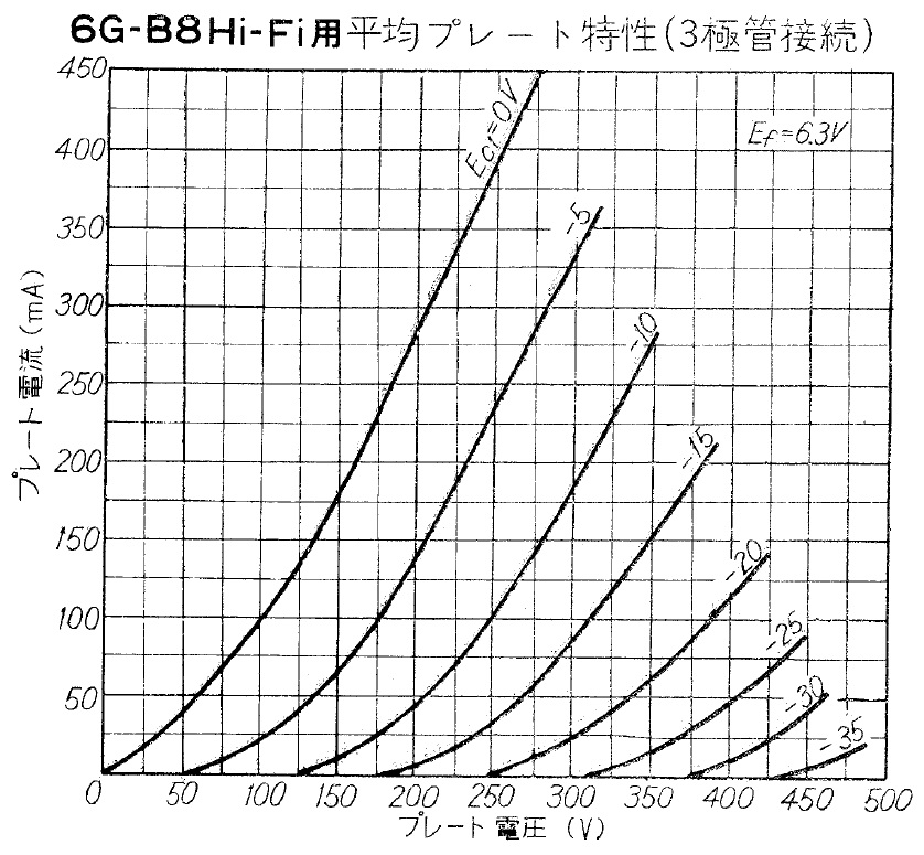

I have done some measurements of some tubes offered above.
Just take a chance to select the best quard.
Triode mode measurements
Heater voltage 6,4V DC
Heating-up period used is 1 min
Grid1 to Cathode voltage = 0
Grid2 connected to Plate via 50 Ohms
Plate voltage_1 = 140V
Plate voltage_2 = 149V
Corresponding plate currents are indicated
6G-B8 used tubes
No1 152mA 166mA
2 184 202
3 156 172
4 182 199
5 174 190
6 161 176
7 171 189
8 144 159
9 181 198
10 159 175
11 198 216
12 154 170
13 162 177
14 167 181
15 174 191
16 193 210
6CA7 NOS tubes
No1 166mA 179mA
2 158 170
3 158 170
4 160 172
5 161 173
6 136 144
That mean they are.... ? I didn't know the normal values in this, could you tell us?
Best Regards and thanks for your effort
These measurements proove that emission of the used 6GB8 is indistinguishible (in average) from emission of the NOS tubes. As per 6GB8 datasheet at triode mode (picture at the first post) Vg1=0 and plate voltage 140V one should have 165mA.
