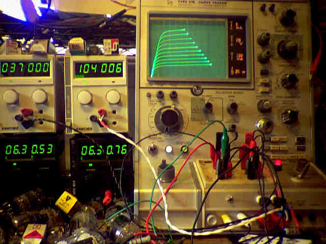

As I stated earlier I have seen a large tube to tube variation with these tubes. Looking at my collection some are marked 6EA7 some are 6EM7 and most are 6EA7/6EM7. Maybe it didn't make much difference in a TV set, but there seems to be two or more different tubes being sold as 6EA7/6EM7. There are three different constructions of the tubes marked with both numbers. The ones with the wide flat plates for the big section seem to have more bass, but they red plate easier than the other flavors when pushed hard.
I tried a couple of Sylvania 13GF7 and 13FM7 in the curve tracer, and they are definately the same tube. They both look the same, all black plates, the big flat plate on section #2. Only difference is that the 13GF7 has a little cooler fin atop g1 of section #1.
Then I looked thru some other brands, and after only 12 tubes out, I see 3 different constructions of each type too. All the others had no cooler fin on section #1 g1 (but small or large cooler fins on section #2 g1 on all). The GE and RCA usually have grey plates, but one RCA has black plates (Sylvania black plated). Section #2 is sometimes a big flat plate (Sylvania, RCA, Zenith) and sometimes a rectangle at 90 degrees in the middle (GE). Section #1 is usually a rectangular box, but some have flat fins out the narrow ends.
The most significant difference I see is that section #1 sometimes has a round cathode (Zenith, GE) and others have a flat cathode (Sylvania, RCA). Usually this means different curves, but I put one of each on the curve tracer and the same curves still, but a DC bias difference. With only 12 tubes out so far, looks like construction was a free for all with these tubes. But the curves were remarkably similar on the few I have tried (only tried 4 on the tracer).
I bought a box of 156 of the 13FM7 type when VT.net had the box sale, something like $0.35 each. Probably got every brand possible here. Lets see, Dumont, Tung-Sol, Philco, Raytheon, International, PhilipsECG, Zenith, RCA, GE, Sylvania, Lindal, Westinghouse, Amperex, El Menco, Canadian Marconi, Admiral, Sears, Silvertone. Am I missing any? And that was just the 13FM7 box.
"But "tracer" not heard of this before."
A Tektronix Type 576 Curve Tracer modified for tube tracing.
