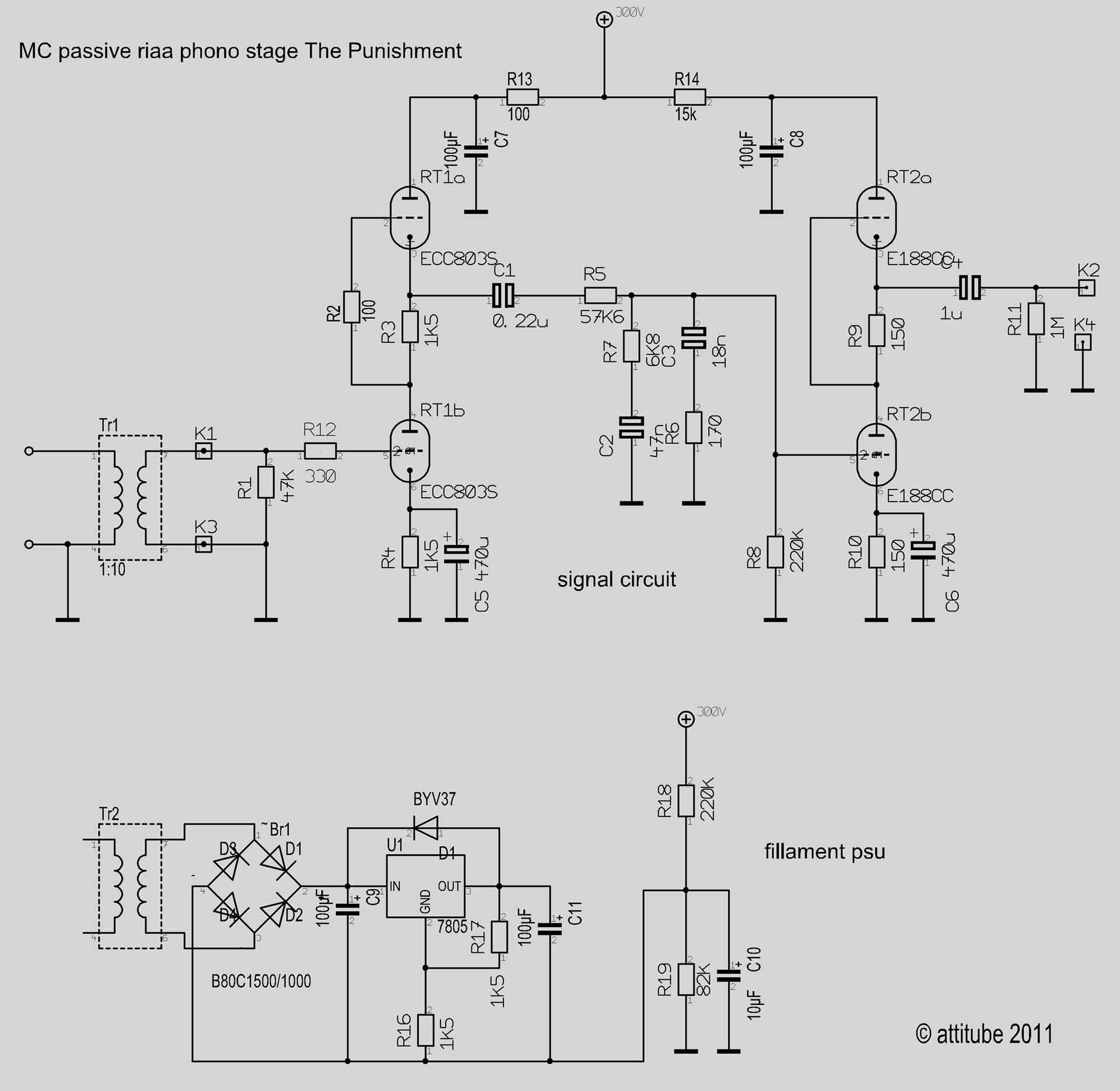

6dj8 phono pre to 12au7 pre hum
I am having an issue when connecting my 6dj8 phono preamp to my 12au7 preamp. The audio coming from the speakers (nothing playing) sounds almost like a ground loop.
The phono pre is all DC and in a shielded box with the power coming through an umbilical.
Using the phono preamp with my 6v6 integrated amp there is no issue at all.
Things that I have tried thus far:
1) changed the cables from the phono pre to the preamp
2) Moved the phono pre to a different location in my stand
3) connected the ground from the phono pre to the ground on my preamp
4) inspected the phono preamp for a bad ground.
5) with nothing hooked to the phono preamp, I looked at the output on my scope. Nothing there (no noise output)
The preamp will work fine when I have my cd player connected. No distorted noise at all. When I connect my phono preamp and power it up, that is when I hear the hum/noise and at a pretty high level. Not even playing an album at this point, just have it connected and turned on.

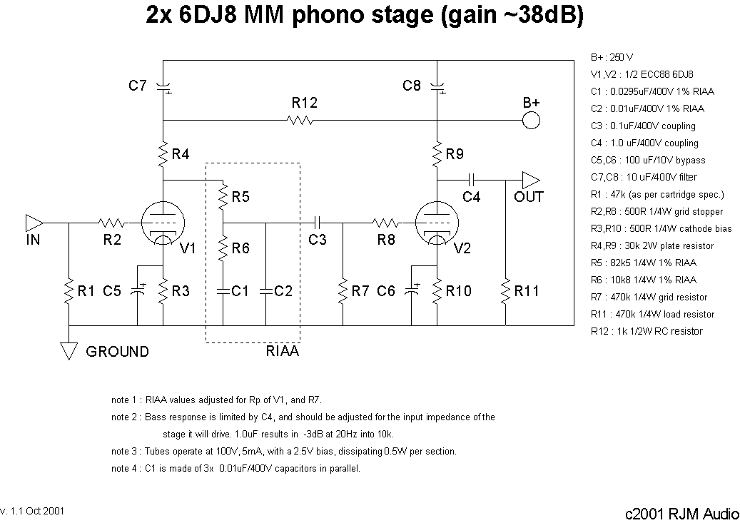

Could this be an impedance matching issue with this preamp? I have attached the schematics of both.

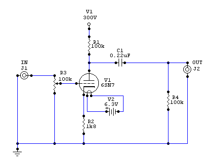

This is actually the preamp that I use on my 6v6 pp amp and have no issues with the phono pre....
I guess I could go that route again until I build the Pete Millet low mu preamp (parts on the way), but for now this problem has me stumped so it's more of a curiosity thing thats bugging me to figure it out.

I did build a new preamp yesterday. A 6sn7 srpp which sounds very nice. It didn't help with the hum/buzz coming from the phono preamp, so I've eliminated the following from the equation:
1) cables - I have tried several and there was no difference.
2) the preamp - I have used two different preamps and no change
3) the turntable - shorting the input to the phono pre made no change

Problem solved.....
Both stocktrader and koonw set me on the right train of though. I built the phono pre about a year ago or so. I was sitting here thinking.... ground loop.... dc heaters.... then it hit me. Did I connect the negative from the tube heater supply to the HT ground? Turns out that I did not. I heated up my soldering iron and made the connection. No more buzz.
I am guessing that since the preamp that I am using on my SET has more gain than my single stage 6sn7 on my integrated amp, the issue became more apparent, which is why I thought everything was just hunky dory before.
