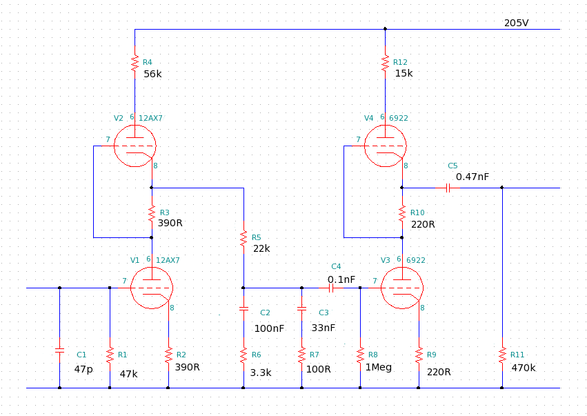

If you want to stack tubes like that, pay much attention to the heater supply- it will need to be biased positively in order to not exceed heater-to-cathode voltage limits.
I haven't run the numbers, but I'd wild-***-guess that the gain will be too low and the distortion will be too high. It will not follow RIAA very well. I have no idea what the function of the plate resistors is.
Have you read carefully the section on phono stage design in Morgan Jones's "Valve Amplifiers"? If not, I strongly recommend it.
or have idea to improve it, please, let me know.
12AX7 lends 5.63 nVrtHz of noise, R2 further lends 2.5nVrtHz of noise to your input stage. To picture it, a 5534 OPAMP has 3.5nVrtHz @ 1kHz spec. If its for an MM level cart, try to keep it 40dB gain max, maybe by a second stage tube of less mu so the total gain will not be excessive, thus to end up with no stronger presence of hiss than strictly necessary at the output.
P.S. Allocate as much gain and linearity as possible to the first stage.
I would remove the anode resistors. 12AX7 is a guitar tube for those preferring soft tubey sound. I prefer 6DJ8/E88CC overall. Put a 100R resistor at the grids directly on the socket for preventing oscillation. I have a similar phono preamp, but 3 stages (the passive eq is splitted).Now I have almost finished diagram. It is mostly guess work. If anybody see mistakes or have idea to improve it, please, let me know. Preferably before I put it together.
