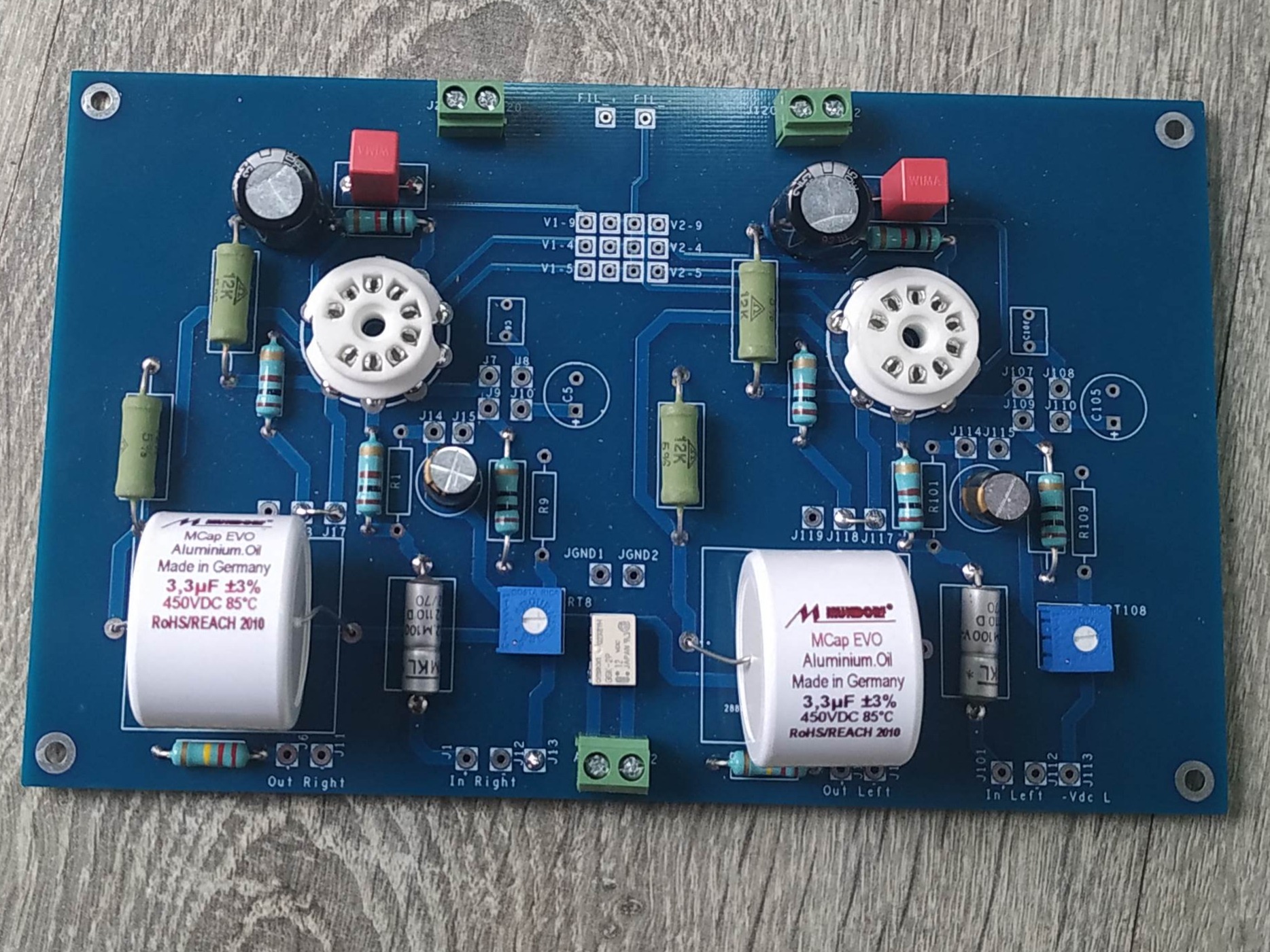

This is what I do time ago

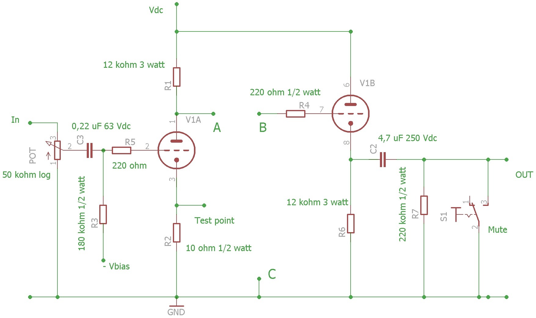

It is a line preamp with some tubes ( matrxi of filaments) included Ecc88

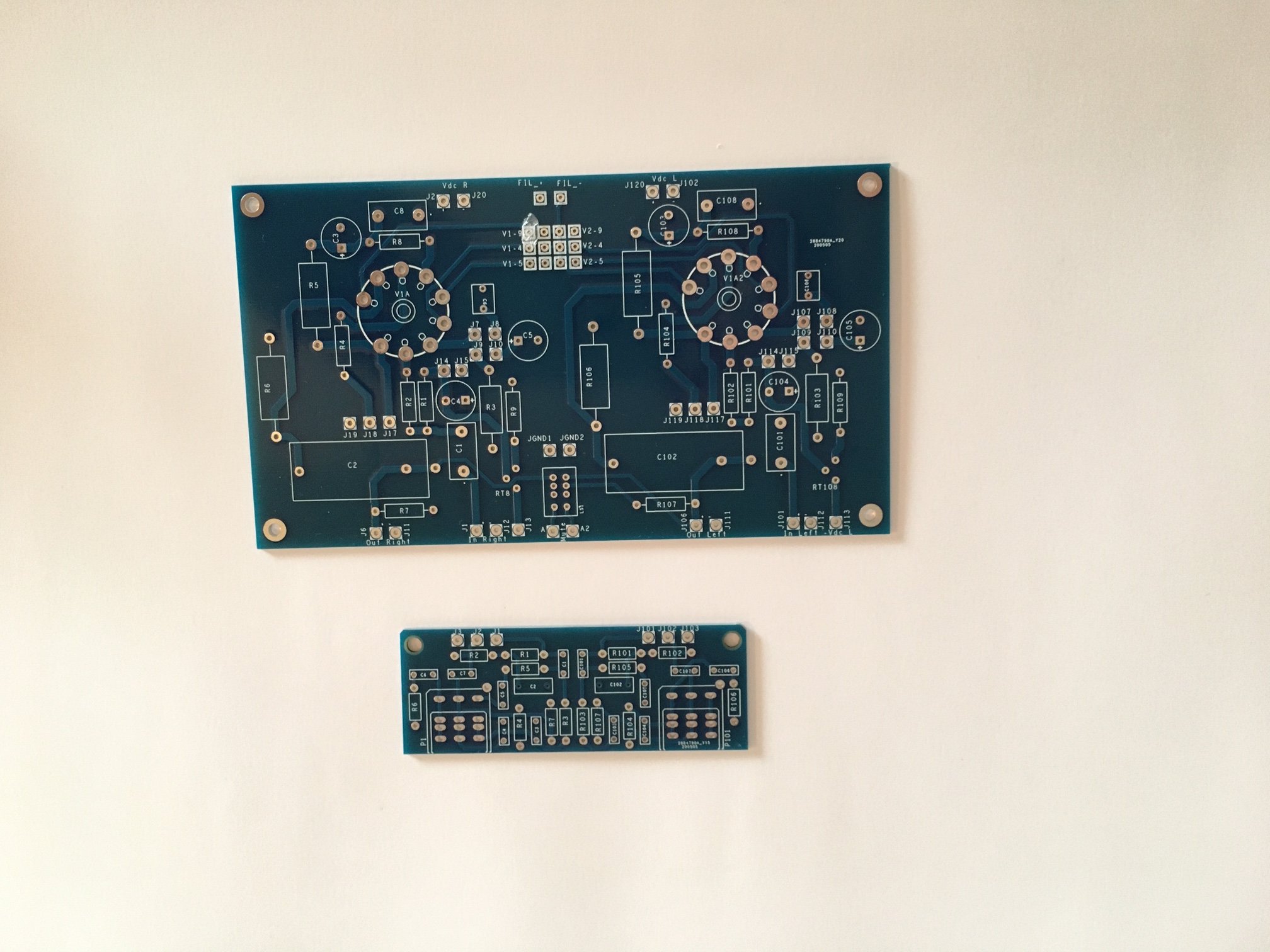

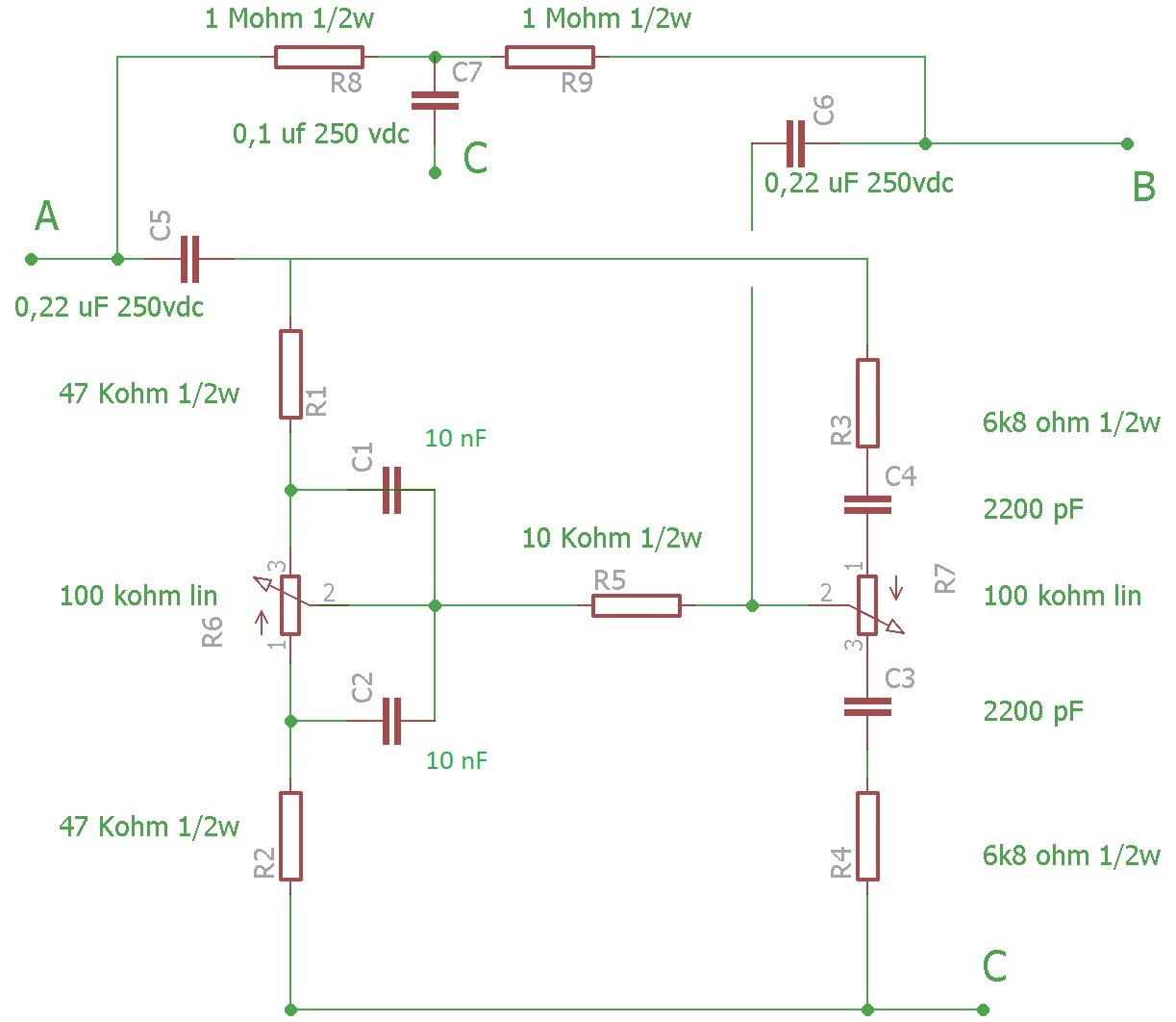

And the possibility to insert the tone control ( alittle pcb) , it is passive.

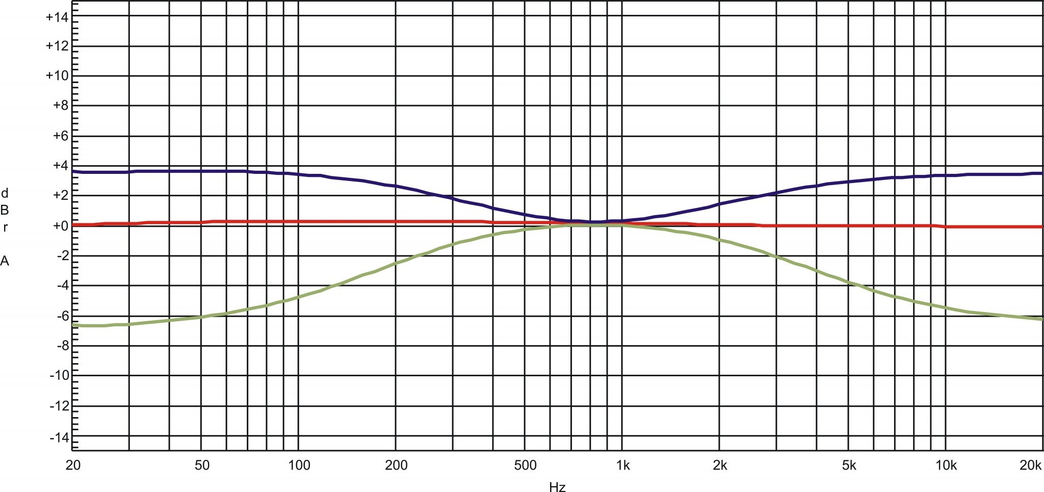

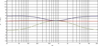

Then the response of tone.
The difference on gain with or witout 6-7 dB
Walter

I have published the project on Audioreview magazine in Italy; it is easy but running fine
The presentation was done after hours of listening session where the people appreciate the final results also the "limited" excursion of tones.
I agree with you that is not necessary, in this era, the use of +/- 20 dB of excursion.
The insertion of the pcb of tones is easy and the lab test show that in the center of the course of tone control the frequency answer is perfectly flat with THD same as before.
The Zout of the first stage is reasonble low to allow the insertion on tones without any issue. The little network, two resistors (1 Mohm) + one cap, is a smart way to fix the working point of the CF
Walter
