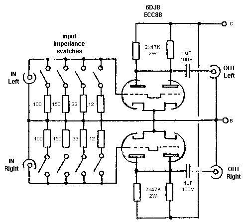

I've been looking at many tubed circuits for an MC cartridge.
The 6DJ8/6922 seems to be used by some.
I was wondering if the 6922 can be used without any cathode resistor. Only one resistor from anode to supply ( say 68K ) and one resistor from grid to ground ( say 2 K ).
It seems to work in a simulation but is this a meaningful configuration for an MC input ( max input say 20mV on severe peaks )? I remember seeing some tubes with no cathode resistor somewhere on the web. A zero volt grid bias works for some situations in some tubes. Since MC signals are very low and I assumed they may work in the linear region for low negative swings at the grid , typically less than 2mV max for a cartridge sensitivity of 0.2mV @5cm/sec .
Any opinions?
Cheers.
No problem, it works fine and the ECC88/6DJ8 family is relatively linear with Vg=0.
Please note that all tubes need to be selected for low noise.
Here's one that I use on a daily basis:
Cheers,😉

Use a searching engine - tipe 6922 or mc-hamer if I recal corectly. You will find two almost same designs of mc step up signal circuit. Hampton mc using 84 reg. DC voltage, or another by Frank using ccs PS. Grid to ground should be 10-150 ohm (cartridge ?), anode res. depending on PSU typ (paralel 2x 47kOhm in Hampton). No cathode resistors on boath.

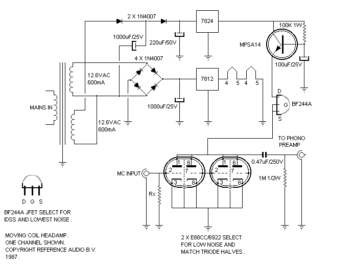

I remember Hugh saying that he prefered the sound of a resistor load to a CCS load. Am I right ?
Perhaps he said so in general, but here it's essential to have very high PSRR.
Any CCD or JFET having an Idss of 1mA should do as well.
The BF244As I select as well for equal current and low noise.
I never use any PCBs as I feel the can degrade the sound.
Moreover, by using P2P it leaves me room to fool around with the coupling cap and loadresistor for instance.
Marjan built the Hampton MC which should be a fine cct for all but the lowest output MCs.
Cheers,😉
Yes, Ashok,
I did say that! Different sonics......
I've tried both and much prefer resistive loading.

Nice circuit, Frank! :devilr:
Hugh
Thank you very much, Hugh.
Odd as it may seem, in the context of my all tubed gear, this CCSed part sounds the most tubey of all when heard in isolation.
Something I don't quite understand but seems to negate the tendency of most MCs towards a rising top end nicely.
Why it sounds like this, especially with a tube that can veer towards stridency like some ECC88s can is beyond me though.
Thanks to the CCS it also gets away with the seemingly rather poor PS whereas the phono stage proper is tightly regulated and has tremendous dynamic range .
So much so that it puts any CDP based system to shame.
Mind you, this circuit is obviously sensitive to layout which is one more reason I'd recmmend P2P here.
Certainly the Hampton is a candidate for improvement too as I think it was originally designed as a mike preamp service?
Again, thank you for the compliment.
I just hope many vinyl addicts will build and enjoy it.
Cheers,😉

What kind of voltage do you normally see on the plates?
In my design, if you can call it mine, 24 to 40 VDC can be had at Vg0 for the ECC88/6DJ8.
What's the actual gain when loaded down by the ubiquitous 47K input resistor in the following MM stage?
Around and about 20dB depending.Why?
You don't need to care about that 47K resistor anyway...
Parallel tubes are the only way to go in this type of topology.
Yes, which is why I insist on matching up to the moon, not just the tubes but the CCSs as well.
There's little point otherwise....
Cheers,😉

From the schematic, it looks like there will be 22V on the plate, maybe a skootch less.
I measure 23 to 24VDC after the CCS, the B+ is 24VDC.
