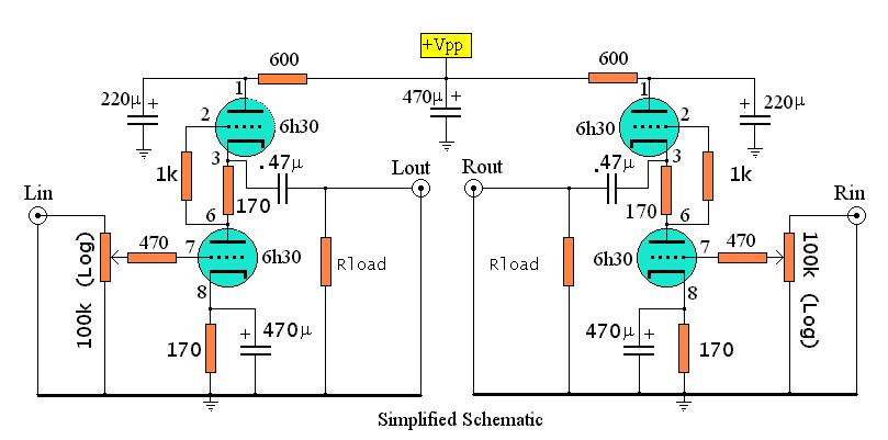

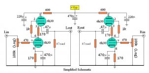

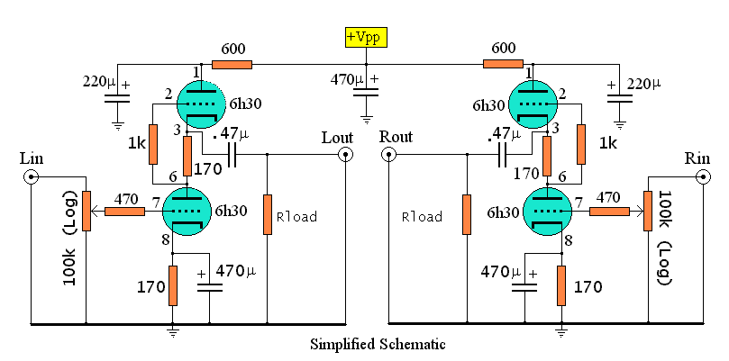

6DJ8 (balanced) tube line stage
Hello
These line stage can be used as a balanced line stage to drive amplifier like Aleph X etc ..
Any idea ,advise welcome .😛
Greets gabor
