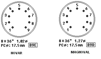

Well...That turns out to be quite correct anyway....Dang #@!!! I should have known.
The 6CJ3 being a n American type it's not likely to be a magnoval pinout but NOVAR.
I had second thoughts aleady but Duncan amps wrongly describe it as magnoval.
NOVAL are the small 9 pinner such as 12AX7A/ECC83 etc.
Magnoval or big noval is used by the 6KG6/EL509 (mostly TV tubes)
Novar was also used by TV tubes, often dissimilar triodes etc.
Both NOVAR and Magnoval are quite similar in size but not at all interchangeable...
When forced into the wrong socket reliability problems may crop up.
Here's a picture of both side by side:

The GE 6CJ3 data sheet didn't help - it says
Base - E9-89, Button 9-pin
and under the basing diagram
EIA 9HP
Hah!
The sockets I found I had bought many years ago - for PL509s
Brian.
