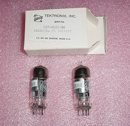

Eli Duttman said:
The "best" 12BY7s in a "Duece" are RCA in the voltage gain positions and GE JAN in the splitter positions. .
I tend to agree with Eli since I've used them all. (well almost all) These are the best I've ever found. They're curve tracer matched and selected by Tek. If you ever find any, they're well worth the price for the diff. pair.
Victor
