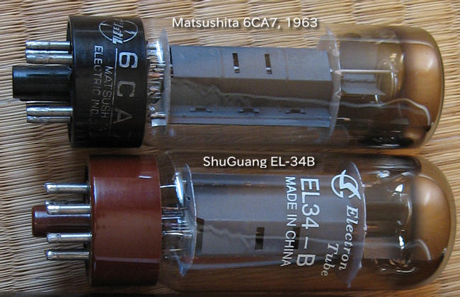

in theory the 6CA7 is the american designation of the EL34 and they are equivalents. However the 6CA7 is a beam tetrode while the El34 is a true pentode.
I'm sure there are various pentodes labeled 6CA7 and beam-tetrodes labeled as EL34 - so its not a rule set in stone! There have been so many variations of the EL34 made through the years.

The 6CA7 is an electrically equivalent beam tetrode to the pentode EL34 as was posted earlier. However, since 1988 when I started in tubes, I have never seen one "mislabeled" and as such assume that these tube follow their proper construction technique of 6CA7 = beam tetrode and EL34 = true pentode. It also seems that a 6CA7 has a larger envelope, but I do not think the plate dissipation is increased. Check your manufacturers specs to be sure.

Recently I purchased a pair of EL-34B made by ShuGuang in China when I visited ShangHai in last December.
The attached photo show a comparison to Matsushita's 6CA7
which I purchased in 1963 when I was a high school student.
Matsushita had technical joint from Philips, Holland at that time. Therefore the construction of Matsushita's 6CA7 in the photo is considered to be the same as the original Philips'.
I confirm that two tubes in the photo are manufactured as pentode and both tubes' constructions are nearly equal each other.
'73 de JA2DHC
