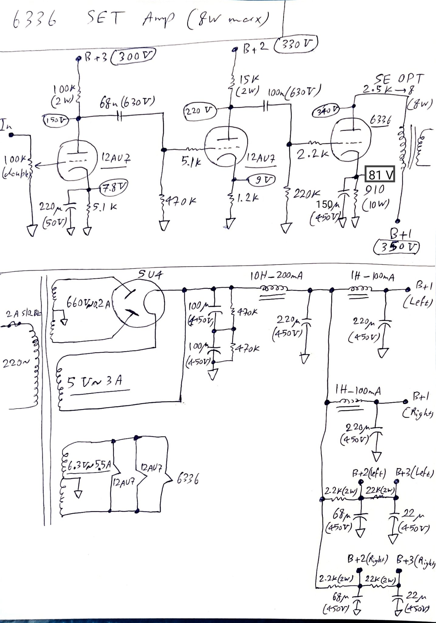

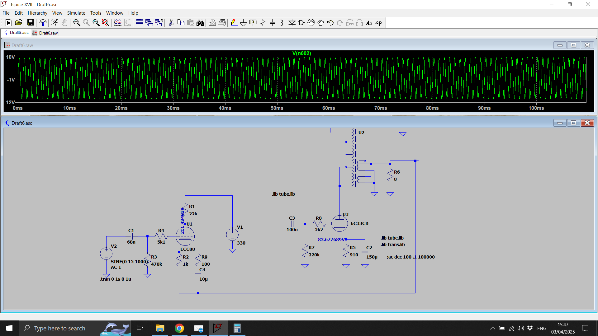

Greetings Friends. I've been fascinated by the 6C33C since I first laid eyes on it, and I've been kicking around an idea for a simple SET amp featuring the triple nipple. Borrowing the driver (and schematics) from the 6336 SET Amp by @Suncalc this amp uses cathode bias and the high voltage swing driver to make ~15 watts of Class A power.
Edcor's CXSE25-600 is a 25-watt OPT with a 600 ohm Primary and 8 ohm Secondary. According to my dummy math, 360v to the OPT will give a Va-k of 250v and a Vk of 88v, with a 400 ohm Kr.
Eliminated the volume control from the input, replaced with a 250k resistor.
Grid Leak Resistor for the output stage changed to 200k. Grid Stopper necessary?
Not sure how to calculate the K bypass cap.
Surprisingly the Hammond 372JX provides all the power needed. The output stage's cathode resistor eats so much b+ that there's no problem getting the 300v for the driver stage.
Enough capacitance for such a large current draw?
Better to take the driver stage power from before or after the 2nd choke?
Thoughts?
thanks for taking a look!

Are you sure that resistance of the OPT's primary winding is 400?! If so, I'm not sure this transformer is suitable for that high of power and low of impedance!
Another thing is that 12AU7 driver; I've built the 6336 amp and that drive wasn't able to provide enough current for grid of 6336 triode, so I guess 6C33C would be the same and it will cause HF roll off.
However, I did some changes to the original schematic and was able to improve hi F with biasing the driver stage hotter. Surprisingly distortion and performance got better too:

Oh sorry my bad! I thought you were talking about OPT. The OPT seems to be okay, but running 250V Va is the absolute maximum for 6C33C.
About the driver, I think you should experiment with different ones. first start with the original schematic then use my version, and if it is still lacking high end you should use another triode, or maybe a triode strapped pentode like EL84.
I tend to agree putting more current through the second stage will help overcoming the miller cap of the 6c33. The gain of the tube is low so miller is not such a big problem. You have about 50pF max to drive so that's 63K max impedance from the driver (-3dB @ 50KHz) - well within a 12au7. So sticking with a 12AU7 is fine as in #3. The triode mode offers reasonable damping factor on the speaker without NFB, and you could apply GNFB easily to the circuit if you so wished.

These super low mu output valve designs trade off OPT performance (lower turns ratio and lower impedances both scale to better OPT performance) in return for greater drive voltage requirements. Your post #1 schematic needs a nominal 175 Volts peak-to-peak drive to the output valve grids, linearly, and that's where your effort must be applied. Miller C is low (mu of 2 or something), so a reasonably high impedance, allowing for output valve grid leak resistance, driver can work. Goes without saying that 300 VDC B+ isn't enough for a linear 175 Vp-p, so a higher supply voltage is the starting point.
Yeah, they didn't do that in the 1950s. They also didn't try to use regulator pass valves as outputs. The whole amplifier design rests in the driver.

That was my issue Chris I actually needed a higher supply voltage for the driver. Otherwise grid voltage would never reach 0V on certain tubes limiting the output power. I needed 250V peak-to-peak, but my 6c33 HT was 310V and they were biased cold (fixed bias) at -125V or so. The drivers needed 380V.
I once tried a EL84 triode strapped as the driver, loaded with anode feed choke and around 250V B+ for both 6C33C and EL84. The performance was so bad, and THD was around 10% at only 6W!
Then I changed the choke with a mosfet gyrator and it did help a lot, but I didn't like the sound and gave up on 6C33C SE once for all!
I'm trying to encourage folk who want to explore these super low mu valves to shift their design emphasis from the output stage, relatively trivial, to the driving stage. This is the same issue that folk face in McIntosh and Circlotron designs, which also have a gain of 2, and need the same or similar solutions.
Just because commercial designs of the Golden Age (Praise God!) used driver B+ supplies derived from the output valves' supply doesn't mean we have to do the same. This is DIY audio, and the emphasis is really on the Y. A second, higher voltage but lower current, power supply is trivial these days, and gives other benefits of isolation, yada yada. Choose life! (Sorry; reference Trainspotting opening monologue)

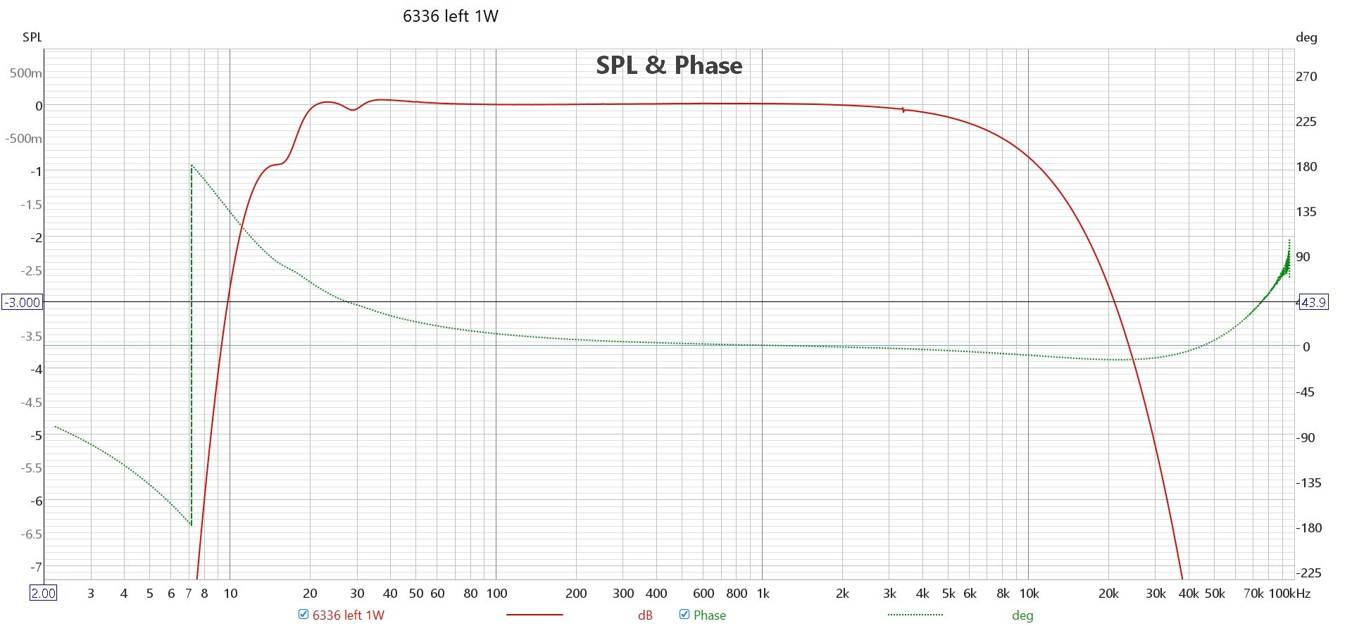

The driver which I posted in #3 is able to provide 180V p-p for the output tube and its output impedance is around 10k. It works perfect for 6336 triode, but I don't know if it suits 6C33C.

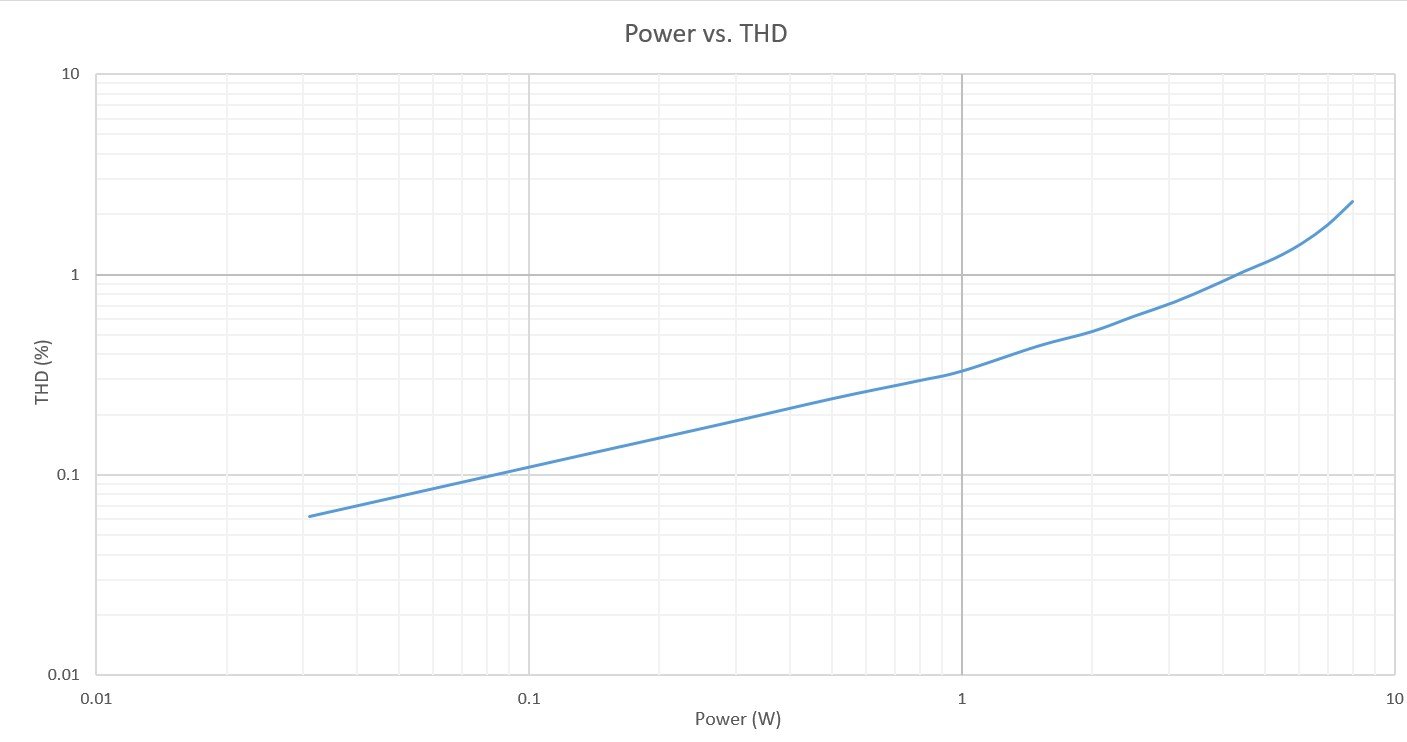

The funny thing is the distortion, at first I built the 6336 using #1 driver and hi F roll off was a little too much, here is the frequency response and THD:

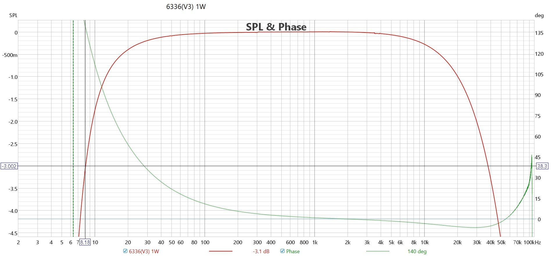

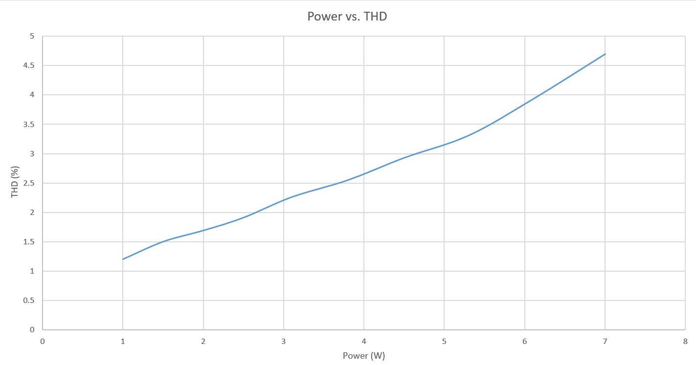

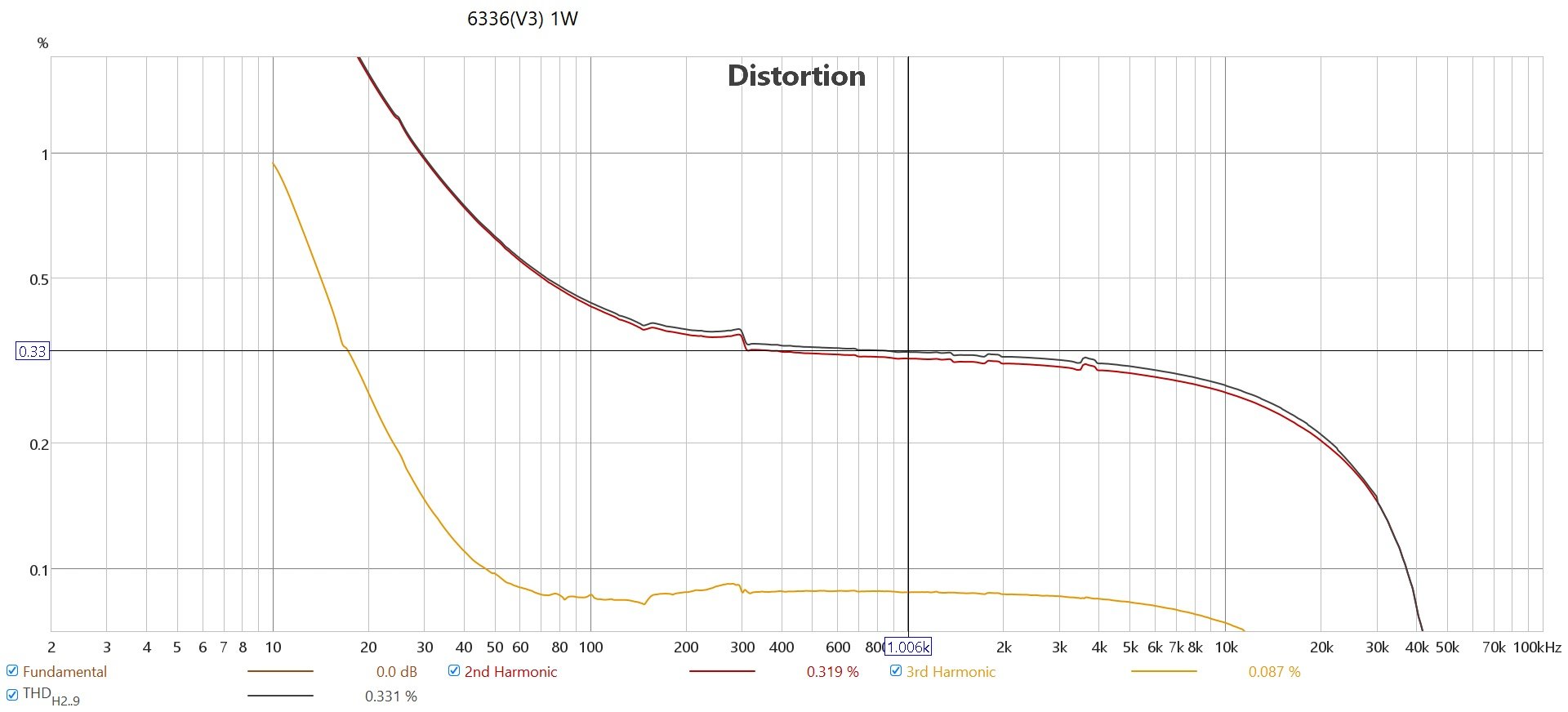

Then I changed the second 12AU7 bias point according to #3 and here is the results:
I still don't understand how THD got lower?! Because I was expecting more distortion due to second stage 15k anode resistor instead of the original 100k.
