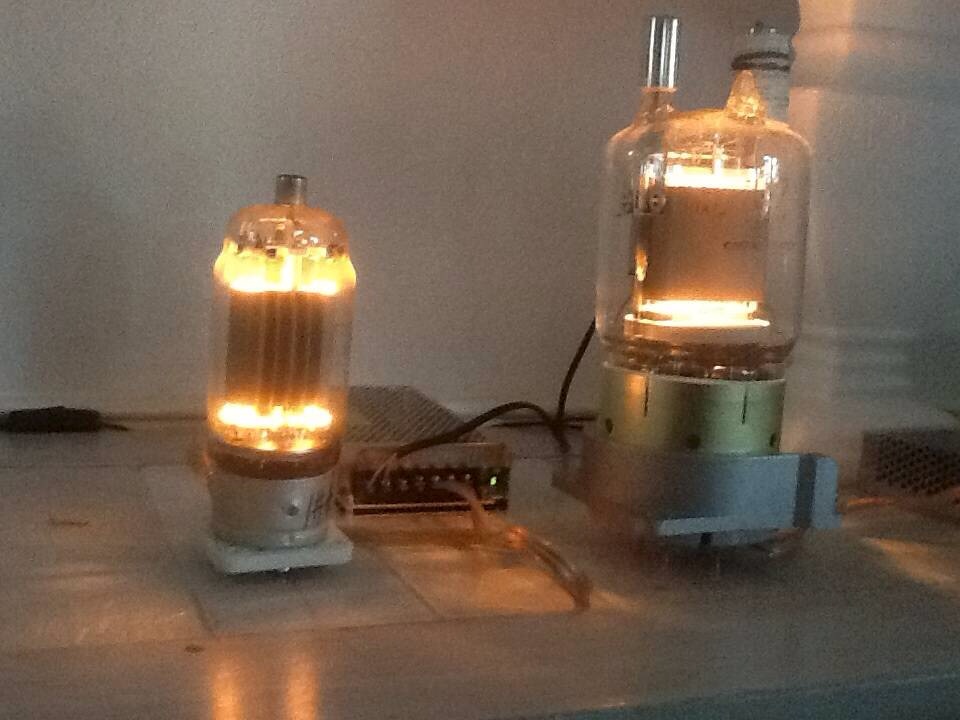

I use also smps for my GU81m heater supply. Just ad NTC resistor with the right value in series with the heater supply.
