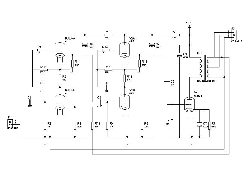

Hopefully this will work, Ive attached the CCT diagram of my little project
See what you guys think!--(Dont be too hard on me, its my first actual build of a valve amp!)
My choice of valves was based on what I had around--My original plan was to make an OTL based on the Allan Kimmel Monoblock, but subbing the EL509's for 6C33, with a few mods
Thought Id better do a fairly straightforward SET before building that one!
Ive built this on breadboard and considering I havent got a proper O/P Tx, sounds quite good.Hope to wind the TX next week.
