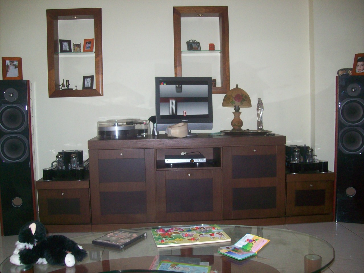

Nice design, altough the picture is a little unclear.

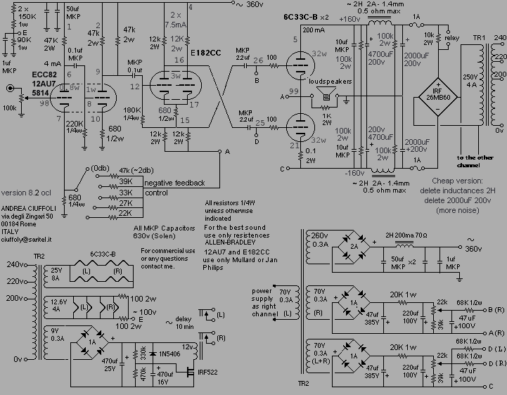

I can see that you use a small tube (ECC83 ?) and a larger one (12BH7 or 6N6P ?) in front of the 2 6C33C-B's. Maybe Andrea Ciuffoli's design ?
Could you share more pictures and some information about your OTL's ?

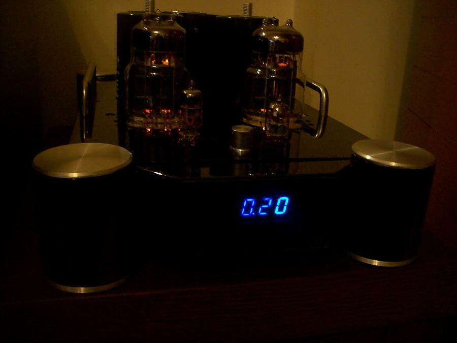

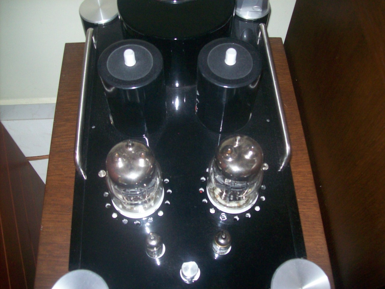

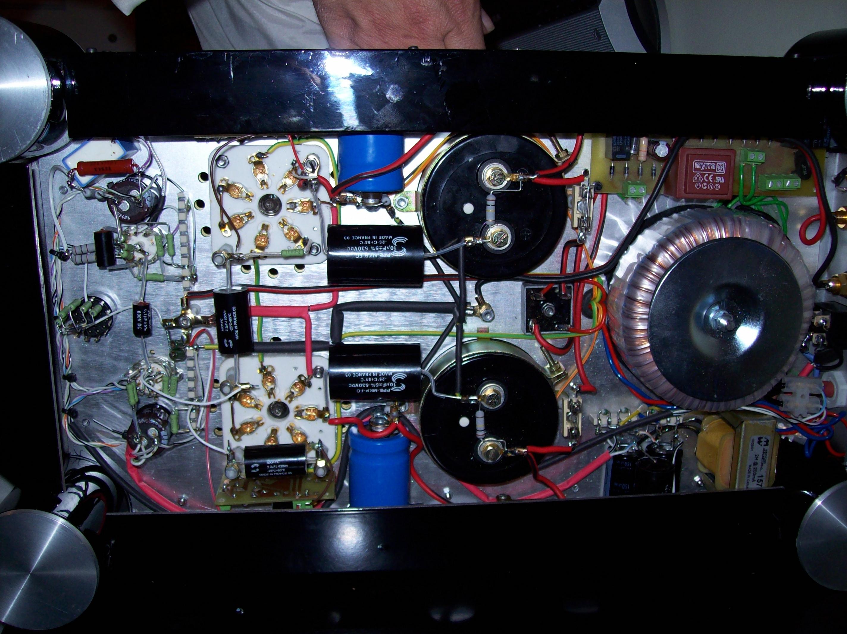

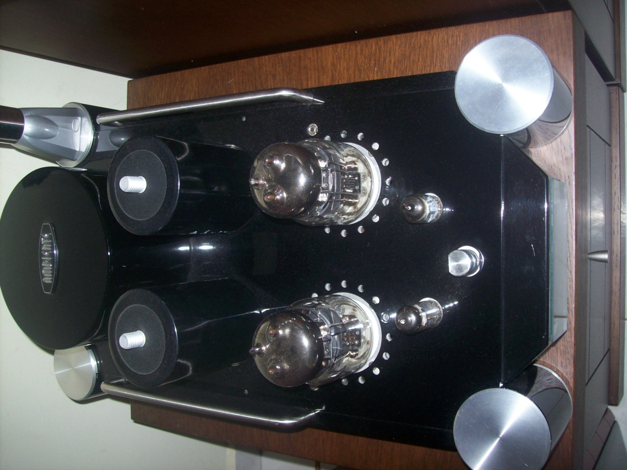

the small first tube it s ecc82 the secont it s spliter ecc182. the desing is Andrea Giufolli. Very nice clear sound!!! more fotos in a few days. sorry i dont know good english.

I see Ciuffoli's design is a futterman style.
Is he reducing output impedance using the feedback circuit?

It's an inverted Futterman design, the output impedance is ~11ohm with 2 6C33C tubes, (the output impedance is as for 2 cathode followers in parallel (Rp/2*(1+µ). This is then reduced further by global feedback
