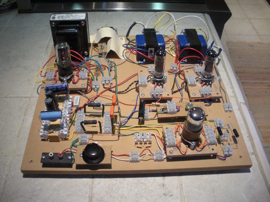

Yes I'm still working on the SE 6BQ5 amp. I should have it running an a couple of days.
I thought this may be a good time to look into how to regulate the screen voltage on Pentodes. The power supply I modeled in PSUD II looks stable but I will know more once I run the amp.
Is there a simple (something a Newbie would understand) solid state way to regulate screen voltage?
Would it help the performance?

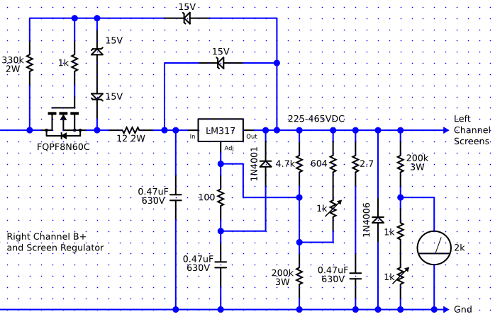

Here is a somewhat-adjustable Maida-style regulator that I built for another amp I am working on. It's based on the original data sheet, plus a few tricks I picked up on this forum. It is being used for screen regulation. I needed the range to allow me to experiment with lots of different tubes. The amp isn't done, but the power supplies have all been tested. It seems to work as designed and gives me some range to play with. Obviously, the FET will be dumping a lot of heat at lower voltages in my case.
As George said, you have to be mindful of dissipation through the various resistor and zener strings at both ends of the adjustable range. Here I have made an effort to minimize what the pot has to deal with. I made a spread sheet to help with this so that I could play around with the fixed resistor values to fit what I had on hand and control which components had to deal with burning watts, while giving me the range I wanted.
