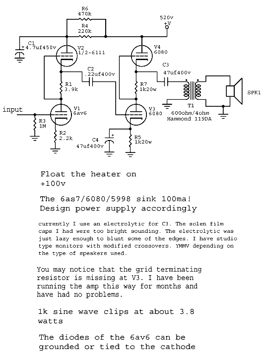

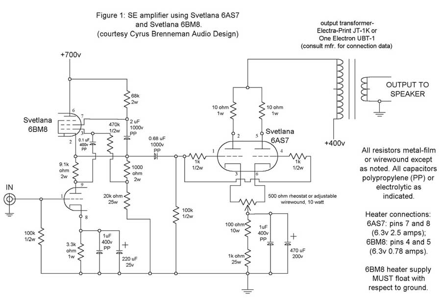

Hi to all,
New to this forum. I wonder if anyone could help to contribute some schematics of amps using 6AS7G as power tubes and 6BM8 or other tubes as drivers. Checked links from Svetlana Tech Bulletin (by Cyrus Brenneman) but links on circuit was dead. Will appreciate any design whether PP or SE. Cant afford OTL as I only have 4 of the 6AS7G tubes. Thank you very much.

Hi edrel,
there have been a few threads on this forum about that subject. Just do a search using "6AS7G" or "lilliput".
One amp discussed was the Lilliput amp using E88CC/6922/6DJ8 as driver and the 6080 as output tube.
This one is still on my secret wishlist to build....!
And it involves way lower voltages than the svetlana/brenneman design...

Hi edrel,

Guys,
Thank you very much for wonderful replies and infos. I am certainly enjoying this forum. Yes I searched before posting this and I wanted to compare the liliput vs. the brenneman design. Thanks again.
Jason,

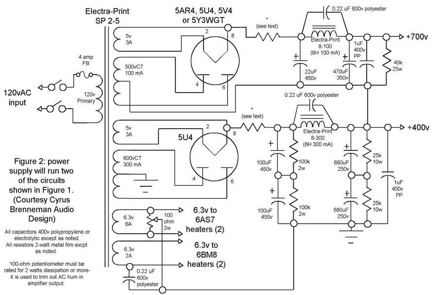

Thank you very much for the circuit. Yes I was asking for this. Would i am not be asking too much if i request posting here if you have a copy on your archive of the power supply circuit? There were two circuits on the svetlana site, the amp circuit and the power supply. Hope you have it. Thanks.

This german 6AS7 reminds me of this amp...from a fellow member from Diyaudio. From this one we have a schematic 🙂
I think speakers must be about 600 ohm. Tomorrow I'm going to a small city here in the netherlands check some old stock of dutch speakers...a good pair of 9710 - 800 ohm would come in handy for this amp 🙂

FWIW, I've found most of the Svetlana tech notes mirrored here:
http://216.87.144.102/svetlana/techbulletins.asp
They are not quite complete, but most of it is there.

schematics
Thanks Jason for the power supply schematic.
I appreciate you guys also for helping out on my DIY project.
regards,
edrel
