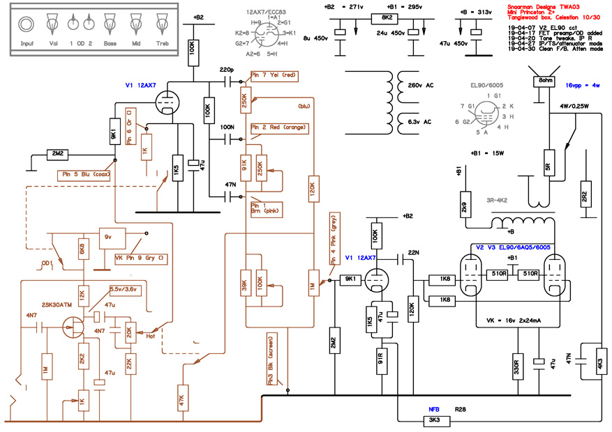

Hi guys. Back again after some months playing with various valve amp ideas.
I shelved the single valve ECL82 guitar amp concept because it didn't have enough gain - as widely predicted. However as part of that development I put a single stage FET front end on it and I was pleasantly surprised by the smooth breakup that the FET created.
So I grafted the same circuit into my twin 6V6 and twin 6AQ5 single ended amps to see what benefits I could get.
Attached is the schematic for the modified "hybrid" 6AQ5 amp. Via front panel switches I can dial in the FET stage to get some smooth early crunch, or I can switch it out to make the amp valve only for a clean sound.
Note that the FET load resistor is split in two with a switch. The lower load value operates the Drain at a higher bias point which is a light crunch setting. Switching both load resistors into circuit pushes the bias point lower and raises the harmonic distortion quite a bit. In both cases the gain of the FET also means the 12AX7 is driven hard and contributes its own crunch as well. Finally extra crunch is added by over biasing the 12AX7 with a change of cathode resistor. So I have clean, plus three stages of crunch available.

Thanks guys. I spent a lot of time listening to YouTube clips of 1959 Princeton tweed amps and set that as my desired sound. Those amps just seem to do it effortlessly...
So the key for me is the pair of pentodes in parallel in a Princeton like single ended output stage. In this case I'm using the output transformer from a 1950s radio. Theres enough feedback to keep the output fairly clean, and there won't be enough power to make the speaker break up. (That would be far too loud for my needs anyway). So it all has to happen in the front end.
I experimented with diodes to get the crunch sound but it wasn't quite right. The mis-biased FET idea produces something much nicer, more organic. The extra gain it produces also drives the triode harder which is a bonus. Both of these are second harmonic heavy, whereas my diode clipper idea was always more third harmonic. You see when the FET preamp is engaged I switch in an attenuating resistor after the first triode to bring the signal back down to reasonable levels for the main amp.
The speaker is a Celestion 10 30 - a ten inch fitted in a stupidly small box. So I have a large acoustic absorber (filled with sheep wool, cotton layers and leather cloth) that I drape over the rear to improve the tone.

Your 6aq5 amp sounds fantastic. I build a similar amp with a slightly different fet circuit. I also added a 100k pot in series with a 22k resistor to adjust the nfb. I also added a dpst switch on G3 of the tubes to be able to use 6AK6 (1.1w) 6AM5 (3 watts) or 6AQ5 (4 watts). I just use pin 1 only for G1 and switch G3 pin 7 to either pin 2 (cathode) on the 6AK6 or leave pin 7 open for 6BM5/6AQ5. It gives you many tone options and power levels. I also added a Pentode/triode switch on the output tubes. Just some things i did. Your amp sounds great. Bob. S
