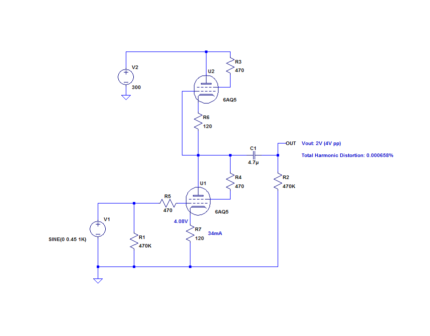

Is the load impedance you used with simulation (470k) quite impractical ?

The 470K ressitor is simply a DC ground return, not an actual load.

The schematic matejsirk presented is a LTspice schematic (.asc).
Therefore I have thought that he obviously had used that to simulate the performance of the circuit.
Did you notice the THD reading 0,000658 % with 4 Vpp there ?
I doubt it is not reality with actual loads, like 12 kohms.

The simm does look unrealistically optimistic. It's possible he used a no load condition for that. The SRPP will balance for three load conditions: dead short (turns both sections into grounded cathode amps) no load (just one current path: through both tubes) and the specific load resistance where source current equals sink current. Otherwise, the source and sink currents go out of balance, and distortion rises.

You're right. I'm not simulate the 12K. I will tonight.
