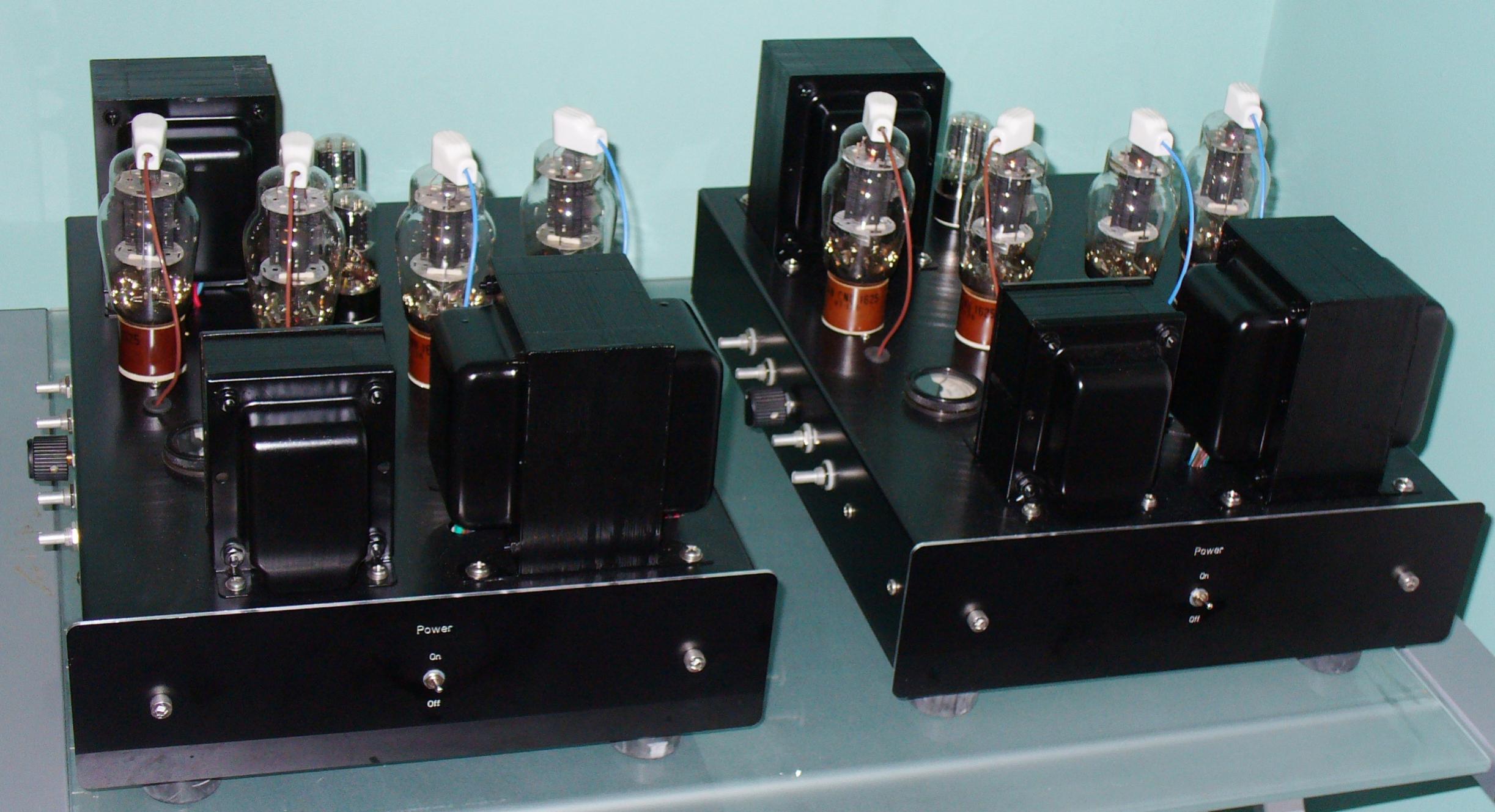

Here is a picture of the power amps I'm using with the 6AH4 preamp. The combination sounds outstanding. The 6AH4 preamp makes the power amps sound a lot better than they did before. Amazing upgrade.
