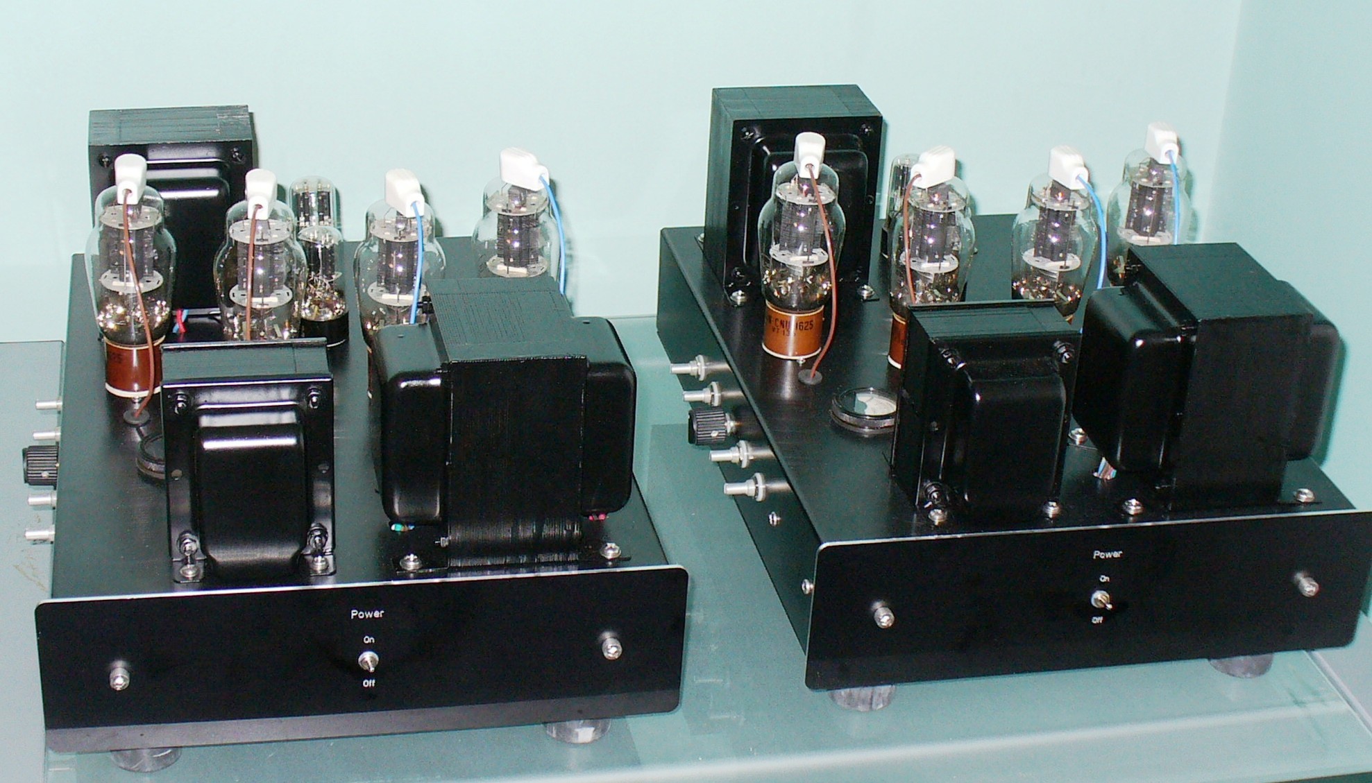

I've come into some 6883B tubes (12V 6146B), so I decided to make a pair of monoblocks using them as a output tube. From the spec sheet, looks like one can get close to 100 watts from a pair of them.
To ensure reliability, will go with a separate screen supply at slightly under 250V. Plan to make plate voltage around 600 volts. Will get transformers from Heyboer for power and output. Reckon a 100 watt at 6.6K CT should do the trick. Going to use 6BL7 tubes for the input/phase splitter.
Anyone else try making an amp with these? Looking for some feedback/input on this. The 6883B seems like a good candidate for output tube usage. It can provide as much power as a 6550, and since they are NOS, no worries about questionable quality and high prices of current 6550's.

Thanks for the feedback. The plan is to employ a separate supply for the screens, which is going to be no more than 250 volts. I have a pair of quad 1625 amps that uses much the same approach, and they sound outstanding.
What would you recommend setting the bias for each tube?
Yes, limit the screen dissipation at all costs.
The only problem is that if you jack the plate voltage up, the screens are sitting somewhat low... so not quite the same as a sweep tube, I guess?

Well, it took awhile, but amps are finished, and sounding mighty good. My buddy built these for me, as he does outstanding work.
I'm very impressed with the sound from these. All power and screen supplies have individual windings and regulation/filtering, The results are that the amp exhibits outstanding low level detail and dynamics, along with being dead quiet. This is the second amp I have had made that sports pentode operation, and I have to say that the sonic character from both of them seems subjectively better than the ultra-linear amps I have owned over the years.
The 6883B makes a excellent audio output tube, and the 6BL7 is nice input/phase splitter tube.
Got the idea for this from the Acrosound 1955 manual, which has a 90 watt 6146 schematic. The mastero amp from 1951 also sports a 100 watt 6146 amp design.
I would much rather use a tube like the 6883B over current 6550/KT88 tubes, for a variety of obvious reasons.

The amp continues to improve as they break in. Used Jupiter copper bypass caps, which sound pretty good once they get some hours on them. They sound a little closed in for the first 20 to 30 hours, at which point they start to open up nicely.

I had these made in late 2013. They sound great. Output power is 110 watts for each mono block.
BTW, I had oscillation problems with them, and found the fix from a post you made here in DIY Audio:
" Yeah. 807s are notorious for this. What you have there is a damped RF oscillation that's being triggered by plate current cutoff (Barkhausen oscillation). I had the same thing happen with a project that used 807s. What you need is a really good plate stopper, and screen stoppers.
In this design, the plate stoppers (L1, R31 & L2, R32) consist of ten turns of #18 wire; ID= 7/16"; space wound. Install 100R, 2W, C-comp resistors inside the coil. Install right at the plate connector. (If you can't get 100R / 2W C-comps, use four, 470R / 0.5W C-comps in parallel.)
Install 1K5 / 0.5W C-comp or C-film grid stoppers right at the screen grid connection at the socket.
This should get the final stable."

Thought I would post an update about this project. The amps sound great. The 6883B makes an excellent audio output tube. I dropped the output bias to 30ma to maintain some longevity with the tubes. Had a couple with the same 80's date code go bad early. However, between dropping the bias and not using that specific date code, the amps have been reliable and sound great.
One other tweak that was done was to change the coupling caps to Jupiter Copper Foils. Made a big difference with transparency and clarity with the midrange and treble.
