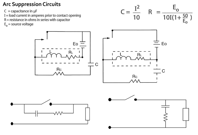

with resistor like this :Arc suppression on mains switch?
