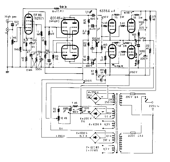

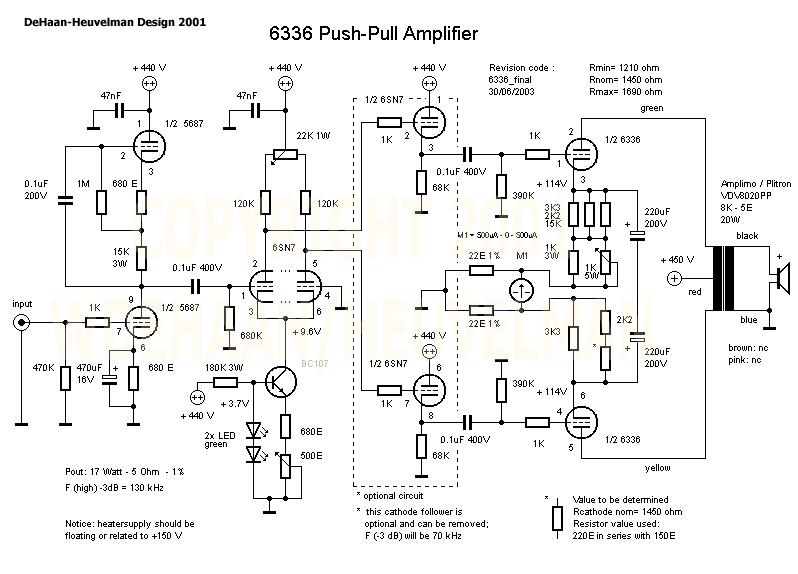

> see attached circuit by De Haan which looks pretty good to me.
Looks fine to me. Is fairly inefficient: 70W B+ and 30W heater == 100 watts in for a claimed 17 watts out. The 17 Watts out looks about right for 8K load and low distortion. With a 4K load it could make 35-40 gross watts at clipping, but distortion would be higher. Taking 100 watts in for 40 watts out, it does not look all that bad! Especially considering it includes heater power.
> OTL amp using four 6336A per channel
Assuming a 16Ω loudspeaker, eight triodes (four 6336), and assuming that you can jam the loadline into the "V" between the zero-bias line and the plate power limit: this gives 20 watts out for probably over 200 watts of heat. Also the driver tube is really working too hard to whomp those grids around, even though it is fed +490V.
The actual condition with 160V per tube suggests a 200Ω loadline per pair, or 50Ω for four bottles (eight triodes).
(Assuming it was designed to respect the 30W plate limit. Actually in speech/music it could swing far above the plate dissipation limit on peaks, and maybe even on 1KHz test tones. Sustained 16Hz might show a flickering red glow and eventual plate cracking.)
Witihin ratings, that gives about 16 watts per pair, 64 watts for the whole rig, IF you have a 50Ω speaker. In 16Ω it would be 21 watts, in 8Ω only 11 watts. Or you could stack a dozen bottles per channel and drive maybe 150 watts into 16Ω. However that's over 1,000 watts of heat rising off the bottles! (and your electric bill)
Ignoring the plate rating, it may make a whole lot more power, though with some doubt about tube longevity if you use that power a lot.

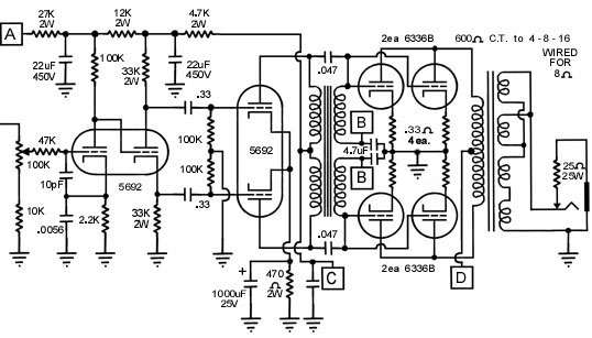

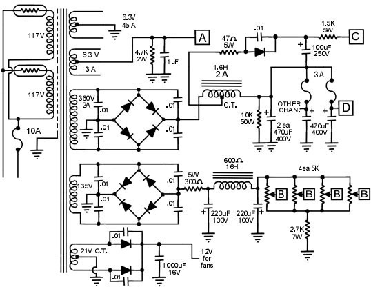

Re: your loadline: I'm sure you're well aware that an OTL is never ran in class A for efficiency reasons; AB is taken instead. The lower standing plate dissipation, as well as cutoff for part of the cycle, means instantaneous plate dissipation well over limit, but since it's the RMS that matters (within the plate's thermal mass' time constant), the tube will still be within ratings. So such a conservative and high speaker load is not necessary.
Tim
Tim
Which is why I often say plot the circuit not the tube as such.
Lest we're talking a one of, lets forget about the 6528, even the 6336A and focus on what's available in quantity today and tomorrow.
The 6080, 6AS7G, 6C33C, 6C19P and such are all prime candidates.
And if you must really go esoteric on OTL tubes find me a set of 7241s...
BTW, the TAKI circuit posted above delivers 140W peak into a 16 Ohm load...
The driver isn't the greatest, I know. That can easily be solved...
I had 10 6336A driven by a pair of 6BX7s easy.
The problem is mainly Miller capacitance, once overcom you have all the BW you dreamt of.
Cheers,😉
