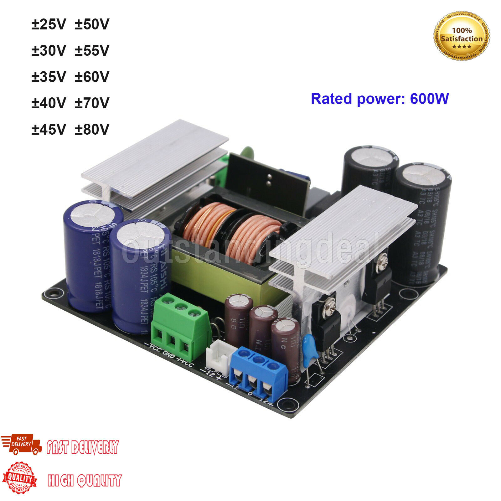

Have bought one of these SMPS on eBay:
https://www.ebay.com/itm/154164805607?hash=item23e4f03fe7:g:uzgAAOSwlxRfVvpt
I actually also have one running +-70V and a new one for +-35V, all for supplying class d amps.
The +-70V one did work and is running in my main amp right now. I checked the additional supply voltages, and was a bit surprised they where a bit off, not delivering +-12V or +12V, as I recall they where a bit higher, but thought this was down to these to being regulated, and as I'm regulating the +-12V down to +-6V on the amp board, and as the +12V which I referenced to the -70V for supplying the Gate driver, it all worked fine.
But with the +-35V supply, I'm getting only +-6V and +6V!!!!!
Anyone have the same experience with these SMPS?
I'm wondering if the transformer is the same for all the different output voltages you can chose from?? Or whether this is a fault altogether.
As the output is not regulated you'll need more windings for getting 12V on the +-35V SMPS, than for the one giving +-70V!
There is a small resistor on the bottom side of the pcb, and I'm wondering if this is actually how they change the main output voltage, and that this is not done using different transformers!

Hello.
Don't get this the wrong way but how hard can it be to simply follow the copper traces from the auxiliary outputs, to get a simple block diagram of what and how they are done?
As i see in the pictures, it is a rudimentary PSU, absolutely bare minimum, thus it cannot be that hard to reverse engineering.

The answer is they are junk and you get what you pay for. Switching supplies usually use a resistive divider for feedback to regulate the output.
Isn't it?Not really an answer to my post I think .... 🤔
Look at the PSU's pictures, it's as basic as it gets, despite the black silkscreen you can still see the copper traces well enough, thus you can easily reverse engineer it.
What tests have you done on it thus far?
Well it might me just me, but a reply saying: Why do people buy this crap? .... is less than constructive, and not really a way to get a good conversation started.
The question was; has anyone else had the same experience with these SMPS'? Having too low aux voltages with the lower voltage SPMS'?
And secondly, a question about the production or finalization, to accommodate the many options for "primary" voltages, whether this is just done by changing the FB resistor or actually done by also changing the transformer?
I'm aware that this is of course not a high end SMPS, that you could use in the space industry, and I have no misconceptions about the max output and that the 600W is probably set at least 2x the actual usable limit.

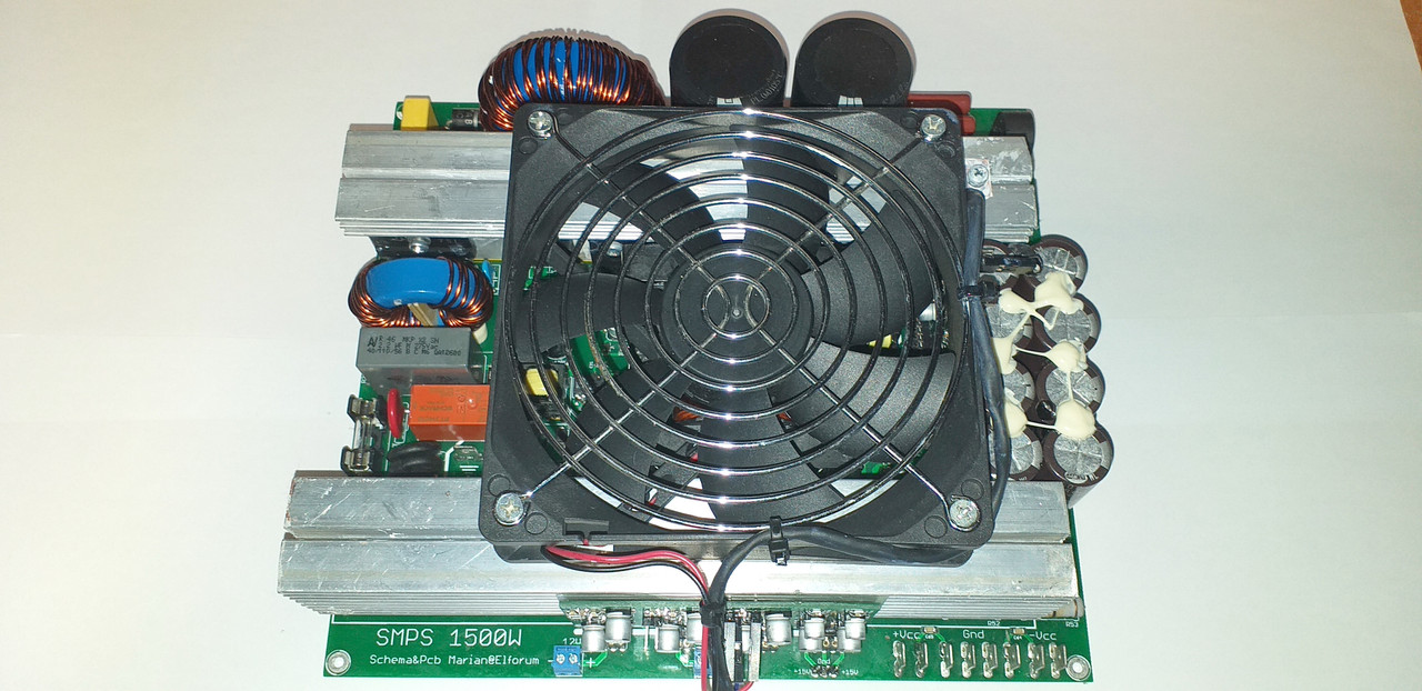

I know i may have seamed a bit rough but as it happens i design and built high performance SMPS ( both low and high power ), so i was speaking from experience. For instance this is one of my creations ( schematic and pcb design, and also assembly, all done be me ):
https://i.postimg.cc/gkyF0MZK/001.jpg
1500W SMPS with active PFC, just over 90% overall efficiency at maximum power...
And when i say it does 1500W i mean nonstop power.
But it's BOM cost alone is more than 200$...
That is why i said those things, good quality comes at a price, and i would not use those cheap chinese stuff unless i had absolutely no other choice.

There are some readily wound LLC xformers available at Würth Electronic. Btw, I configured my LLC-converters the same way. Being unregulated this is the modern replacement for unregulated toroidal supply with improved properties.Now we talk about it, do so,eone now where to buy transformers? And crap, yes it can be that way, but LLC circuit is circuit, feedback

Check output diodes solder joints, transformer, I do not now it is a smps with feedback? but as a resonance version you need to check
the frequency of the circuit, if it is to low or to high, if this is oke, the supply contains properly a wrong transformer or some parts are fake.
When the frequency is to high or to low, wrong cap/resistor osc setting on gate driver chip. Here it looks like
it is fabricated with wrong parts or some are fake. measurements are the solution. these smps are not that complicated.
With a scope you can look, be careful with probes and a direct connection to grid.
