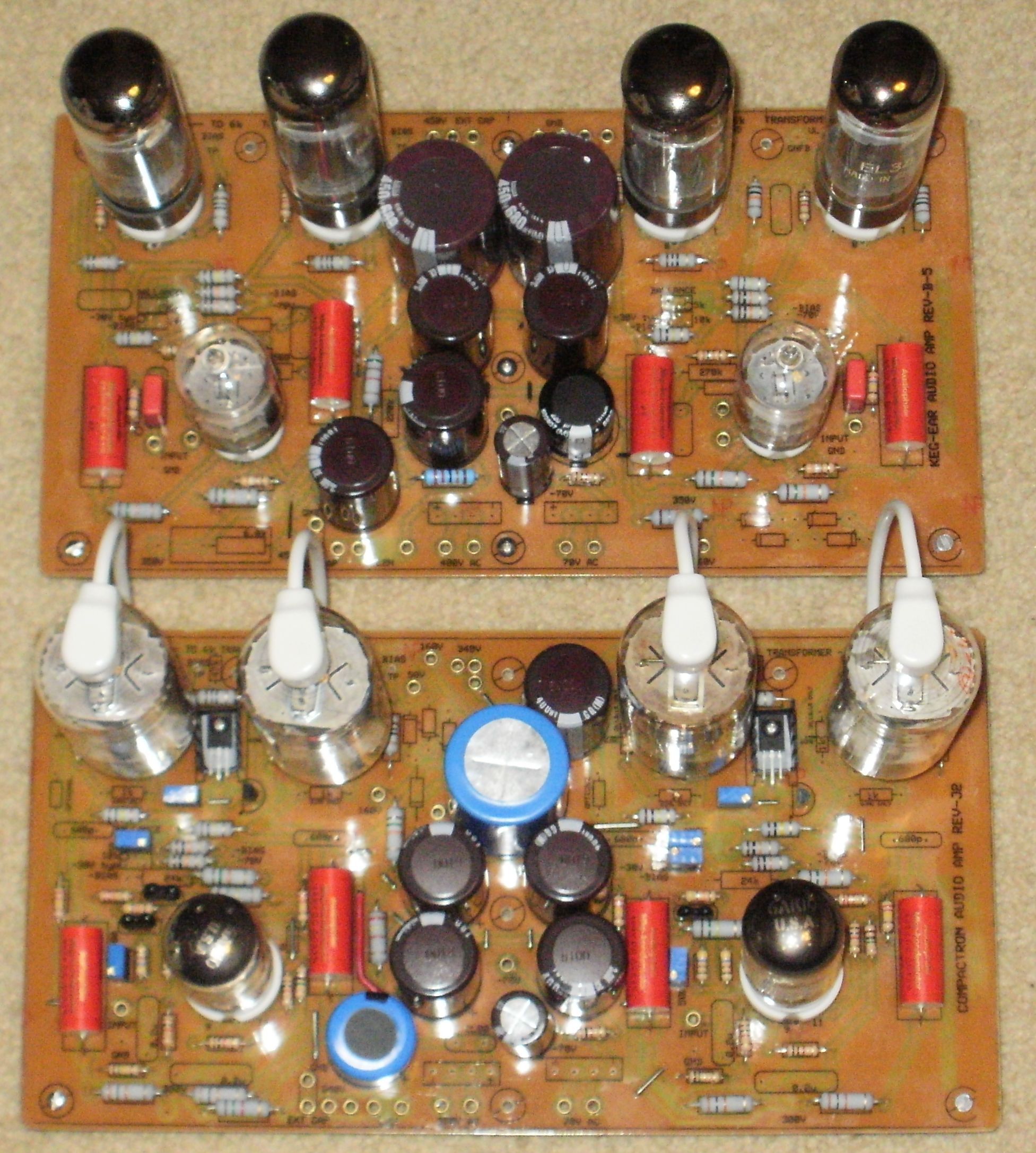

Panasonic has the 500V electo's snap ins at a pri$e. I used 47u for the first cap and a 470u for the cap after the choke. For the KEG-EAR PCB I stacked the caps to use the large 450v caps that I had a stash of. I can push 800V for B+ before I need to be concerned about the caps, board spacing also should be good for 800V. Currently quite happy at 450V with an initial voltage of close to 490 volts prior to the output tubes being fully on line.
The blue caps are the 500V Panasonics, all caps get mounted on the back side of the PCB, just checking parts count for missing stuff to order...
