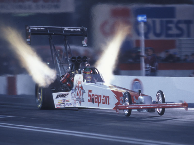

You want loud?
Inside the exhaust port of an ordinary car engine is about 180dB.
I read where someone measured the sound level of a top fuel dragster at 1 metre at 163.5dB. You owe it to yourself to hear and see one of these things go - from a safe distance of course. Puts a whole new meaning to the word =loud=.
oh I'll believe those dragsters are loud!!! I've seen a few races... but havent seen the ones exactly like you show in your picture... 180db in the pipe sure, but its nowhere near the infrasonic bass frequency which a space shuttle can produce. You cant measure sound pressure 1 meter from the rocket nozzel because the mic would vaporize
They should angle the exhaust(flames) back more on those cars... providing downforce and thrust
