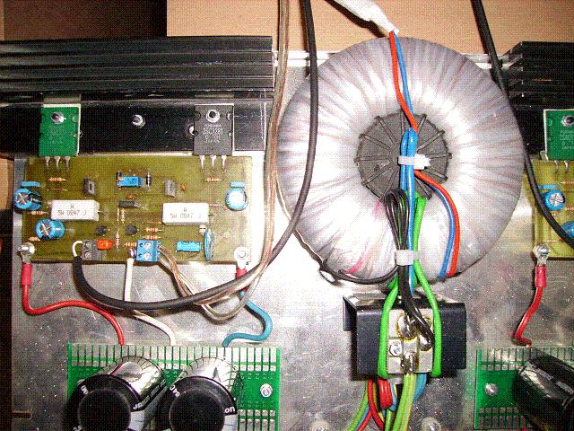

as most of you i run a repair shop and small pa rentals so more or less i repair or update 2-5 amplifiers per week ( meanwhile i construct aslo many things )
one time i had to construct for a friend one amp that needed to fit in a specific size in a costum made pcb ...i choose P3 since is a very simple thing to make ....then construct this special pcb ( had to be very long and kind of thin )
listen to it and since it sounded so nice i made a stereo dual mono version justa t have in the shop for general use .....
i used original 2sa1302 and 2sc3286 from toshiba a simple but nice made pcb 4x4700 mfd per amplifier and toroids of 31.5+31.5 ac 200w each ......nothing else really special .... metal film resistors .... 100mfd +0.1 mfd next out bjt's for by passing extra styroflex bypass capacitors on the psu caps , matched bc559
( just for fun ) and smd styroflex miller cap on vas amplifier lower than 100pf specified since 100pf was kind of too much .....
results :
this amplifier outperformed many many amplifiers factory made for breakfast !!!!!!!
i always listen the same cd ....same source .....same speakers .... my tests are based on this except scope signal genarator and distortion analyzer ....
the basic diference ( there is many ) is that the tops are really clean and a lot, then the low end is very rich ...the midle is there and yet very very controlable ........
todays test was next to a yamaha ax396 and the results where almost the same ..... the bass of the yamaha sounded kind of pour high was kind of fuzzy and in the midle yamaha appeared very linear without problems
yesterdays test was with a jvc jrs600 markII witha a SEA equalizer and a million of dirty switches and pots ....but thank got pre to main amp bridge existed in the back so it was possible to litsen to the amp also alone .....
yet again the same results low end was good but not really rich compaired to rods litle amp and high !!!! o my god there was a really big diference .....jvc was very metalic and kind of hassy .... small lack of midle also there ( keep in mind that jvc was totally recaped with elna redline caps and almost the 50% of the amplifier's resistors where changed to 5% resistors since most of them had serious tollerance problems )
i can continue with more tests since i perform more than 3 tests per week with my sytems ....
strange e ?????
here is a photo
another thing i missed .....
the pcb i made for my friend was made also the same way except the by pass caps located next to transistors .....
the pcb was made double side cause its had to be 22 cm long and three cm wide to fit inside some surround speakers .....
well....that board didnt sound the same ......
was it the by pass capacitors that missing ???? was it some ocilation created from the construction of the double side pcb since gound routing was very strange ???? or may i was just lucky and the pcb ive made was really perfect in the stereo version compaired to the long version .....
wel.... friend of mine who borrow the particular dual mono stereo version was edicted to it and made him through in the garbage a lector amplifier .... (ubrid mosfet+ tubes ) .....
