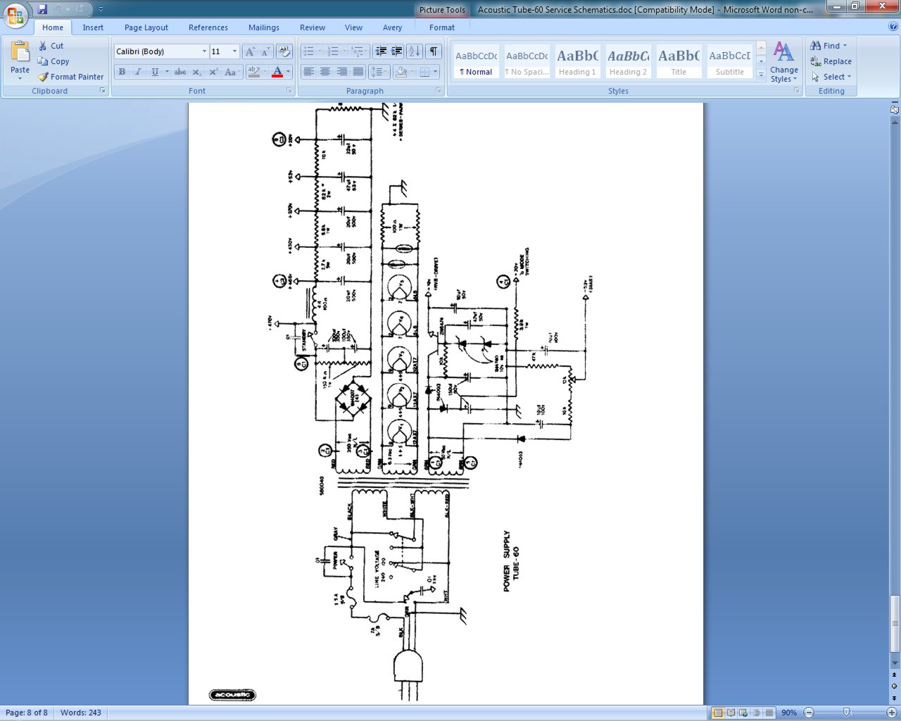

sounds like a power supply problem, is it valve or diopde rectified? switching to diode rectification might help and as kevin said, the caps probably could do with replacement. as for impedance problems, i doubt this is the case, although it can contribute, i cant see it making a significant difference. also, if any bypass caps are electrolytic then it probably wouldnt be a bad idea replacing them either, and if theyre relatively big, making them slightly smaller wont hurt.

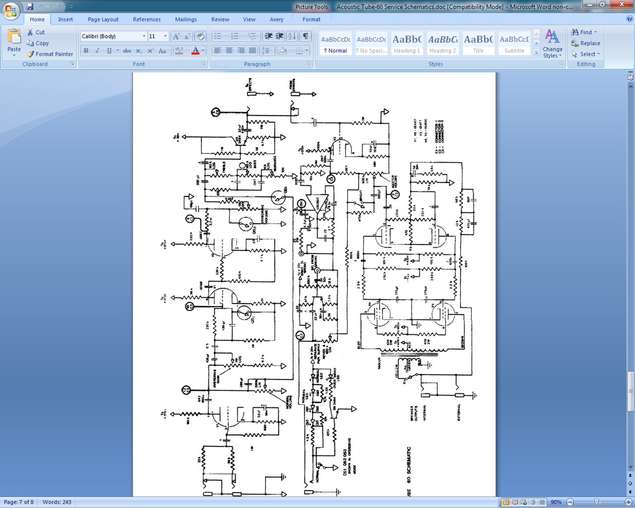

ok did a little analysis of whats there, i think there should be another stage of power supply filtering, this should help alot, feeding 4 valves with one supply could pose a problem, change the 1st valve bypass cap from 22u to 1u/2.2u change coupling caps to 22nf instead of 47nf. all should lead to less bass and more highs
but yes 2.2k, hehe your right there wasnt alot of sparkle, but the highs were enough.
after a bit of googling i found a 60 watt acoustic amp schematic here,
not good quality but a start http://www.cornelvis.com/Schematics/newamps/acoustic_g60t.pdf
Good enough. I would narrow it down to preamp or amp first. Feed the guitar in the amp power amp input with a pedal and see how it sounds. If it does not sound muddy it may be the preamp. Mind you as said it might just be the speakers. I have been working on an amp today and there is night and day between the 12" I'm using and the 10".
The 0.1uF coupling caps after the PI are also large.

update: After long hard searching I can't find the schematic so I had to buy it again online. Waiting for the return email and dload link, then I will post it.
One thing I was told by someone along the way was that the OT is largely responsible for how "strong" the bass is, not sure if that is true, interesting that my "treble boost" loosely based on the old rangemaster circuit, makes the bass much cleaner, but like I said, it also seems to remove some tube "goodness".
schematic
OK here's the schematic. I also considered that the amp needs a cap replacement job.
Would bad caps cause this problem? I'm assuming it is the large blue caps (about 2 inches long) that need to be replaced.
Any help is much appreciated, as well as any comments about this schematic.
I had a real hard time trying to extract the schematic from a pdf in a small enough format to upload here, so I just took a couple screenshots. thanks!
