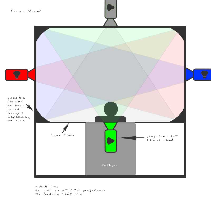

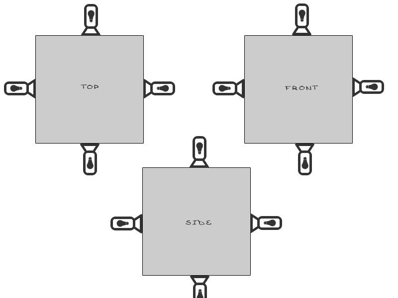

yes...charlie10, I was also thinking of two projectors for the floor...or just saying screw it and not projecting anything on the floor. I was also planning on putting the projectors up higher in the wall, and I would be sitting in a homebuild cockpit that would basically be like me sitting on the floor...was hoping I could shine the projectors over the cockpit (and my big noodle) for the most part which would hopefully put any shadows down towards the floor....I'll work up another diagram of what I'm thinking and post it here.
here we go...I just figured....if I brought the floor up to about my shoulders height or so...that would mean the sides views would not need to shine over my noodle. The front and back may still be tricky...I may want to make it so my back is almost flush against the back wall cause I'm gonna have a shadow back there anyhow....
at any rate...here's just a lil something that I drew up that may or may not be really off target.
just to clarify...the color of the projectors in my last post are simply so you can tell which light goes where and so on and so forth...they won't be monocolor PJs...they're simply for the sake of the diagram.

Starting off from your idea of crowns to help blend the images. And considering what I think is a need to minimize ambient light. I am going to go out on a limb and suggest... a cylindrical room! I mean why not?
- Your diagram would be unchanged except the assumption of 4 side walls.
- this would allow use of a high-gain projection screen material on the cylindical wall, concentrating light on the viewer and reducing excess ambient light
- could get away with three 120deg. projectors instead of four 90deg. ones, lower PJ cost, fewer seams, higher room construction cost though
But are the optics impossible? I have no idea...
