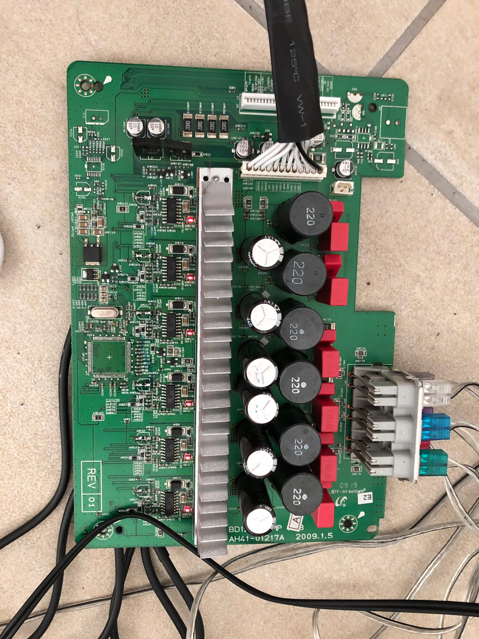

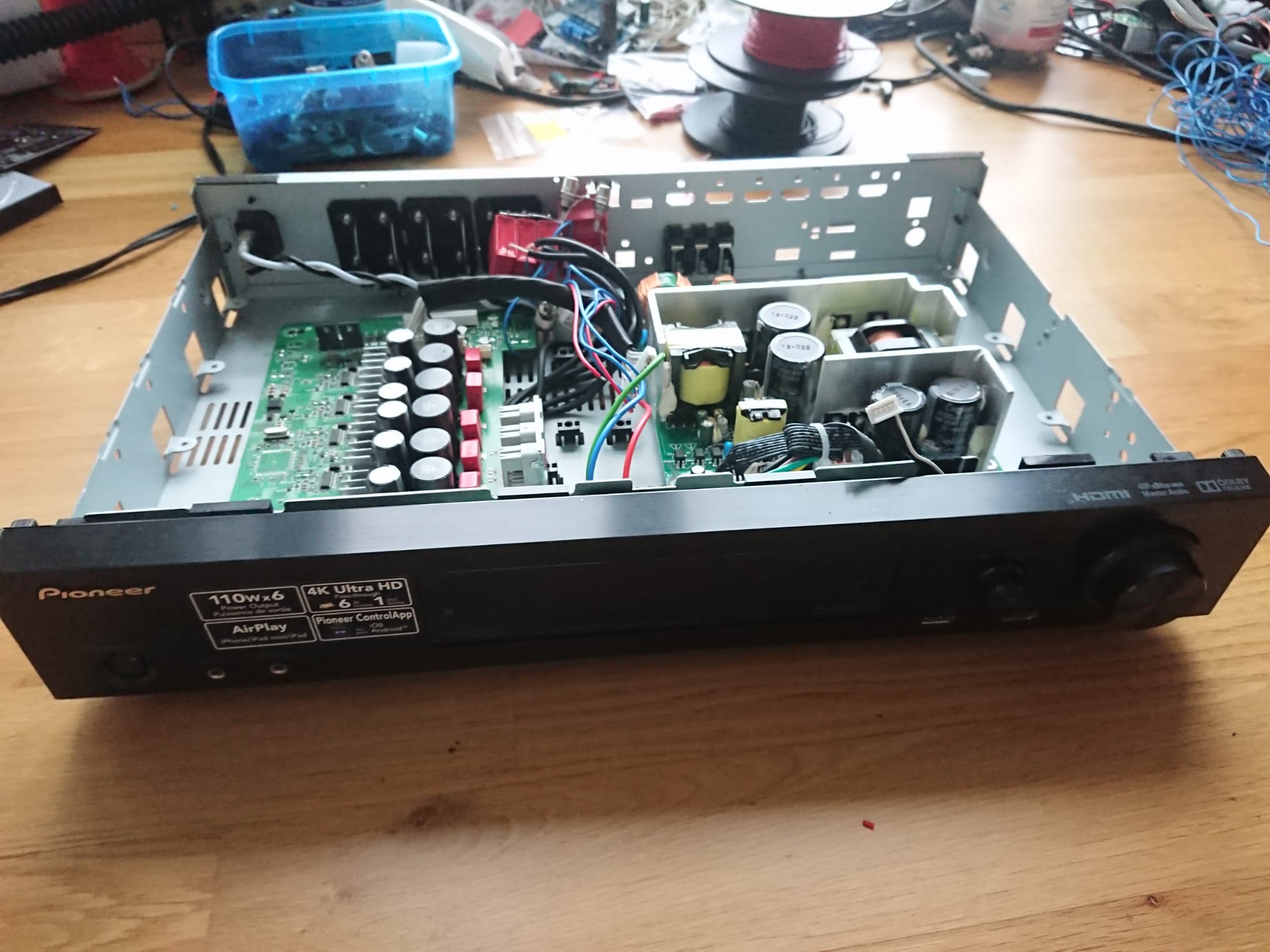

I am planing a DIY 6 channel amplifier based on IRS2092. Implementation is like IRAUDAMP5 (IRF6645 hexfet mosfets).
- Power supply is +-36V
- PT2325 volume control.
I will put some relay for bypassing volume controle (PT2325) on-demand like Yamahas Pure Direct.

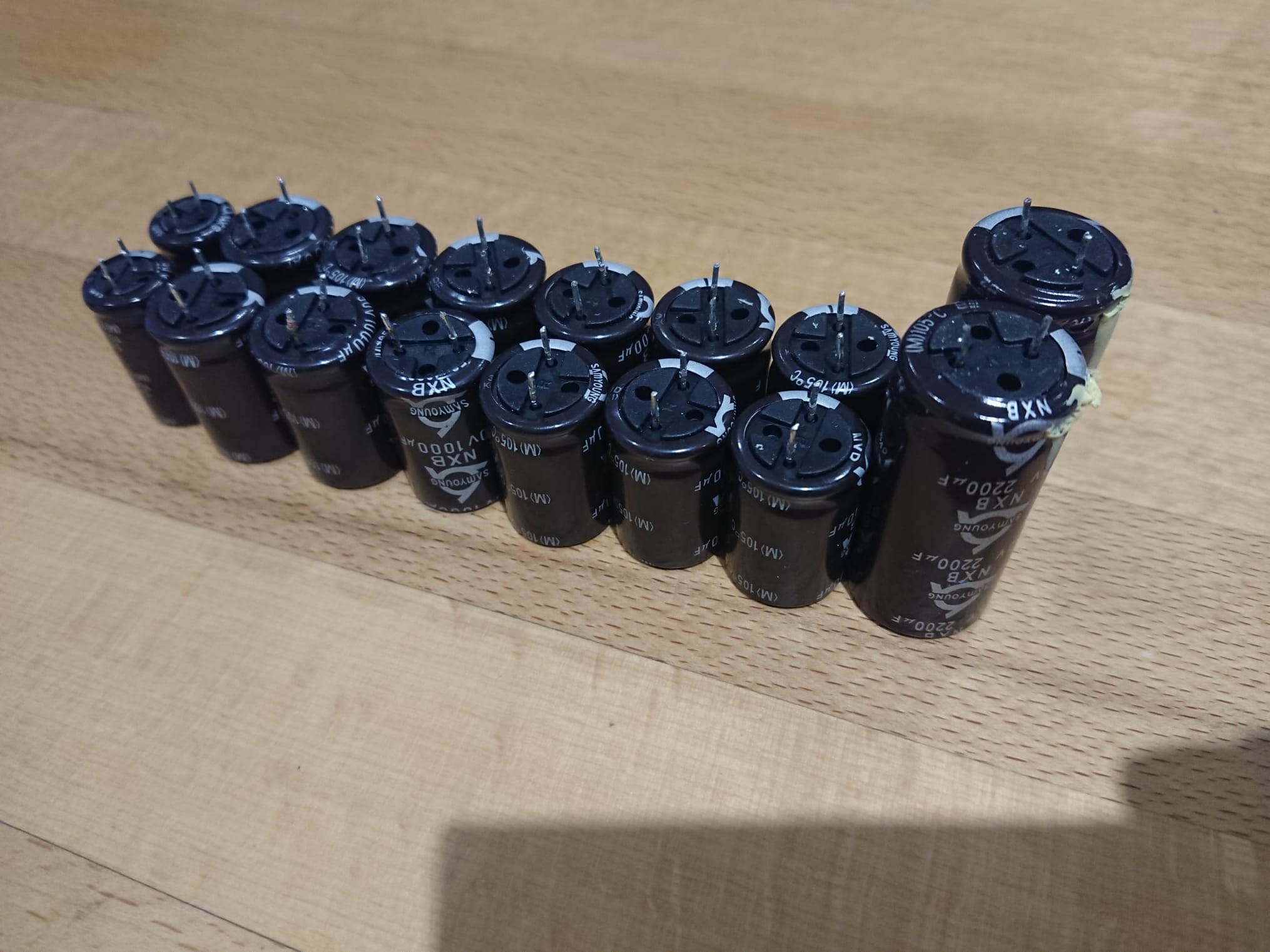

I am thinking of addin 12x 1000uF with 2x 2200uF and 2x 680UF. this capacitors are Samyoung NXB. Not the most best but at stock.

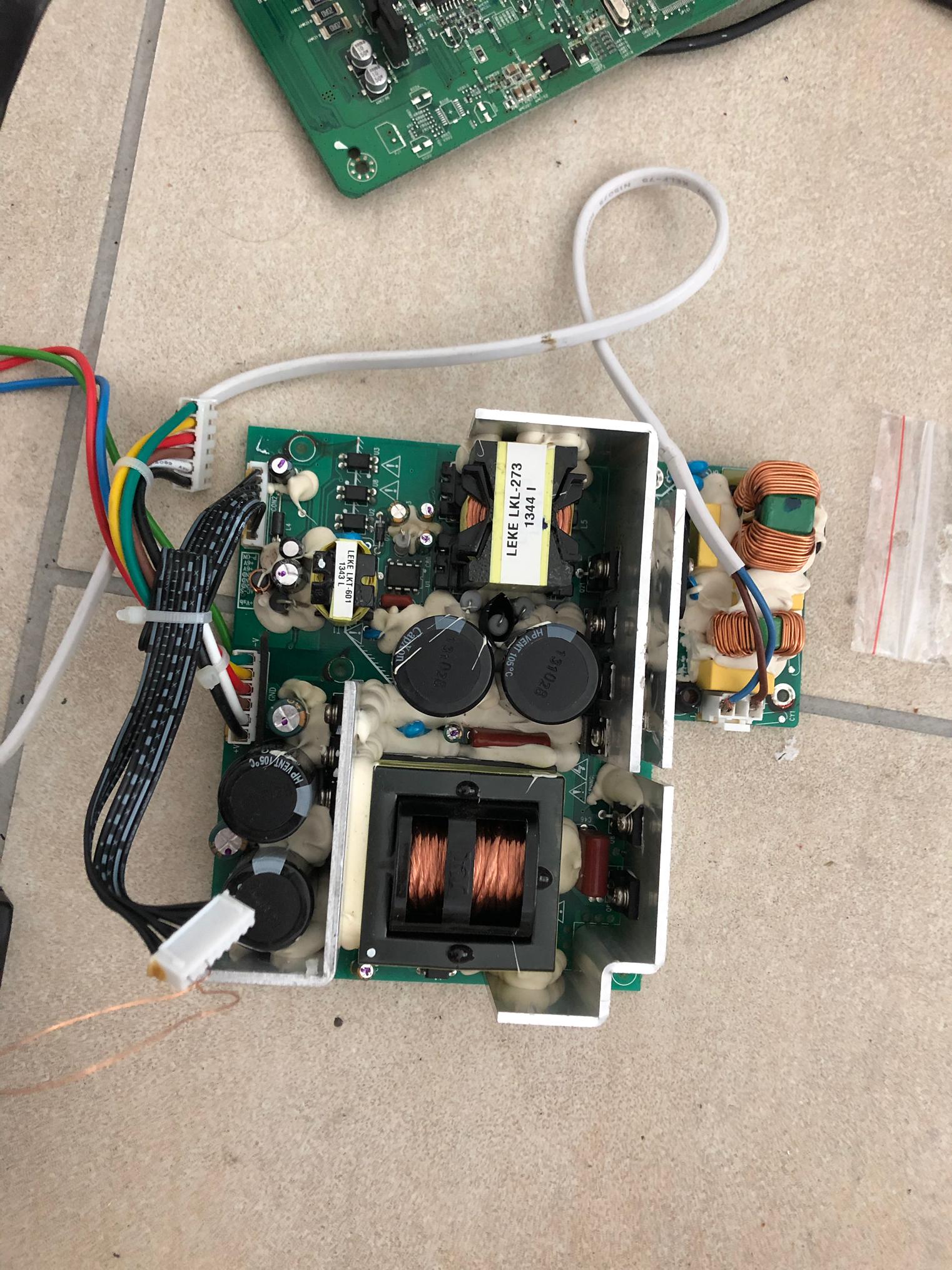

Power supply looks to be enought for powering this amp easilybut has only 6V auxiliary supply. So I should take 36V and +5V and -5V converter for the amp.
The hole amp will be turned on and audio by Teufel Decoderstation 5.

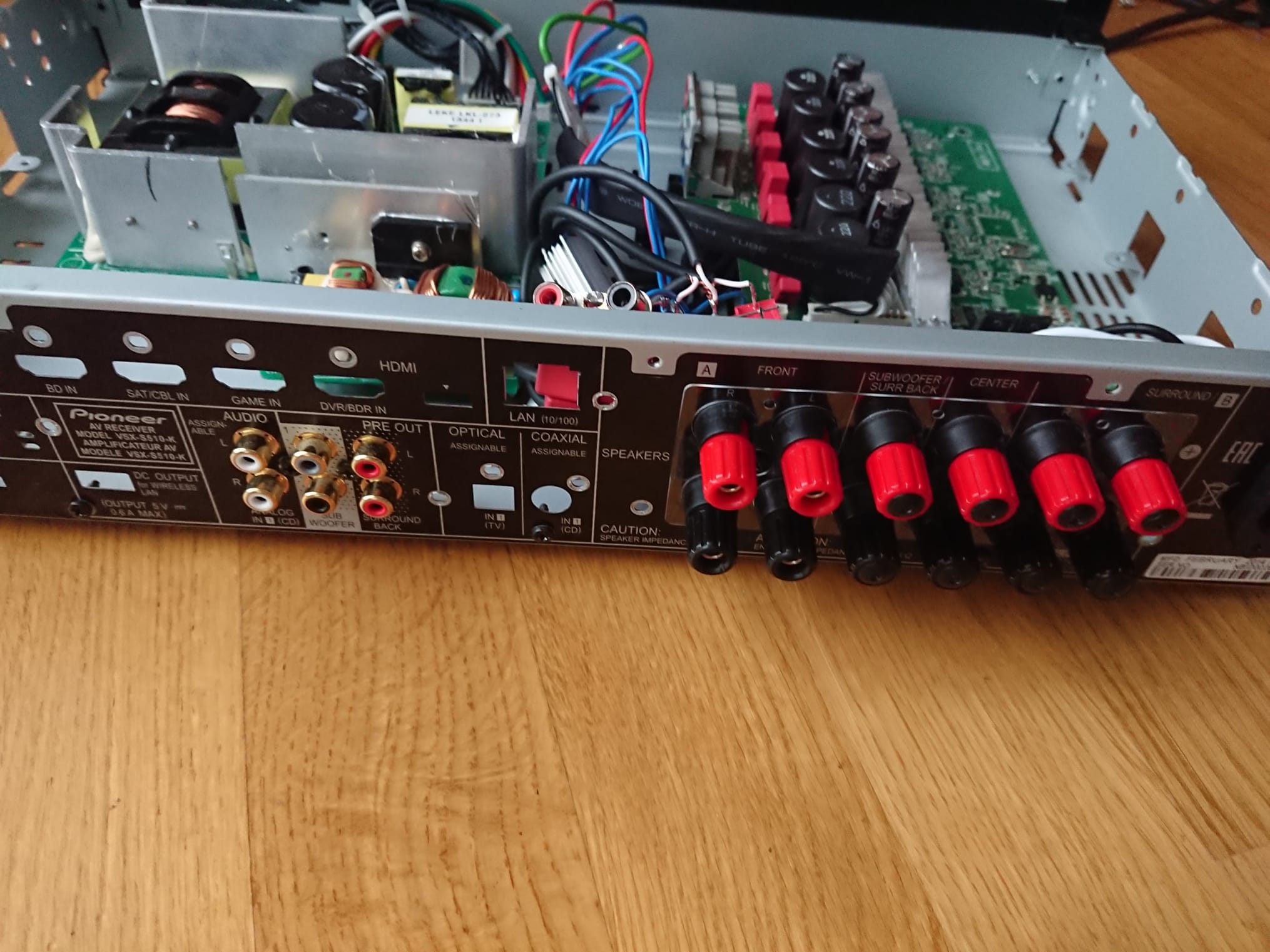

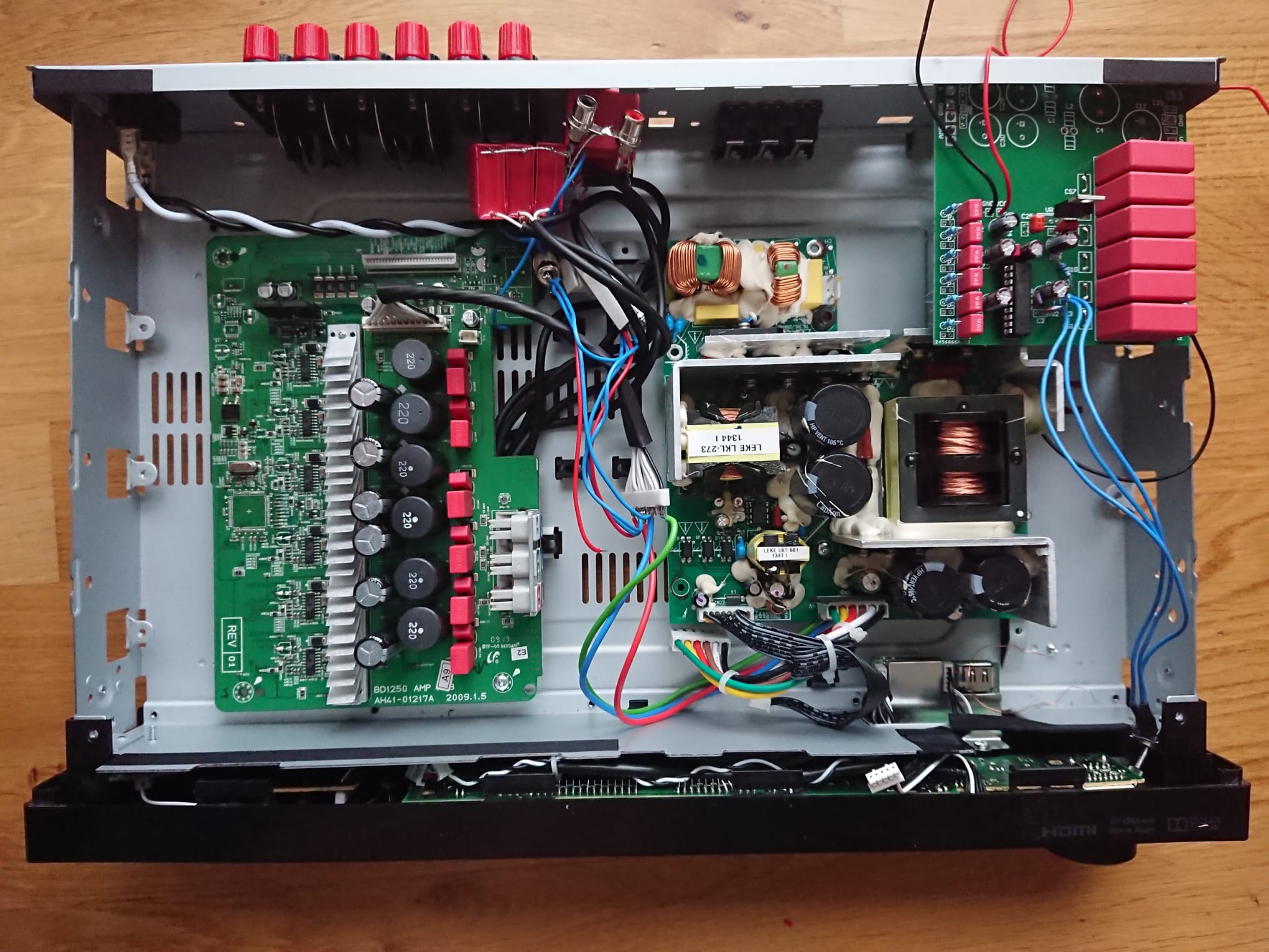

How can the pcb boards be mountet easily in the Pioneer VSX-S510 case I will use for it?
