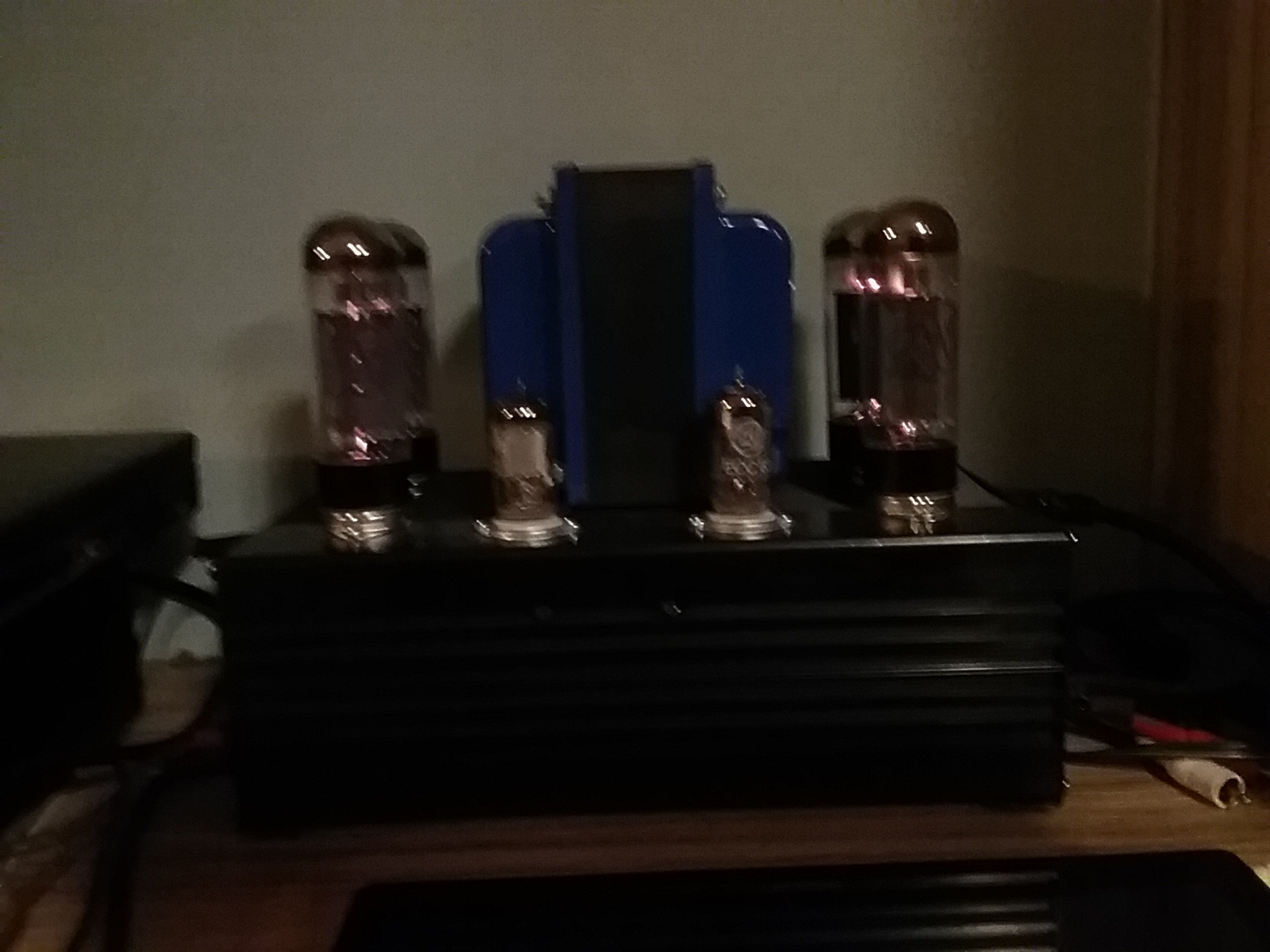

I build a 6- 60 AMP MONOBLOCK .I used as output transformer Edcor 100Cxpp 2.2k.As powertransfo Amplimo 6N536P.Input Ef86 in triode mode then Ecc83 phase splitter and this drives 4 xEl34.The rectifier is a diode bridge out of old PC supply.This is an easy to build amp witch is perfectly stabel good bass and high .Easy to build no exotic tubes .Output power +- 60 Watt .
If anybody would like to build this amp i can give schematics and some help with how to do
Everything
