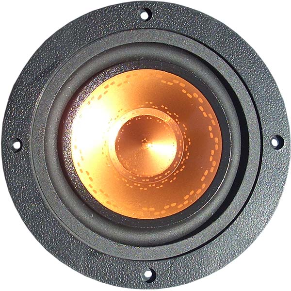

Dang, that copper color would be perfect and I already mentioned no grills to my wife, she knows I do not like them, said would look really cool and easier to clean🙂
Anyway to spray paint the cones on a silver set and not add to much mass and mess up the response?

My sweet wife wants copper colored speakers as they will have no grills and be in the ceiling in the bedroom, she spends quite a bit of time reading there and loves copper/copper color if not actual copper.
That said I am looking at the MA drivers in what they call "gold" as it looks copper in all the pics.
Alpair-10M
Alpair-11MS
Alpair-7MS
Fulvia Eleven
Pretty big price spread but if the most expensive ones are the best ones then OK with that, if a less expensive pair are still very good, close enough....then that is cool as well🙂

I have the 5 and 10, the latter needs to be toe'ed out quite a lot for bedtime listening. Both sound very smooth like liquid metal, but still a hint of metal compared to other stuff. I made Alpair 5.2 in 3.75-liter TLonken (there's a thread with pics) and used Alpair 10.3 omni pointing up as well as in desktop stainless bowls (slightly tilted, pic in the full range photo Gallery). If ceiling mounted, 10.3 might point straight down omni-directional. Or, mount either in a ball/bowl that can be pointed as needed.
It is copper. There have been no gold MA since the first generation… only the label on the box has soldiered on.
Don’t forget the Pluvia 7HD. It is probably the sweet spot between A5.x and A10.3. Has the same bass potential as the larger driver, better dispersion and a tiny edge thru the mids.
The mino suapension drivers (A7/11ms, A6.3) probably won’t be happy long term in the ceiling.

Cool, Wife will be super happy about that, loves her copper!
I did not look at the 7HD, figured to small but it sure has great numbers and really nice response.
And, cheaper!
