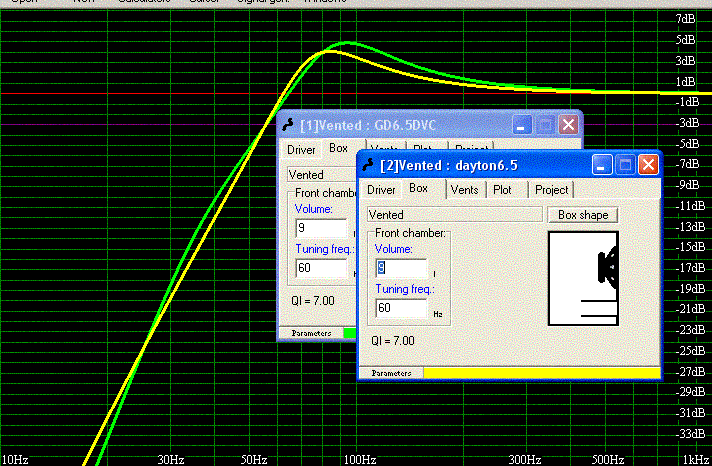

If that's cm and the wall is 12 mm thick you're left with only 6 liter. If that is inches you have a way too big sub for a 6.5 incher
The tangband W6 1139sc is 4 ohm and can go in an awfull smal space but this is probably to small.
The sub would work but the port would need to be relatively long (285mm with an internal dia of 36 mm)
If you have an opportunity: build yourself a new enclosure of about 12 liters internal volume and use this driver you can easily calculate the portlengt with winisd

So if I understand correctly 9 litres internal volume,with a slot
port 22cm x 1cm length 12cm, which is a port frequency of 60Hz.
It needs a carefully chosen driver for volume / tuning,
and its possible EQ is built into the subwoofer.

You are right, the box is 9 litres internal volume,with a slot port.
Thanks for the graphs. I think I will go with the Goldwood, Im just scared that it might blow with high power. I have called Altec Lansing, they said since its a discontinued product they cant help me.
Since 6.5 inch 4 ohm speakers are so hard to find I think I might go with a 6 ohm , what do you guys think about this: http://www.partsexpress.com/pe/showdetl.cfm?&DID=7&Partnumber=290-027
