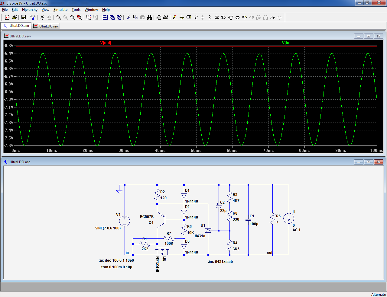

Using a few ordinary discretes, you can cobble together a LDO having <100mV dropout.
Normally, you could even dispense with the schottky's.

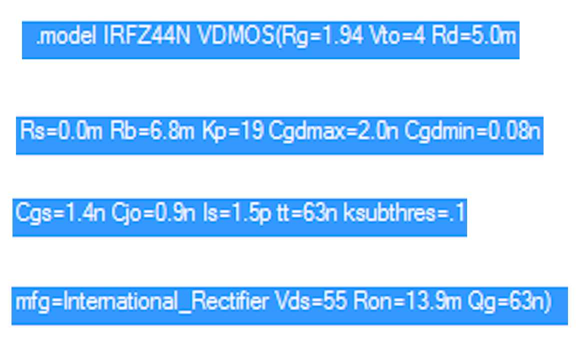

Elvee, the default LTSPICE model of the IFZ44N MOSFET has infinite output resistance; its "Early Voltage" is infinity; its gds=0. This is because the model does not include a value for the SPICE parameter "LAMBDA", so it gets LAMBDA=0, which means the I-V curves are perfectly flat at large VDS. Infinite output resistance. See image below.
This is important in your circuit because rds provides a circuit pathway for input ripple to disturb the output. In effect vout/vrippleIn is determined by a voltage divider: (rds) from input to output, and (the output impedance of M1) from output to AC ground. The default LTSPICE model sets rds=Infinity which is unrealistic, so the simulated Line Rejection is also unrealistic.
Looking down the page at other LTSPICE models of other Nchannel MOSFETs, it seems that LAMBDA=0.09 is a more typical value. In the saturation region, the LTSPICE model equations have dIds/dVds = LAMBDA. In other words, gds = LAMBDA.
So I think it would be more realistic to set LAMBDA=0.09 in the SPICE model. (You could also achieve the same thing by connecting an 0.09 Siemens conductance from drain to source, in series with a 5 millifarad capacitor for DC blocking+AC coupling). Simulated Line Rejection may still be good; or it may not. But at least the MOSFET will be more realistically modeled.

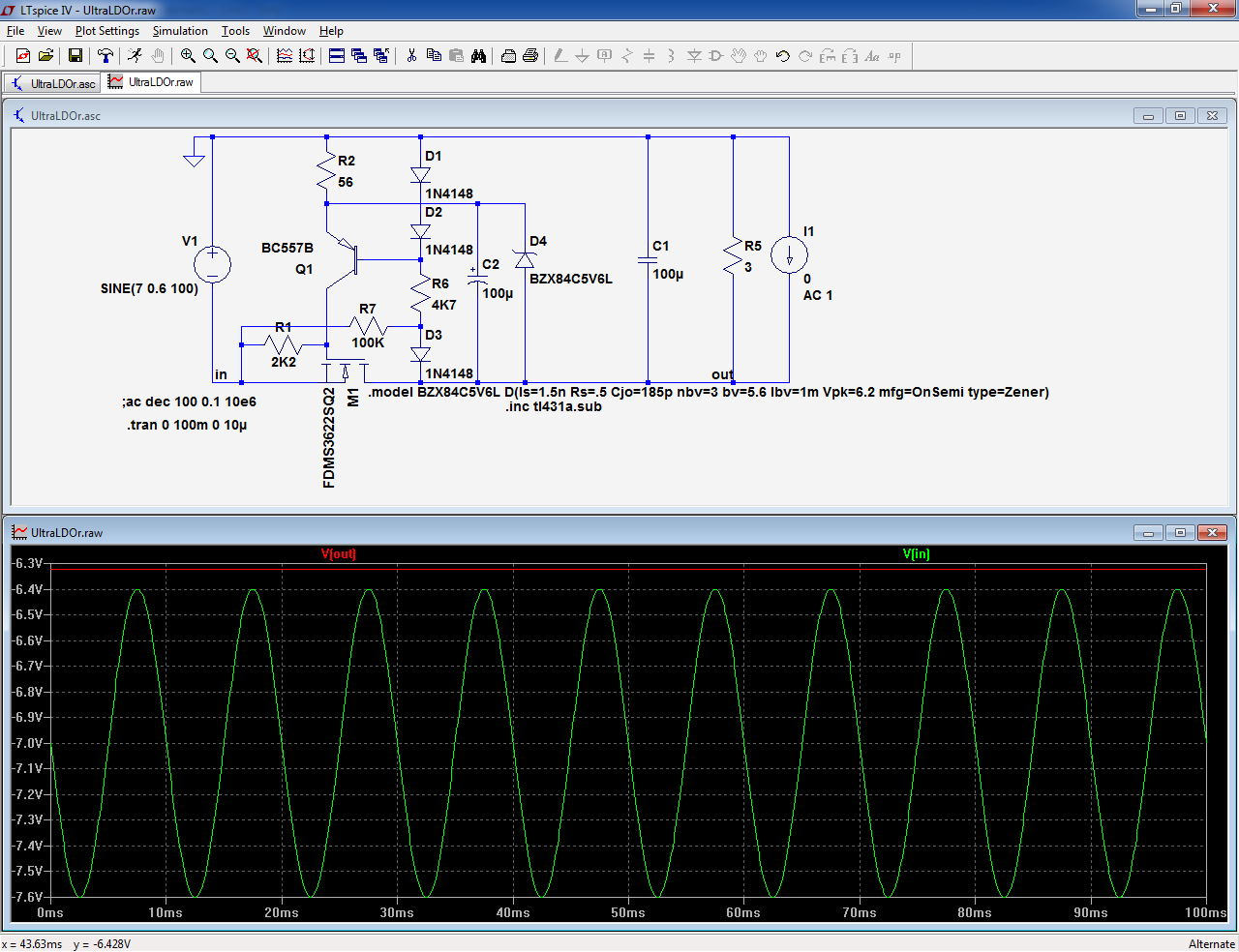

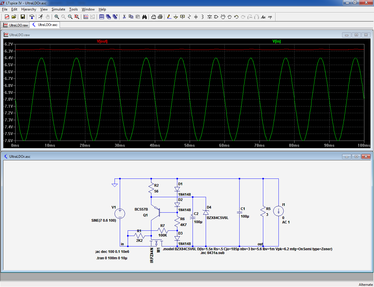

Sure, most of the MOS models are targeted towards switching applications and disregard practically everything else (even bipolars intended for linear applications have seriously questionable parameters), but here, what counts is a sufficiently low Rdson at a reasonable Vgs, and any device satisfying this condition will work properly in this application.
Some may end with 50mV of ripple and others with 500µV, but this will make no practical difference (except for true audiophiles, of course)
