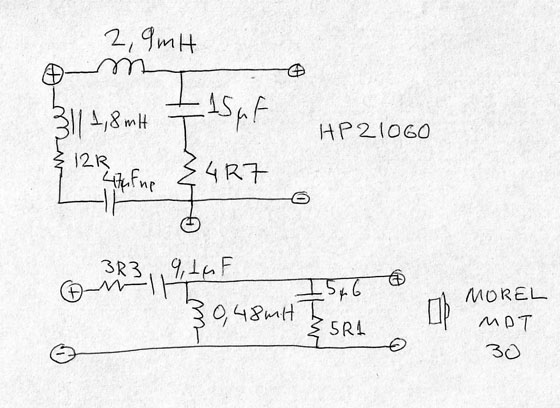

The 6,5'' is arguably a wise solution. But I always had excellent results when I used an 8'' with 1500Hz cross. The only thing is you have to combine a tweeter with 600-800Hz resonance.
That way you get the best of both worlds.
Recently I made a speaker using the smooth & inexpensive Audax HP210G0 and Morel MDT 30 (32s is the current equivalent). Very good sensitivity, bass and dispersion. Very good Zin also.
Here is the biwire cross schematic.
Regards
Nikos

Sensitive speaker
Hi Nikos,
Could you tell us some details of this speaker ? (pictures, enclosure design) I'm looking for a speaker design with good sensitivity for my tube amplifier.
Thanks,
Jim
