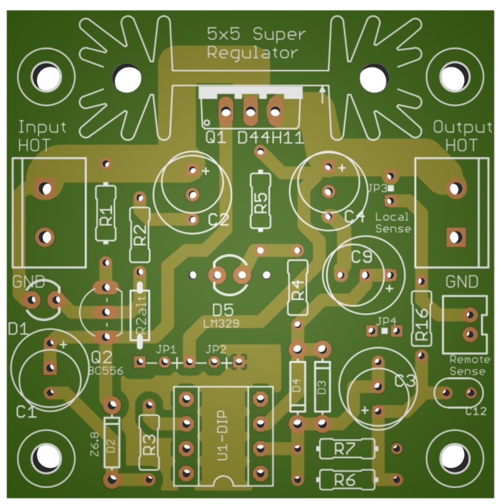

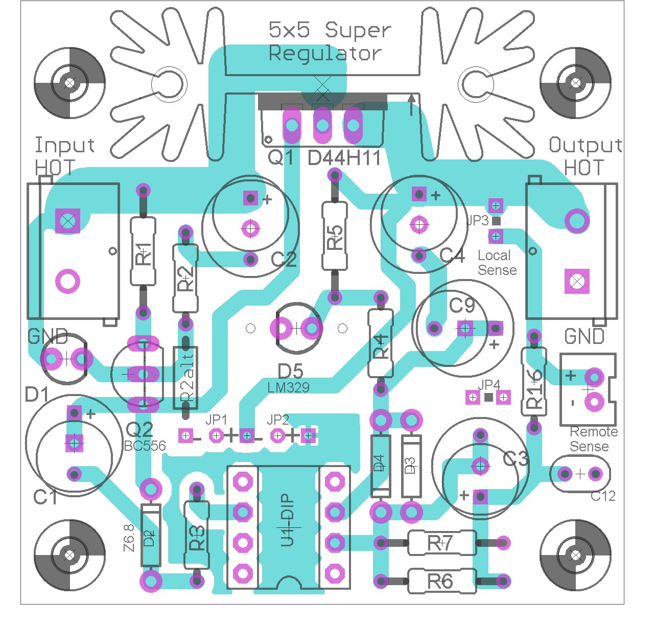

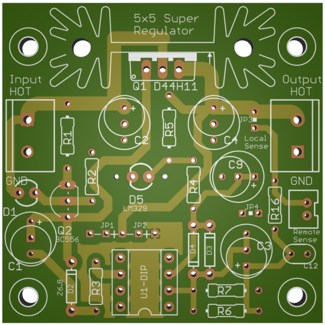

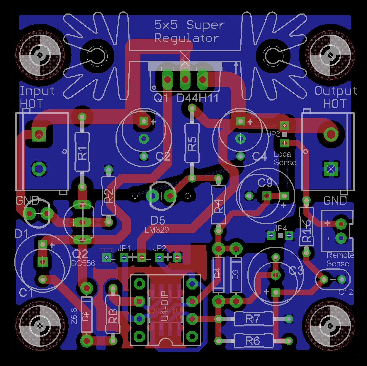

My take on board layout for Jung/Didden regulator (shematics as version V2.2)
Features:
• Universal pos/neg board on 5x5cm 2 layer board
• Multifootprint Capacitors Ls 2.5mm - 5mm
• Separate Power, Signal, Sense Ground, connected at output cap

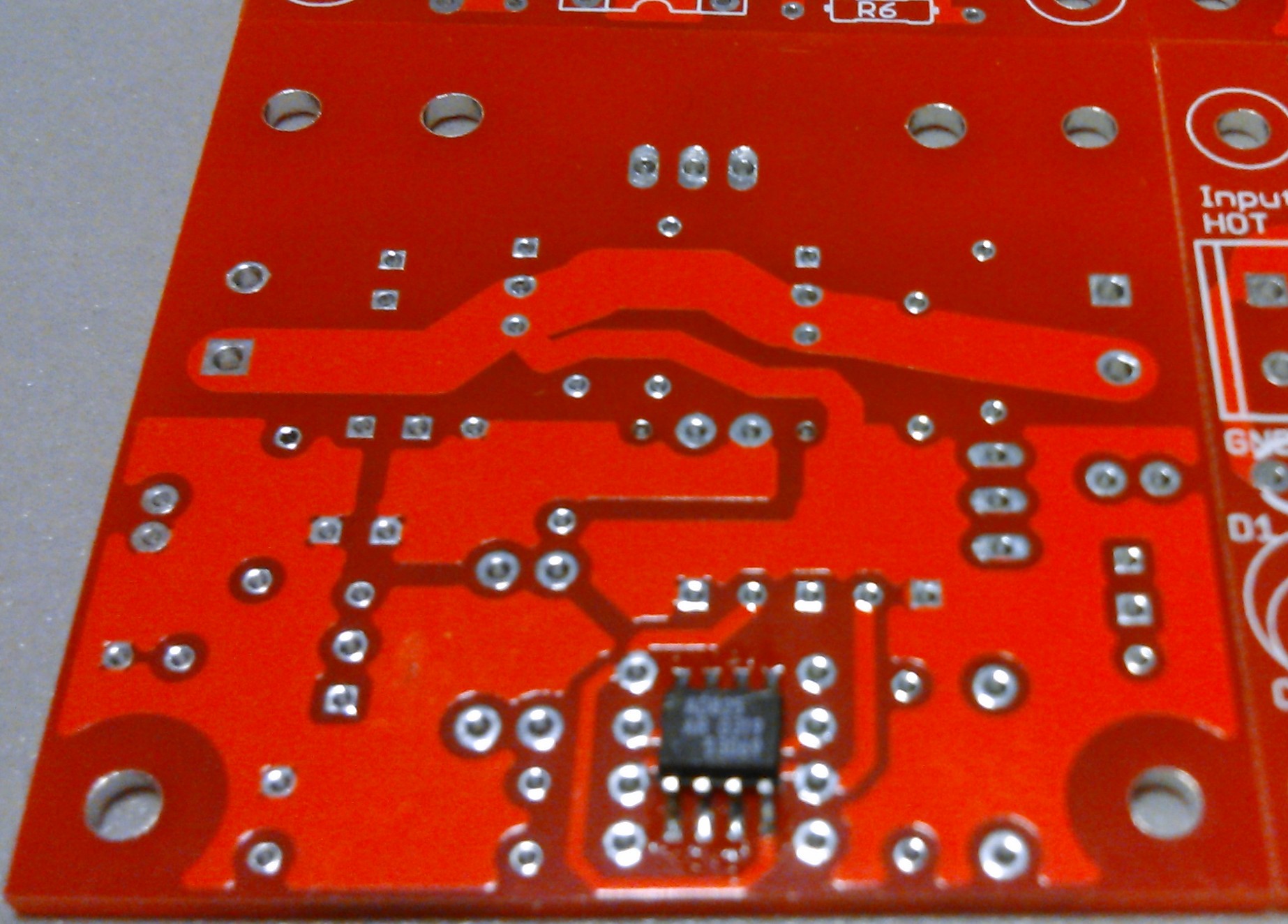

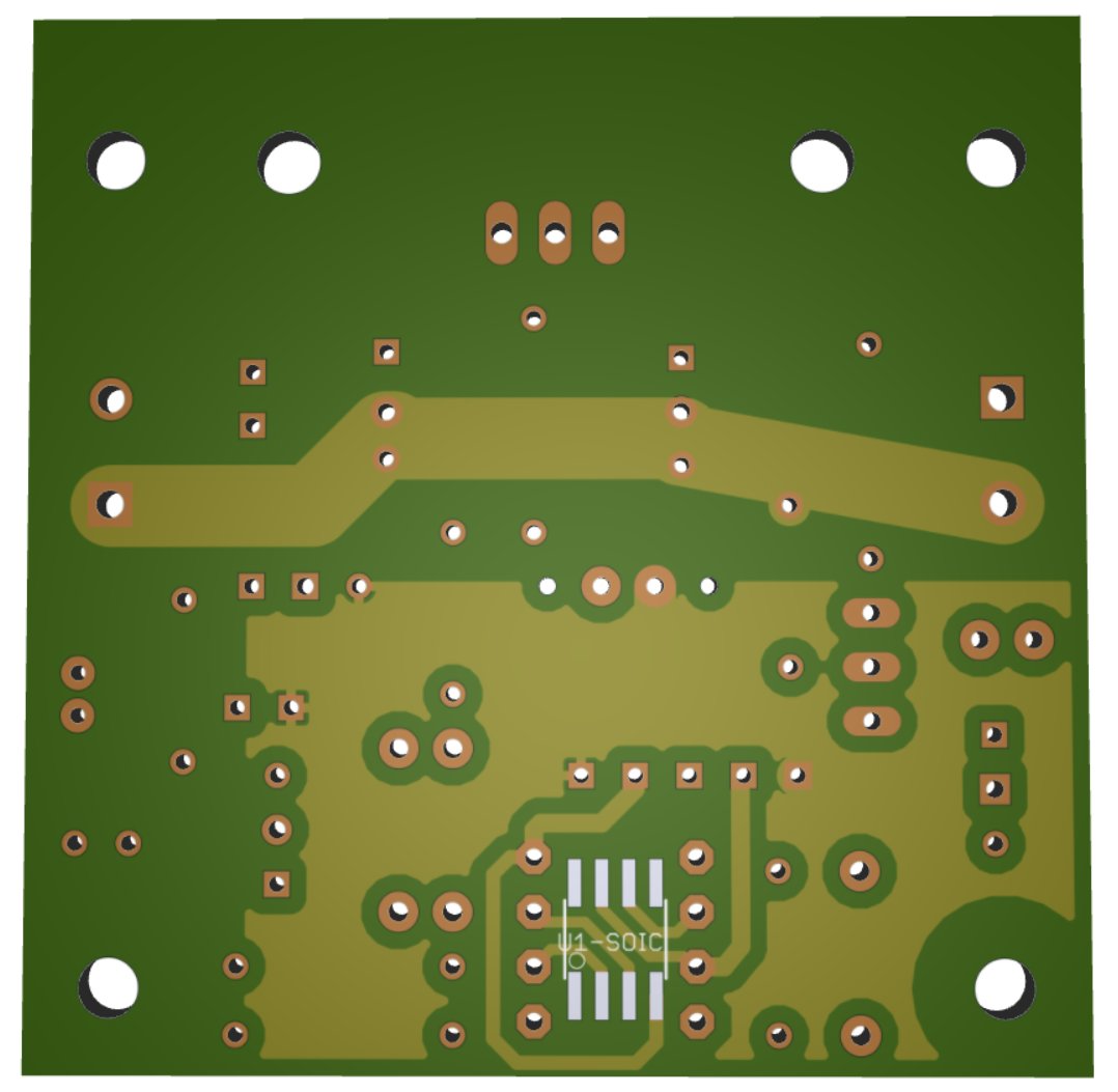

• JP1 JP2 configure board as positive/negative (switch opamp power supply pins), short - for negative board, short + for positive board
• JP3 JP4 off remote sense, on local sense

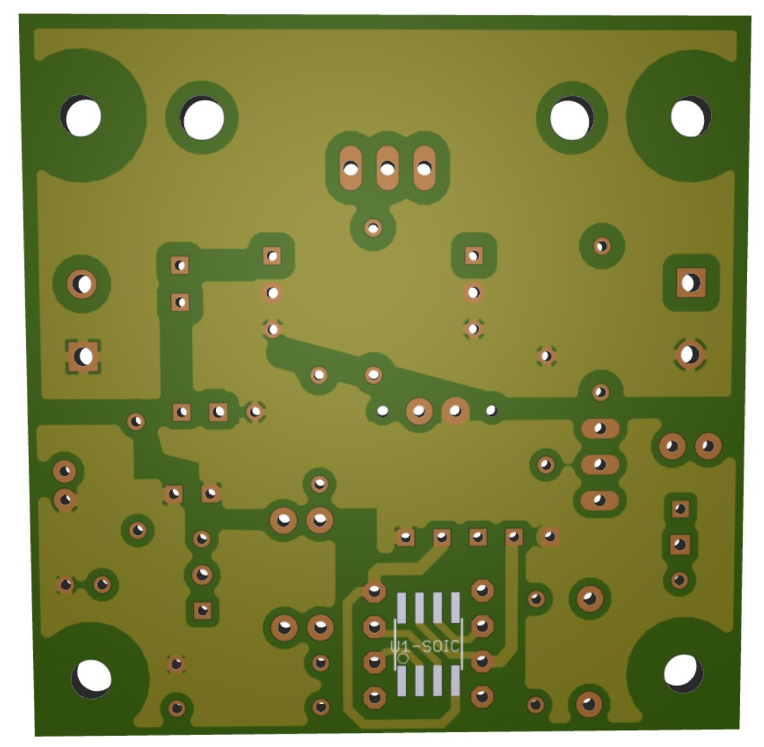

• DIP (top layer) or SOIC(bottom layer) opamp package
• Bottom mounted SOIC opamp is preffered, protected against noise with ground pours on top & bottom layer & bottom of the case
• For negative board you must reverse all polarised elements (capacitors&diodes) and use complementary transistors

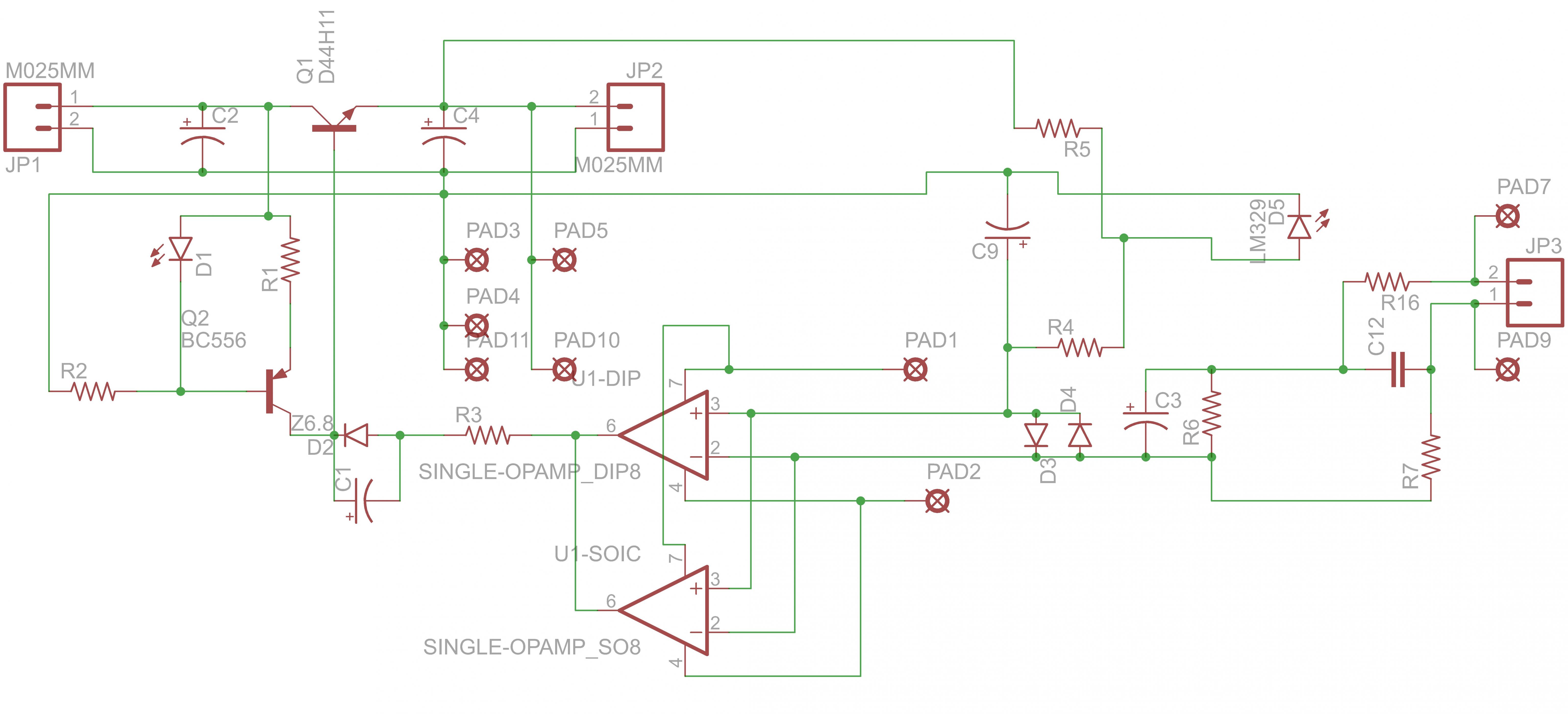

Schematics and BOM are the same as offical V2.2:
Link to Shematic&BOM: http://jandidden.com/linearaudio.nl/images/pdf/superreg_article_V2_2.pdf
Alternate link: https://drive.google.com/file/d/0BxF_x0eVgXlGY0J1dmVpakJ0Smc/view

Take a look at the original PCB's which Jan designed -- shown on post 786 of this thread:
http://www.diyaudio.com/forums/power-supplies/20937-super-regulator-collecting-facts-79.html
Don't use the ground plane for power and sense connections.
OK, thanks. May I ask why?

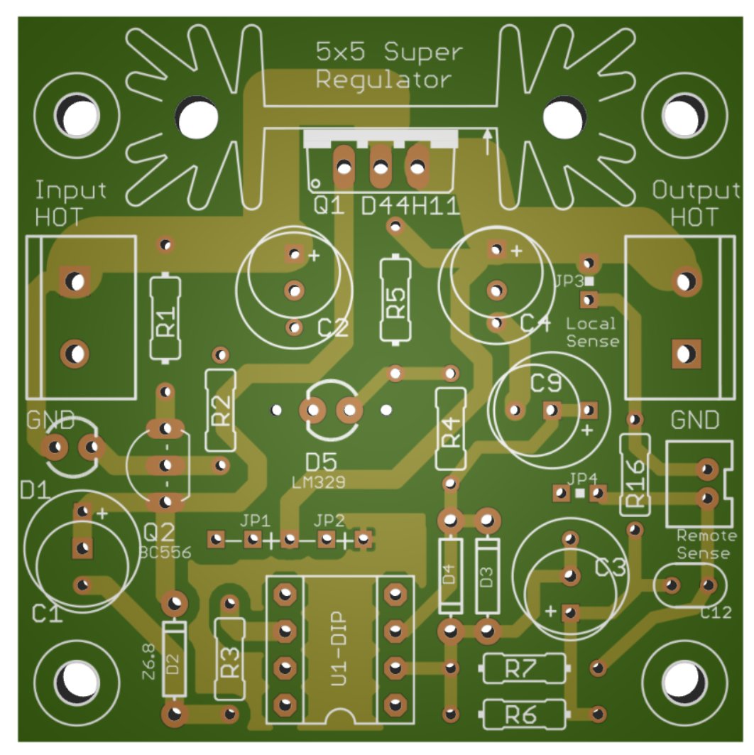

Better?
Refrain from placing the ground plane underneath the heatsink of the pass transistor.
Jack, what's the concern?

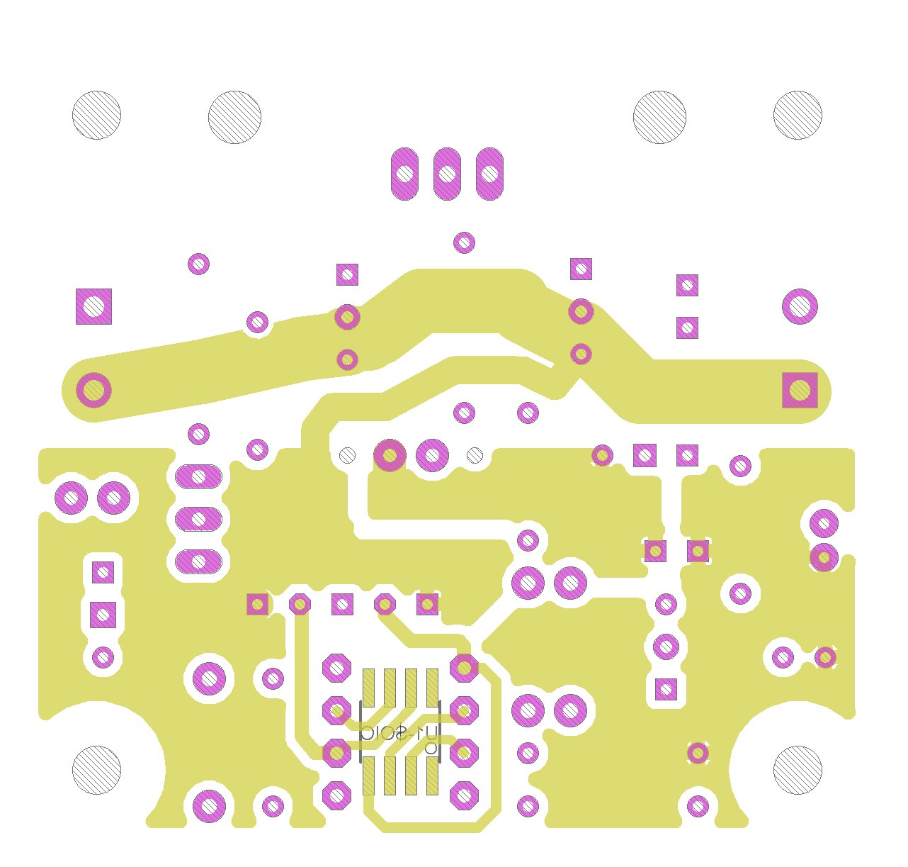

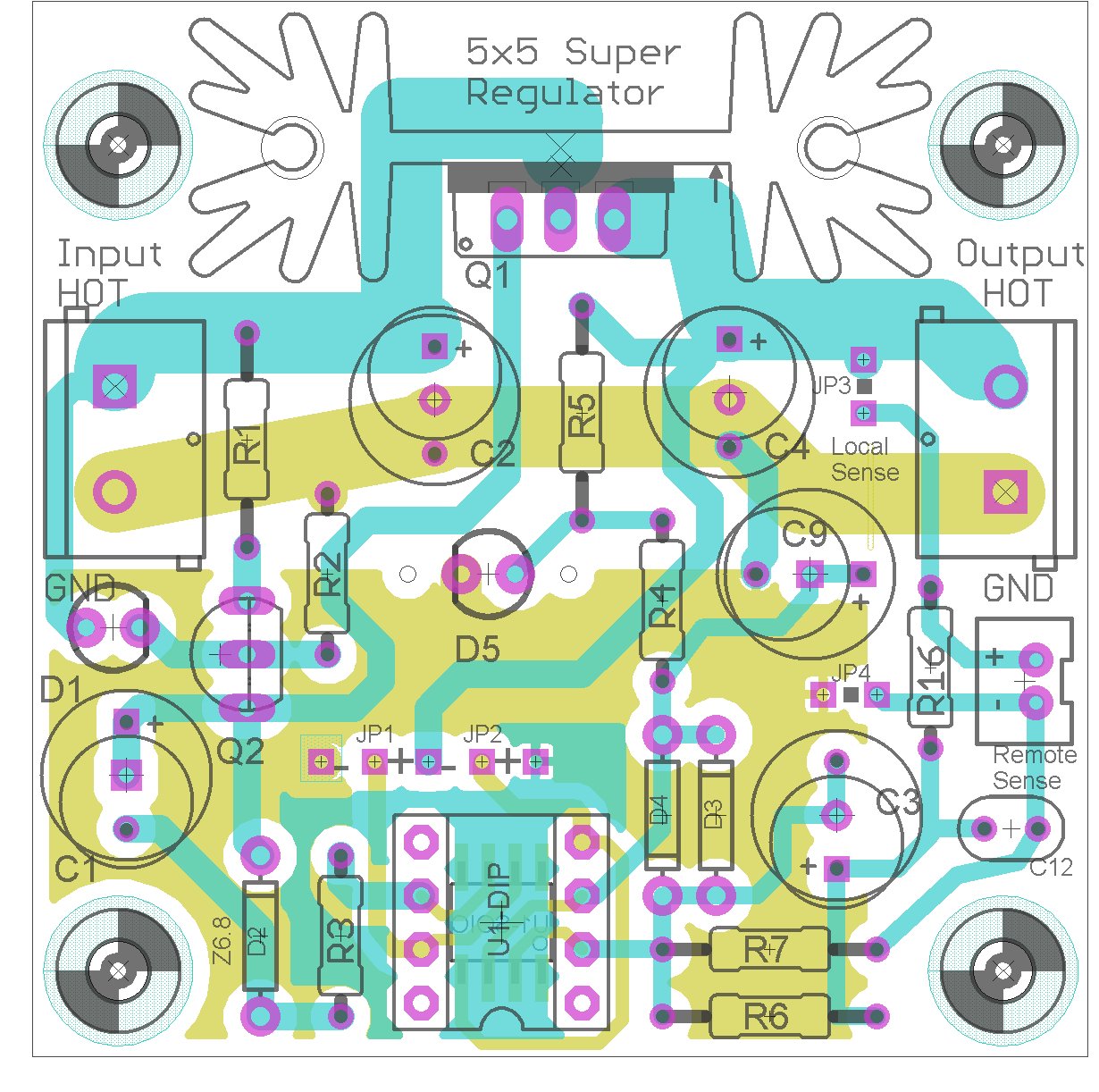

Underneath the heatsink, this is not ground plane, this is input and output Voltage traces.
Ground traces/pours are on the bottom layer.
Power gnd trace (line) and signal gnd( pour around SOIC opamp), they are connected on top layer with trace between C4 and C9 - pins.

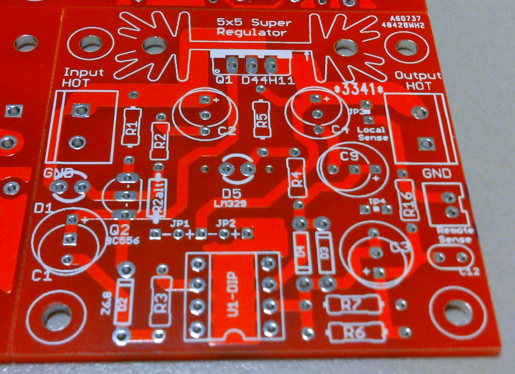

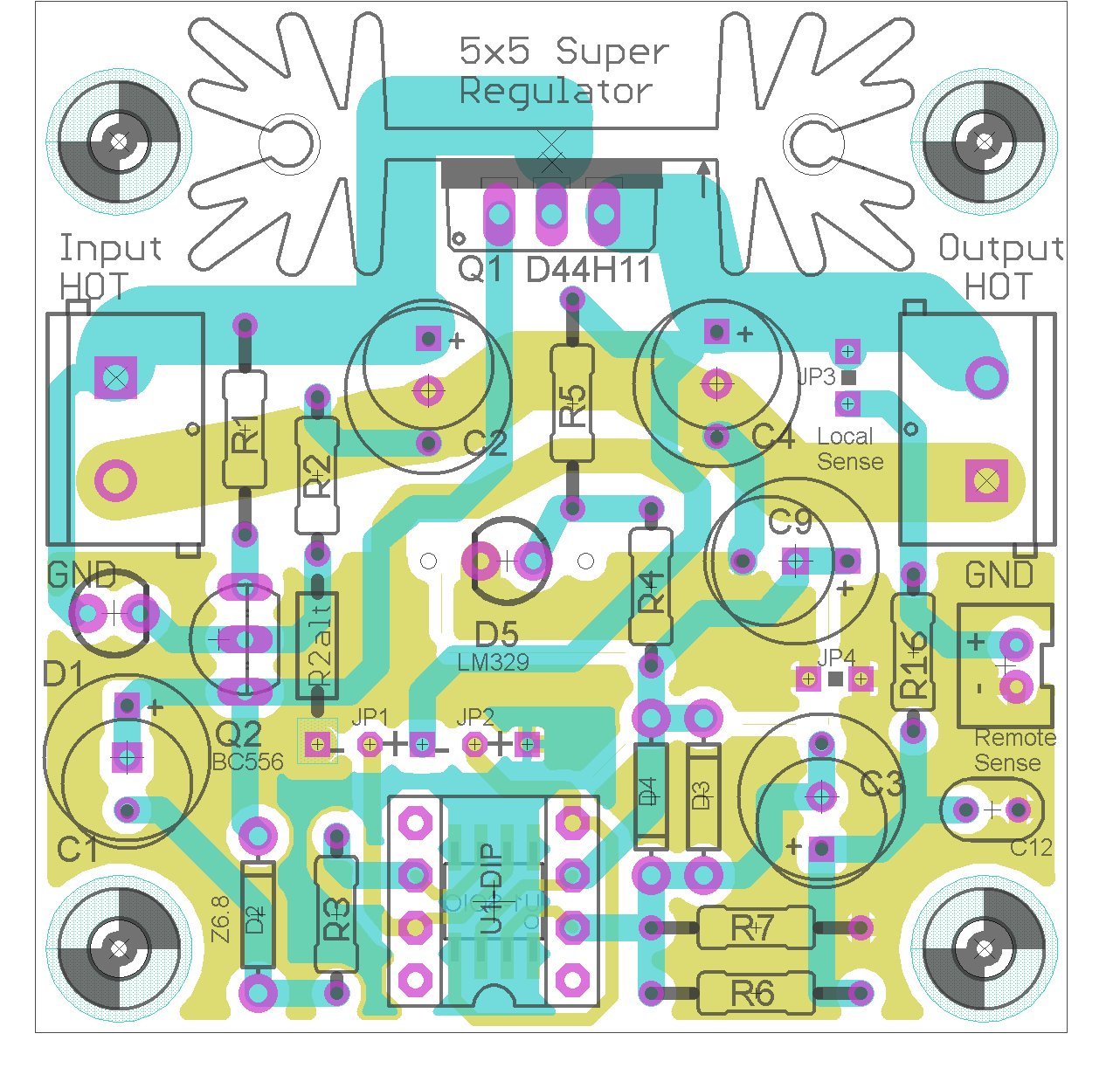

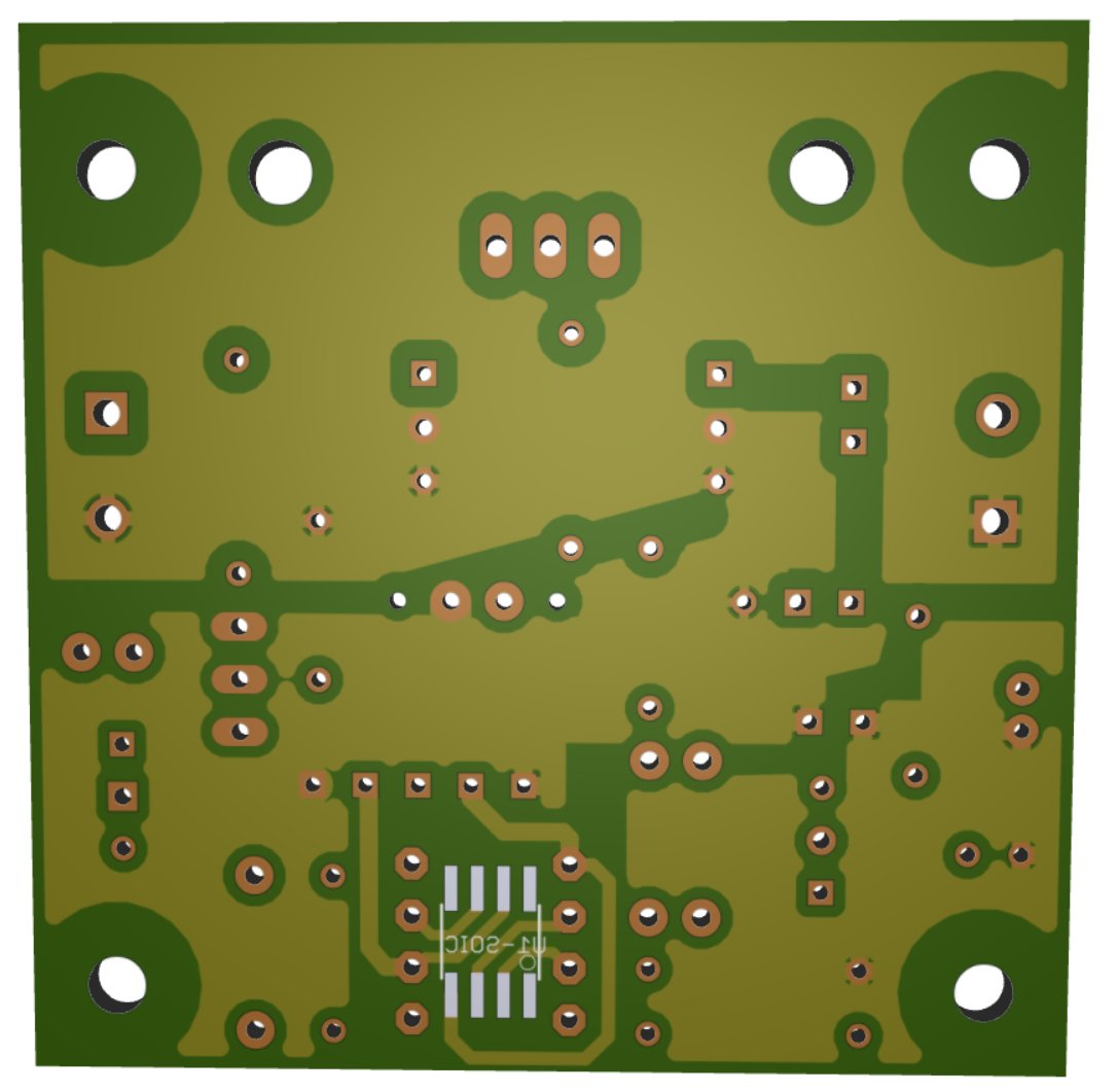

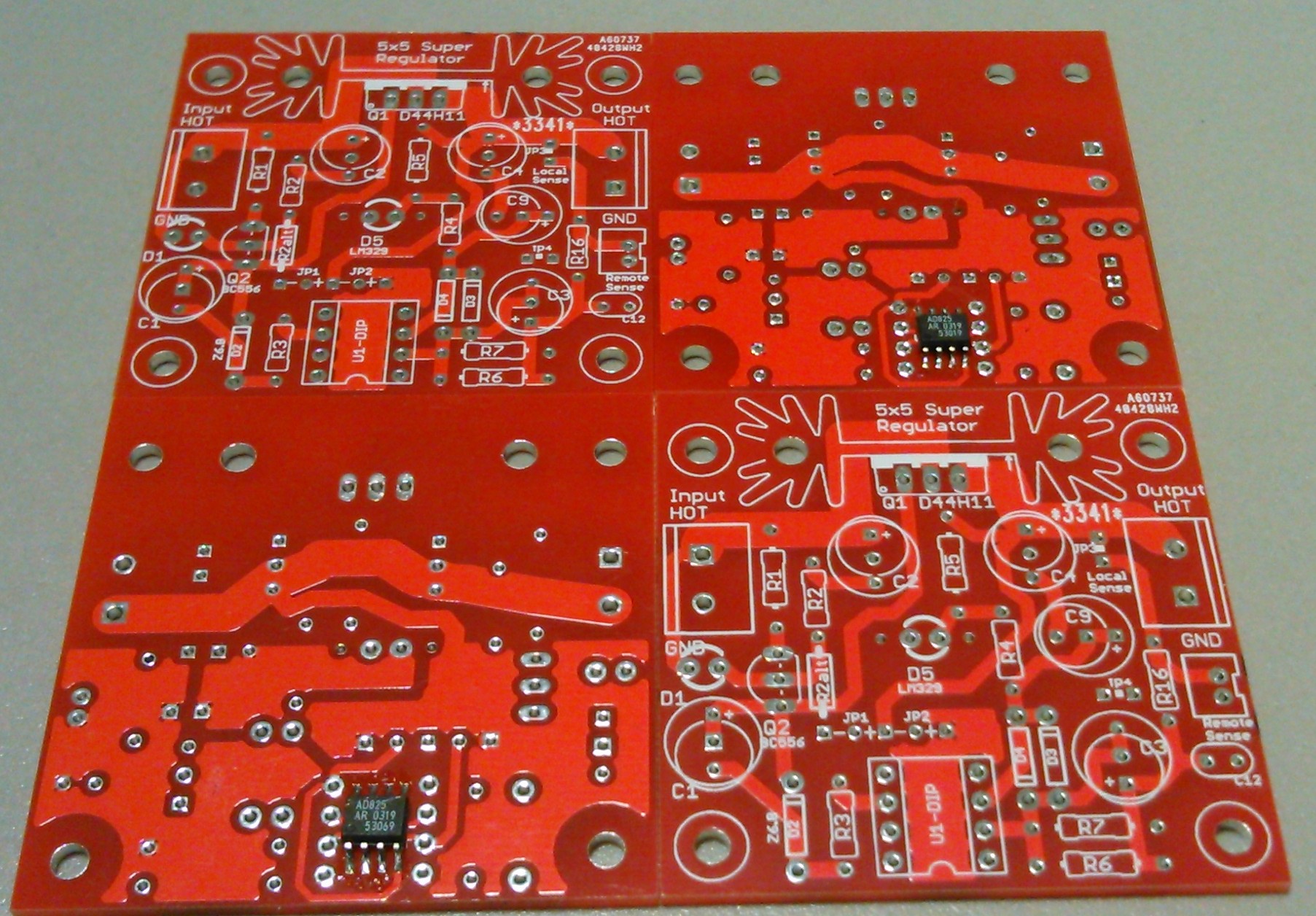

Final version
I will post gerber for this PCB to DirtyPCBs.com
- Separated opamp supply ground & voltage reference ground (C9, D5)
- All grounds star connected on output cap ground pin
- Current source ground (R2) have option to connect to input cap ground pin or output cap ground pin

Hi Andrew,
yes I order every board I posted on DirtyPCBs. I didn’t fill this board with components so I am not 100% sure it is working but I have plan to do it, I have board and all components but need time & welding spirit . I checked another board from DirtyPCBs (also mine) and it works flawlessly.
As for the general quality of DirtyPCBs check this link:
i/o blog: DirtyPCBs two layer ENIG PCB closeups
My opinion is, errors are possible, more or less, only on my design side, manufacturing is pretty good.

Choose for Yourself. 😀 (Schematics from Eagle included - please check if I made some mistake)
Alternate link: https://drive.google.com/file/d/0BxF_x0eVgXlGY0J1dmVpakJ0Smc/view?usp=sharing
The links work now and I have made an order. Compared to Andrew T's boards, there is no floating pre-regulator which really helps and I may add these.
However, the board sizes are better although the pass transistor cannot be mounted as is on a metal chasis. The heat sinks shown are inadequate for higher current to 2A.
