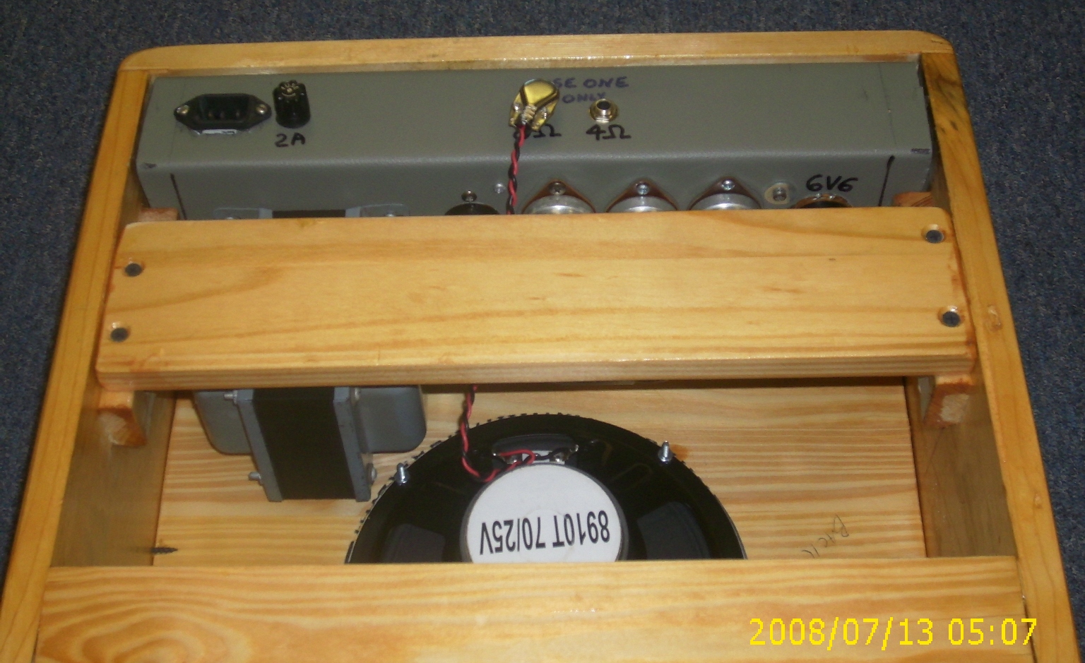

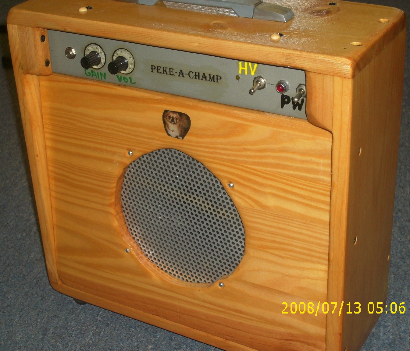

You have pictures of the amp?

Sorry, no pics. I was showing this one off and a fella made me an offer I couldn't refuse, and sold it -- He's happy and I have some funds for my next amp idea! (I have two others of this style design that I use regularily - thus, I was willing to part with this one!)

and next time pictures please
we all know we want to see them😛
