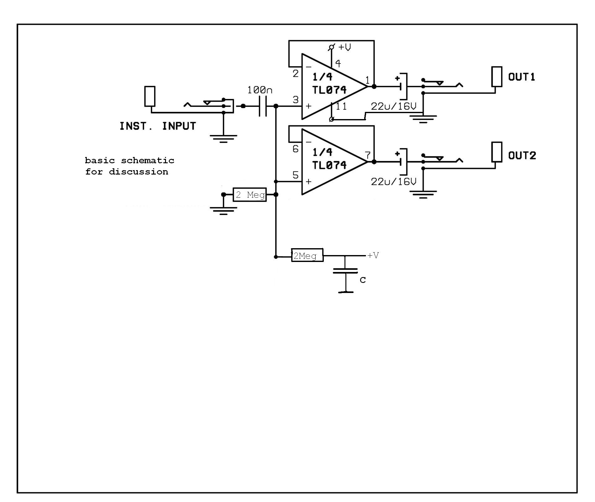

Greetings,
I am new to this site and DIY electronics in general so please be gentle.
I need to split the input from an electric instrument into 2 outputs to effectively send down 2 effects channels and finally to 2 separate amplifiers. I found a schematic (attached) which I think does what I want to do. However, I only have 5v to play with and the TL074 seems to require 6 minimum and I suspect that is +/-6.
All I have to work with is +5v, Ground, and the instrument input. I think I know how to create +/-2.5 from the 5v.
So my questions are:
  1. Is there a good op amp that will operate at +/- 2.5?
  2. If I remove the "Loop Through" from the schematic, replace the TC074 with something that runs +/-2.5v will this work?
  3. Am I correct in assuming that if I put +5 on the v+ and ground on the v- I am effectively getting +/-2.5?

Your answers are: 1 yes, 2 no, 3 no.
The longer answer is that it would work if the circuit was changed.
Can you say why +5V is a must? 9V battery not even an option? Maybe understanding that will help.

......imho you dont need a split supply, there are dc-blocking caps in the signal path (100nF, 22uF).
you need 2 or 4 outputs? ;
the simple solution is a split cable (Y), both the same lenght and material.......

You said to assume active, that there would be a pedal in between the instrument and the splitter. If so a passive Y splitter will do the job.
If you insist on making an active splitter and need it to accept pedal outputs, 5V simply will not do the job. You can buy a DC-DC boost converter on Ebay or Aliexpress to give you a higher voltage to work with.

TL074 will NOT work freom single +5V supply.
Old school solutions which I have personally used (being an .... ahem! .... "old" school guy 😉 myself ) :
1) much despised by audiophiles LM358 will work perfectly well in the circuit above, being DESIGNED for single +5V supply operation.
Admittedly expecting some data or instrumentation to be fed to 5V powered digital stuff, but *does* work with Audio and unity gain buffer is the easiest application., it will do.
That said, search for a modern equivalent, ask Mr Google 🙂
2) make 2 single transistor emitter followers.
Bias: single 1M resistor from base to +5V for both.
Collectors to +5V
Emitters to ground through 4k7 resistors, audio out from each through 1uF electrolytics.
Use BC547C or similar.
