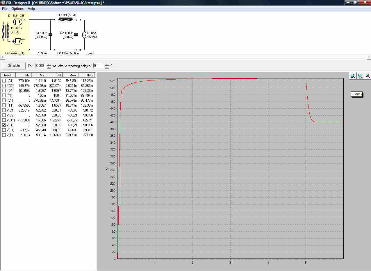

I worked through the calculations and have a fairly good understanding of the amp schematic. However, I have one question on the power supply schematic. I have completed the wiring and tested the output voltage. The voltage is from the 5U4-GB is 412VDC. When I connect the filter section the voltage out is 564VDC. Is this correct? The schematic has 400VDC after the circuit. I get the same voltage result if I use the CT of the transformer or as the schematic shows for the 5U4-GB.
Unless you o'scope, you can't trust the voltage reading from the raw output of the FWR, as it's not sinusoidal.
As for the rest, it looks reasonable. Unloaded, you can expect a DC voltage equal to the peak of the AC going in. If you're looking to get 400Vdc under load conditions, then 564Vdc unloaded looks about right. The 5U4GB has a forward voltage of ~100Vdc for an Isurge= 800mA (80% of maximum Isurge per plate).
You probably lose most of the remaining 64Vdc across ripple chokes.
Thank you euro21. I have downloaded the PSU designer but find it a bit confusing to use. Anyway, I have completed the wiring and under load the voltage is at 412. All is working but need to find where the awful hum is coming from.
