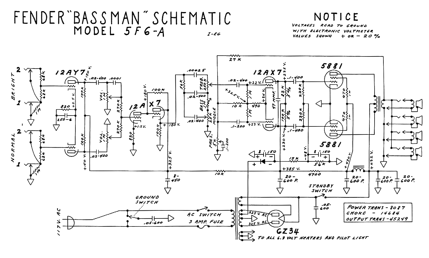

Since you made up the wiring - as opposed to wiring it like a Fender - any chance one or more of the preamp tubes share a ground with a filter cap for other stages?
The fact disconnecting teh NFB makes it better, connecting the NFB makes the thing a bog oscillator. Perhaps your output transformer is wired "Backwards. In other words exchange the brown and blow wires to the power tube plates. (Or whatever color if your OT is not standard colors for USA.)
From your description, I get a picture of an amp going unstable and "motorboating". That can come from ground separations, it can come from wrong phase NFB.
Schematic, is it the same as the 5F6?
Layout?
If there is a decoupling issue between the output stage and the driver/pre amp, this will cause your issue, as will layout errors and the wrong value choke.
NFB wired out of phase can be an issue but tends to be a higher frequency oscillation.

How should I go about testing a decoupling issue between driver/pre and power amp? This sounds interesting. All of the coupling caps are new.

The very low oscillation frequency, combined with your observations about the choke, strongly suggest the oscillations are caused by the way the amp interacts with the power supply rails. It's motorboating, in other words.
As has already been suggested, make sure B+ is properly filtered and decoupled at least every two gain stages. Also look into your grounding scheme - make sure input stage grounds don't share long wire runs with the ground wires from output valves or speaker.
I wonder if wiring a suitable power resistor in parallel with the choke will help. (The choke, along with the B+ filter caps, can cause the power supply rail to "ring" in response to a transient, such as the spike in output valve current each time you pick a guitar string. It seems your amp is currently so sensitive to this that it causes outright oscillation.)
-Gnobuddy

Yes, the pic is a schem.

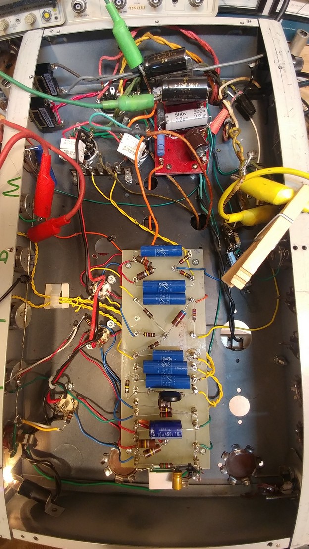

THIS IS WHAT HAS BEEN ISOLATED:
  1. Issue stops when V1 coupling cap is removed. This amp only uses one input and 1/2 AY7, so please disregard the second V1 coupling cap.
  2. When V1 tube is removed, the issue can still be triggered using a sig gen on V2a grid resistor.
  3. V1 Coupling cap and P.S. must be coupled together to cause issue.
  4. At V1, Cap without P.S., and P.S. without Cap have been tried. No benefit.
  5. A different Coupling cap has been installed, with better fit against the chassis. No change.
An explanation for the "mess of discovery" seen inside the amp! All changes have been made AFTER amp displayed exact same issue.
The yellow jumper, top right connects the new OT secondary lead to output jack. Pri side leads are Ape Hangers right now!
The black F+T caps are soldered in parallel with original IC's, as well as the brown radial who is sleeping.
Green jumper, top right shorts Choke. Yes, choke is in a weird place with lines that run parallel to main ground, which is also disturbingly long, and bias supply (middle right under clothes-pin).
Red jumper, left side connects TS to ground. At one point I was removing all variables.
