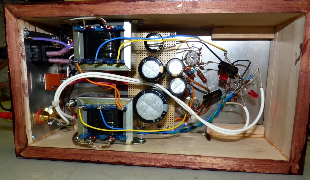

I wanted to make a stereo SE amp as small as possible. I had a few 5CZ5 and 5BQ7A that I decided to use. I used a dropping resistor for the heaters, but it would be easier to use the 6CZ5 and 6BQ7A. The 6CZ5 are $7, the 5CZ5s are $3 at esrcvacuumtubes.com. The 6BQ7A are the same price, $3, as the 5BQ7A.
I don't think I could construct it to be much more compact than it is. The amp sounds very good. Less than 1mV of hum on the speaker terminals. I would guess it's about 5W per channel. I am very surprised with the response of Edcor XSE10-8-5K output xfmrs. Never used them before. Not too bad. The Antek toroid looks pretty good with the steel cover also.

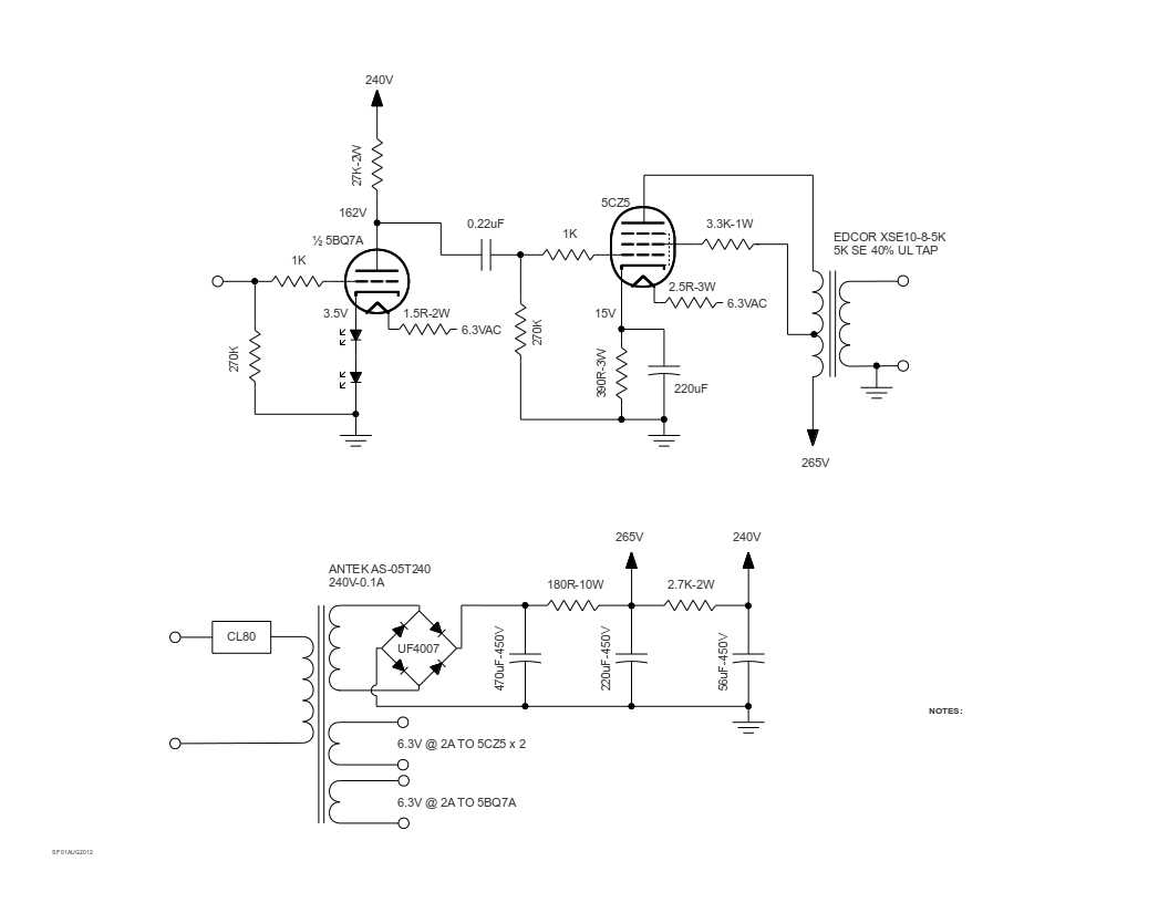

I used a CL80 thermistor for the inrush current limiter because that's what I had. I think the CL120 may be more appropriate for this design.
This amp can be built for about $140, buying all the parts new, not including the chassis. I used some funky trim material I found at HDepot and a piece of scrap aluminum.

Nice little amp! you can by-pass the UF4007's with inexpensive low value film capacitors (use one for each diode) to help smooth the edges off the ripple. Better yet source a choke to get get the last of that hum.
Thanks. Ha! I don't think I could fit a choke in that box!
My loudspeakers are 97dB and I can't hear a thing. The amp is dead silent.
I am interested in the bypass caps for the bridge though. What would you suggest? 0.01uF?

FYI. The red LEDs that I used are just standard devices I had around and matched to achieve a 3.5V drop.

Besides that the heater voltage for 5CZ5 is 4.7V. The heater voltage for 5BQ7A is 5.6V.

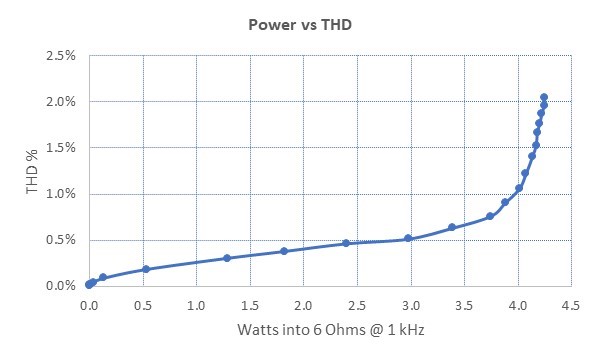

Better test gear and improved technique gives more accurate and (in this case!) better results. The chart shows THD% vs output from the 6CZ5 into a 6 ohm load via a Softone RW-20 output transformer (presents a load of 5kOhm to the 6CZ5). The 6CZ5 is driven by the 6AH9 Kimmel-Mu drive/gain stage via RC coupling.
I think I'd call it a 4 watt amp: distortion rises fairly proportionally to 1% at 4 Watts. After that, all bets are off.
At 1 watt, measured bandwidth is 55Hz to 21kHz (-1dB) and 31Hz to 40kHz (-3dB).
Measured output impedance is 8 Ohms 40Hz to 20 kHz.
And it still sounds good on high efficiency speakers. 🙂
