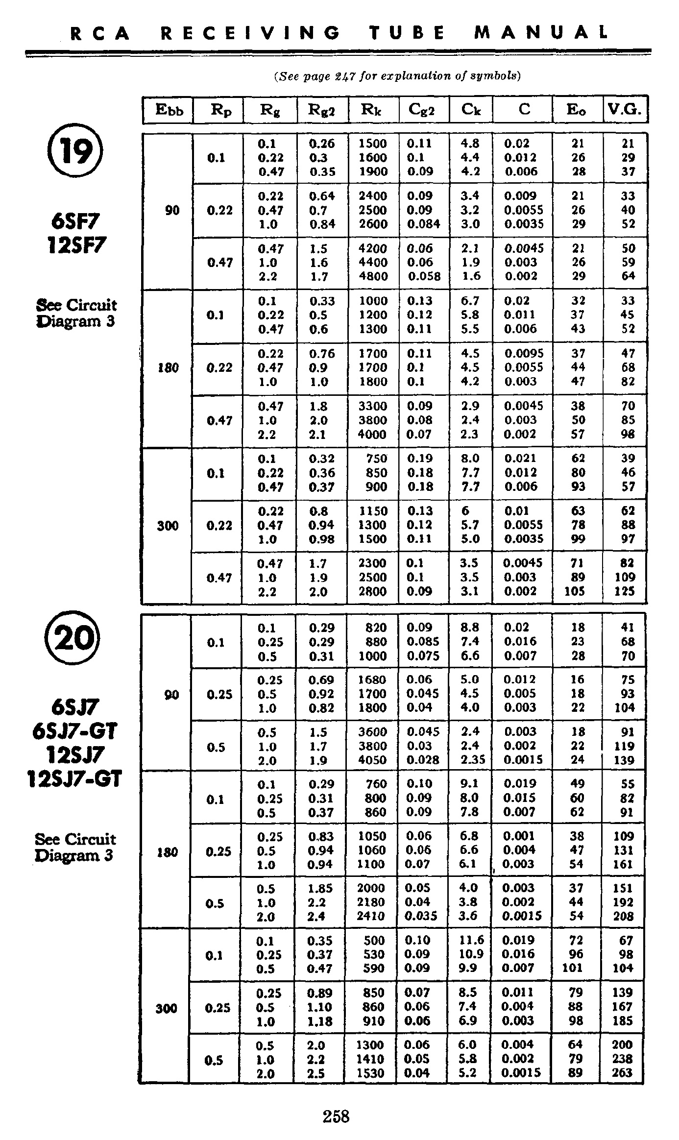

Both the anode voltage and the screen grid voltage of the 6SJ7 are too high, which means the 6SJ7 is hardly passing current.
Looking at the data for the 6SJ7 from one of the RCA Receiving Tube Manuals, I think that the value of the cathode resistor is too high, and the value of the screen grid resistor too low. The cathode resistor should be something like 900 Ohm (but either 820 or 1K will do) and the screen grid resistor should be something like 870K (but 820K will do).
If changing these resistors doesn't help (enough) than probably your 6SJ7 is at the end of its life.

Thanks for your reply 😀 , I suspected the voltages were to high but was unsure how to fix it.
I have made the changes you recommended but used an 820k on the grid, and it is much better the caps were burning in at first but it's starting to sound good at mid volumes now. At full volume it breaks up nicely but when a heavy bass note is struck there is some unwanted rattling and some brittle sounding high tones in the back ground if you hold the note. It's coming from the speaker (not the cab) and is separate to the guitar sound.
