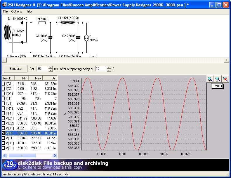

I have D3a->300B based DRD amps with a woefully inadequate power supply. It is RCLC where the first cap is 10u, the second cap is 250u, the resistor is 30R and the choke is 15H/400R. It uses solid state rectifiers. B+ is about 540V, and unfortunately there is not a lot of headroom in the power transformer.
In an attempt to get the last bit of hum out of the circuit, I though I might work a regulator of some sort in there. Any ideas for something that will work at this voltage and not drop a lot of volts? Would it be ridiculous to try to work a LM317 in there? I'd be within the 37V in to out voltage, but I am not sure of any absolute voltage limitations. Maybe an LR8 with a pass transistor instead? Ideas?

My first thought is to use a cap multiplier, rather than a regulator.
If you can give up absolute voltage regulation, and only use the active device for AC reduction, you can live with significantly lower voltage drop.

What would be the max acceptable drop?
I too think that you'd do well with a gyrator/cap multiplier type circuit. You could get a lot of filtering this way.

Thanks for the suggestions. Here's what the current supply looks like. Because of the Ultrapath output cap, the ripple is being multiplied by the mu of the 300B (~4) which is too high overall. However, it looks like just increasing that 10u cap to 30u or 40u will bring this into a reasonable range. So, that seems like the easy first step.
