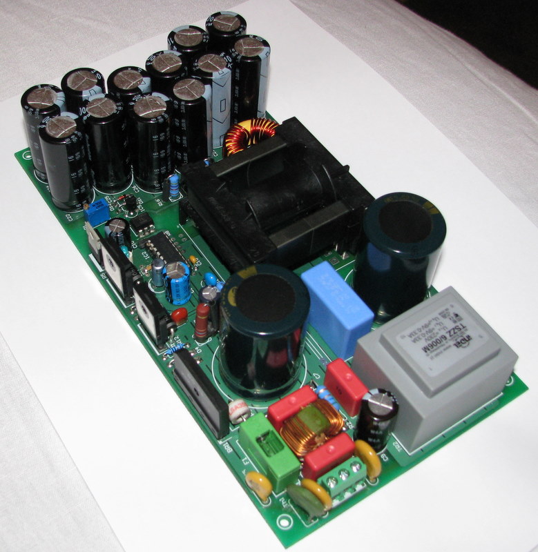

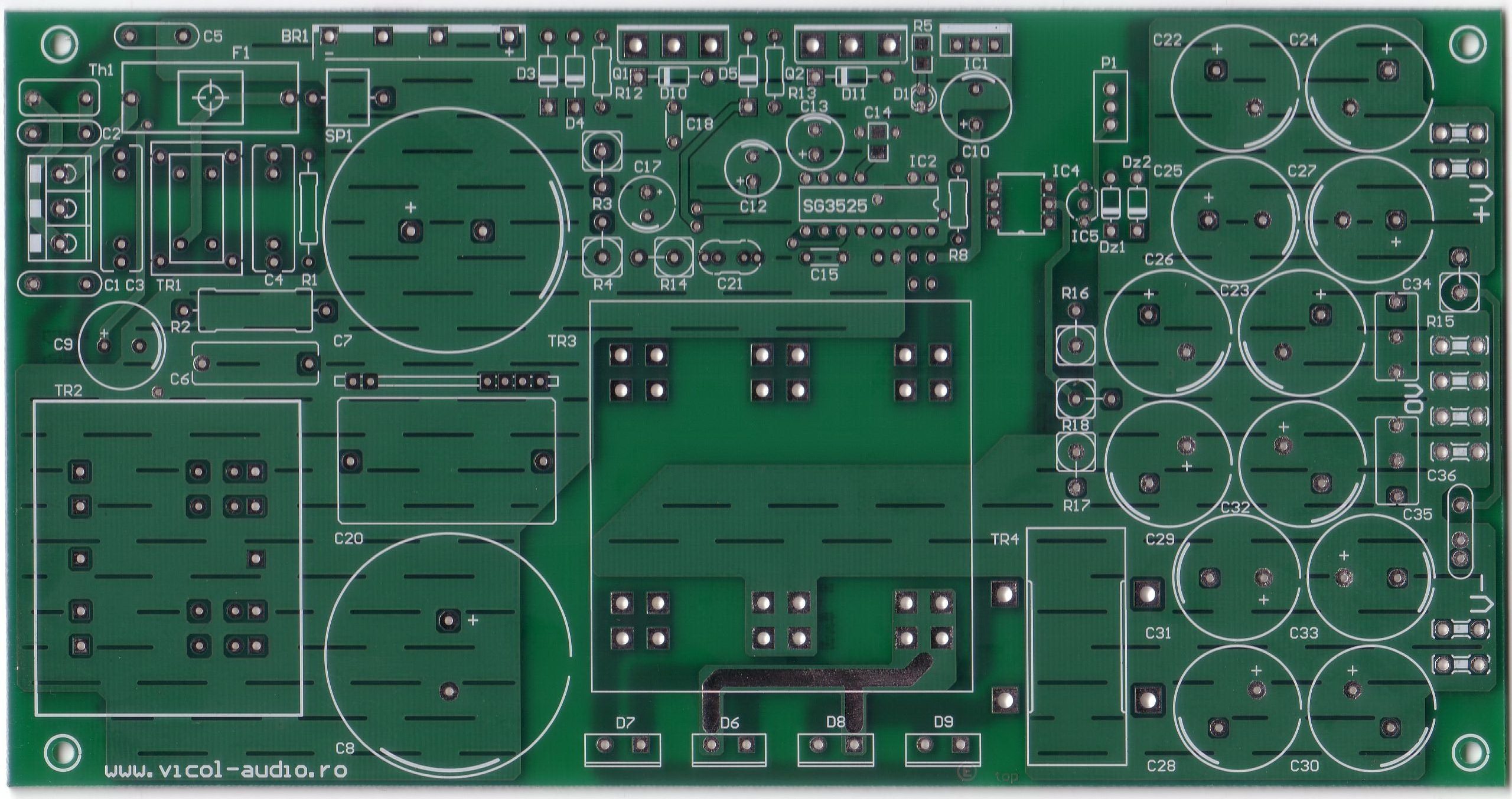

The photos don't match the schematic. (TR2/TR3 interchanged, diodes marked D104-D107 in the schematic and D7-D9 on the board).
Is the board in the photos a later revision ?

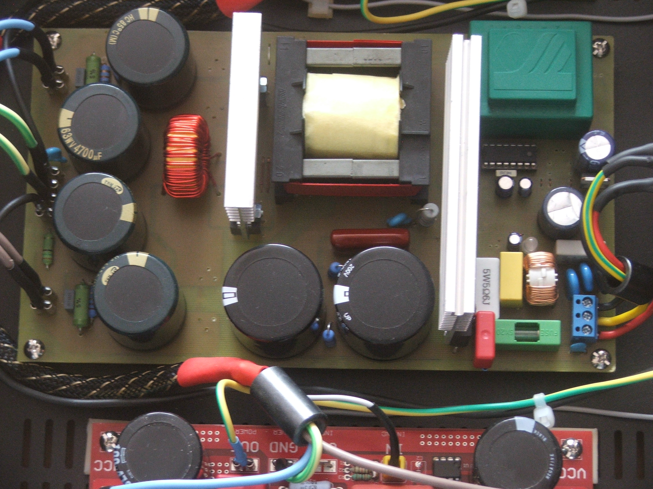

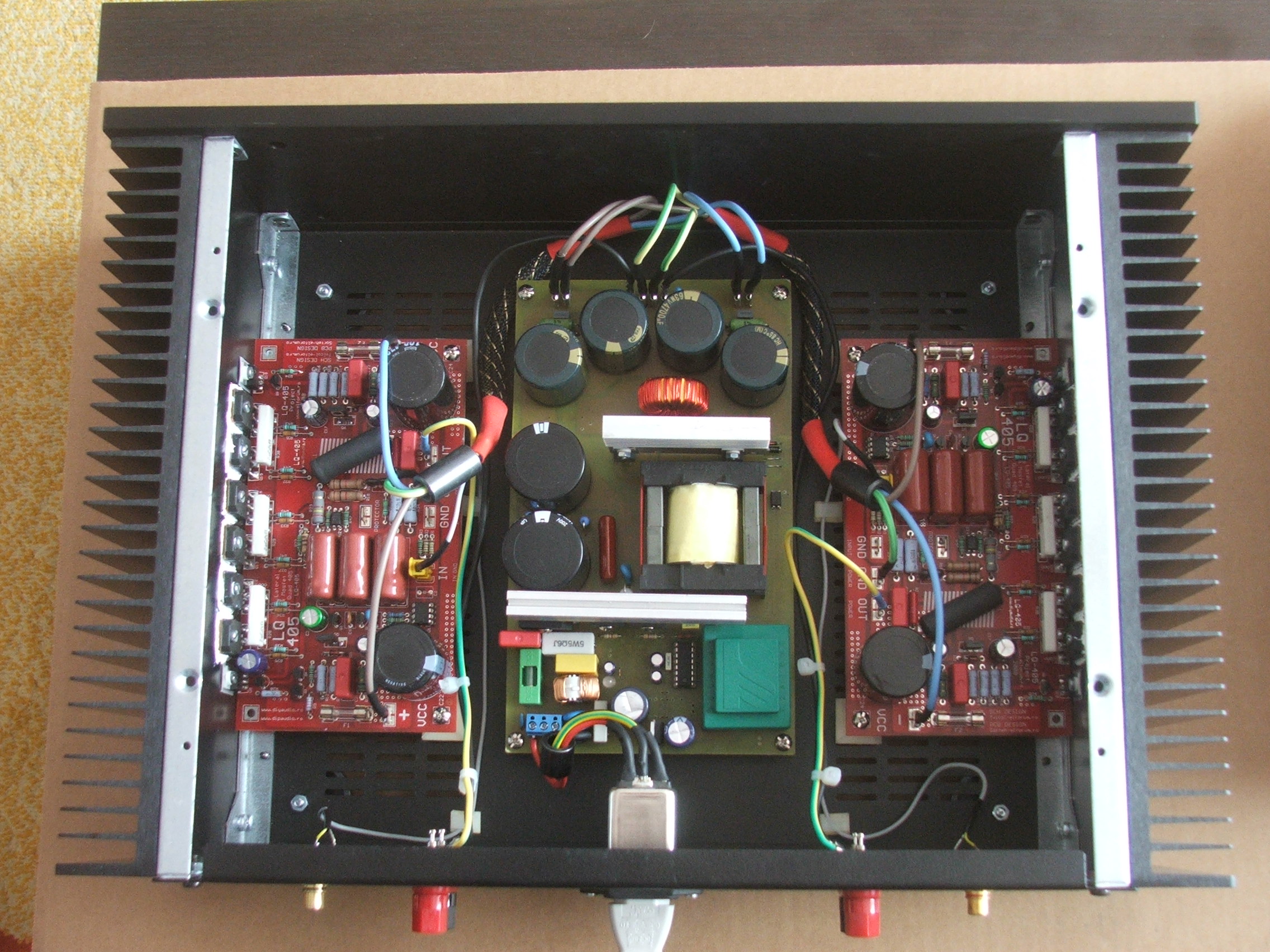

The SMPS was initially designed to power QUASAR modules.
Some people have used these SMPS for other class AB amplifiers as well, with excellent results.
In the first version of this SMPS we have added a module protection as an optional board.
We'll keep the same in the future.
As long this is not a kit, you are free to change output voltages up to your needs. So, voltage ability is up to the builder.
Related thread is here http://www.elforum.ro/viewtopic.php?f=41&t=34816
At the end of this thread you'll see many finished SMPS by various folks.
pjp,
The schematic presented on vicol-audio is latest version. Presented PCB will not match this schematic.
We are going to make several major changes on PCB layout.
The main change is to achieve a better layout grounding between SG3525; IR2110 ground and choppers ground.
Tibi

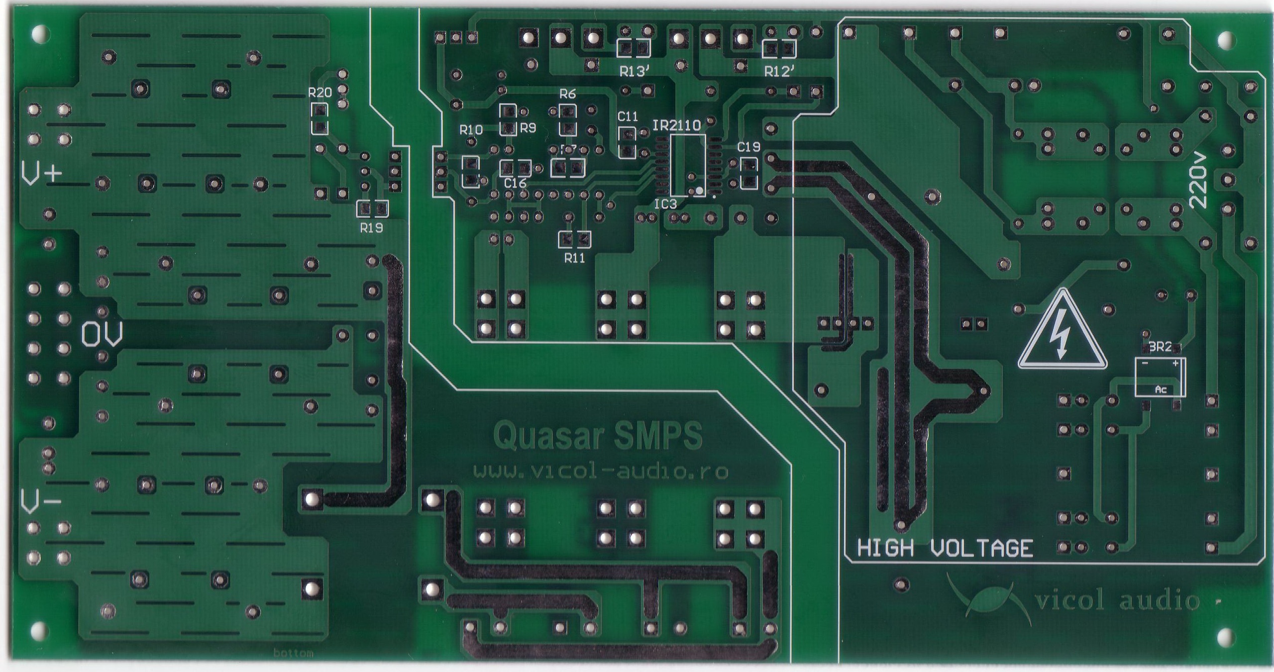

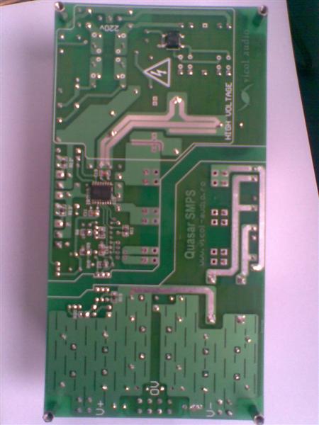

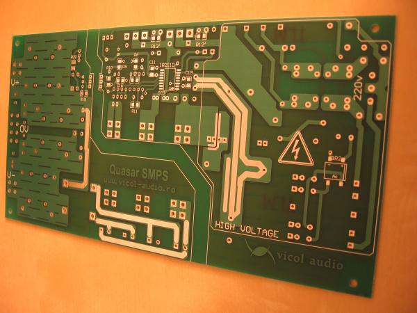

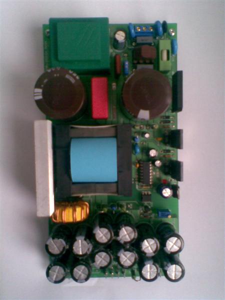

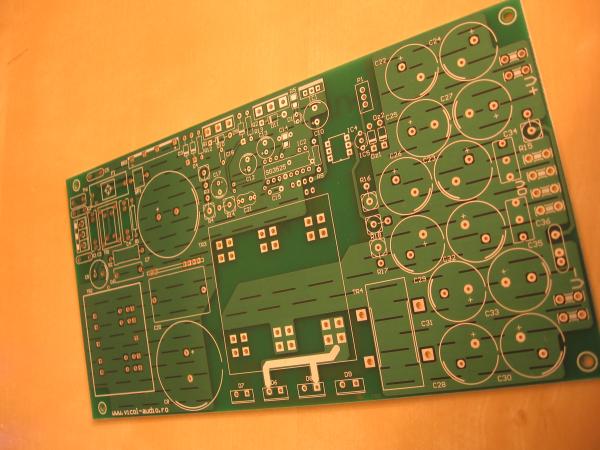

There was/will be 3 variant for now for this smps :
- version 0 = as in the first 2 pictures attached
- version 1 = as in the 2 last pictures attached
- version 2 = in the work now for future release

and fixed mistakes too?
We had few minor pcb mistakes which have been corected and we'll release gerbers (from corrected version 1) to public domain. 😉
We are preparing pcb version 2 which will be more flexible and probably partially monted (SMD parts).
The new board will allow tube fanatics to have a SMPS source as well. 😀
