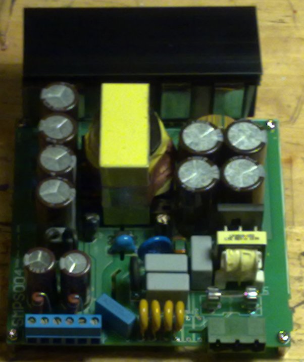

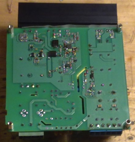

I have designed and built a 500W peak offline SMPS for audio use that I wanted to share on this forum.
I use it with a Class-D amplifier based on IRS2092 that I designed and everything works fine.
The SMPS is designed to deliver +/-50V at 2A continuous (for thermal reasons)
and a peak of 5.5A par rail (550W peak power).
It provides also a ground referenced auxiliary output at around 18V useful to
power protection circuits.
The SMPS is based on the Transition mode 2-switch flyback topology with L6565 PWM IC and pulse transformer drive.
In attached you will find the schematics and some pictures of it.
Here are the measured characteristics:
Input range: 187...265VAC
Efficiency @ 5.5A out = 92.5%
Efficiency @ 2A out = 93%
Standby power < 3W
Peak output current: 5.7A
Short circuit current: 18A for 300ms (hiccup cycle)
Output ripple < 200mVpp @ 5.5A out.
Magnetics parts:
Transformer: EER42/20 Core with ~1.5mm gap on the center leg
primary: 32turns 4x0.45mm (split in 2 16 turns layers)
secondary: 9 turns 8x0.45mm per section
bias: 3 turns 1x0.45mm
aux: 3 turns 1x0.45mm
primary inductance: 250uH
leakage inductance: 3uH
Pulse transformer: high permeability toroid core diameter 15mm
pri=sec1=sec2=20turns wrap wire, trifilar wound
EMI filter: stolen from a PC power supply... measured 2x15mH
Any questions or comments are appreciated
thank you
ciao
-marco

Nicely done. I've used the "DC Restore" diode in the gate drive secondary in some of my own designs and it does have one drawback. When the pwm is inhibited, by UVLO for example, the primary coupling cap can ring with the drive xfmr enough to turn on the main FETs. Maybe not all the time and maybe the energy in the bulk caps won't blow out the FETs right away, but it's still dangerous. I've seen it happen. What I've done is to minimize the values of the coupling caps and add damping. In 100KHz designs, I'd use a 0.1uF||(0.47uF + 50 Ohms) on the primary and 0.033uF||1K on the secondary.
YES, Pwrmad is right.......the DC restore prafo gate drive circuit is HIGHLY SUSPECT.........
http://www.edaboard.com/thread231931.html
I am afraid that this DC restore circuit must be decalred dangerous and a threat to the lifetime of the product.
Also, may i also say....
1...You need a PNP turn off circuit on your upper fet.
2....Why bother with the lower gate drive secondary....just drive the lower fet directly from the L6565 output.
3.....What is your peak and RMS current in fets and output diodes?.....i believe it will be ridiculously high when at 500W load.
....i think you need a continuous mode flyback......if you make it continuous above , say , 200W, it will be discontinuous at lower powers and thats fine for you.
4......have you multiple sandwiched your seconday.....otherwise each half of the output coil will not "see" similar coupling intothe core, and you will not get symetrical rails.
5.....npn/pnp gate drives are a bad idea, because the tolerance on such discretes is poor....and you cannot gaurantee enough hfe at high-ish Ic values.....also, the fT values willl be poorly toleranced..........you should use a proper gate driver IC instead.
6.........your primary fets and secondary diodes are on the same heatsink...so how have you got sufficient isolation between them.
7......your high primary bus capacitance is going to nuisance trip your fuse too often......the fuse manufacturer will tell you this wont happen...but it will.
8......When low bass notes are played, your split rails will loose symetry.....you need to solve this by doing an smps for each split rail... or at the very least, used weighted feedback from SGND and VREC+
9....C23 and C24 will cause you grief, they will resonate like mad with the leakage inductance when the fets are switched off.
10...R30 is the wrong side of C31
11....You forgot to connect SGND between C20 and C18
12....i think the use of Q5 is erroneous.
13...you have big heatsink for fets and diodes...but why then no heetsink for mains rectifier bridge.
14.....you need active power limiting circuit...becauuse your smps will go up in smoke if on 500W continuously...unless you can proove that under no circumstance will it see 500W continuous.

Also what speakers are you driving with that output...it must be several speakers in series?
also..is your start up circuit capable of supplying full operating current...if so , then you have insufficient short circuit protection.
ALSO....your SMPS will BLOW UP, because you are reflecting more than 300V to the primary, and at low vin, when the input caps are at the trough, there will be less than 300V there, so you will have big problem....I am sorry, it was great of you to present........i also always make big big mistake, and then some other tells me about it and i am sad.....but i must tell you my friend, so your DIY will be in future sucesful and you will be happy in the long term.

I notice that you say you achieved 92.5% efficiency with this boundary conduction mode flyback when Vin was 187VAC, and the output power was 550W.
I am sorry, but i believe that this is an error in the measurement.....there's absolutely no way a BCM flyback at 550W from 187VAC can do 90%+ efficiency.
How did you measure your input power?
Also, your claim that efficiency at 200W output was just half a percent less than at 550W output is impossible to believe.
I think you have a serious measurment error here.

Hi all,
thank you for your comments.
1) PNP turn off: I had tried it but I don't need to turn off the fets very fast.
My gate discharge resistors are 6.8R and they give me reasonably good
gate and drain waveforms
2) I don't like this. Using a dual secondary GDT makes everything symmetric and when the fets turns off they share the reflected voltage quite evenly.
3) At 500W load 230VAC input
Ifet_peak:9.24A
Ifet_RMS:3.19A
Idiode_peak:16.42A
Idiode_RMS:8.29A
At 200W load 230VAC input
Ifet_peak:3.69A
Ifet_RMS:1.28A
Idiode_peak:6.57A
Idiode_RMS:3.04A
With L6565 you are always at the border between CCM and DCM. It is true that in DCM peak and RMS current are higher but you can deal with it using bigger fets and diodes. QR operation has the following advantages:
- The fets turns on at zero current and minimum voltage --> turn on losses
are minimized
- Diodes turns off at zero current --> recovery time losses are minimized
4) Transformer construction
---------- bias 3 turns -----------
---------- aux 3 turns ------------
-------- 1/2 pri 16 turns ----------
-------- 1/2 sec 1 5turns ---------
-------- 1/2 sec 2 4turns ---------
-------- 1/2 sec 1 4 turns --------
-------- 1/2 sec 2 5 turns --------
oooooooooo bobbin ooooooooooooo
I hope this is clear. The windings are sanwiched and interleaved.
At 500W the rails are +49.5V / -50.5V
The best way will be to wind the two secondaries bifilar but I don't like it because at the exteremes there will be around 300V between the two secondaries that can easily break the enamel insulation and create a catastrophic failure.
5) I know that gate drive ICs performs better than BJTs totem poles.
However at those lowish power level I have always used this kind of
structure with no problems. Here you need a slow turn on and not a super
fast turn off. Anyway the main bottleneck in inreasing the gate drive
