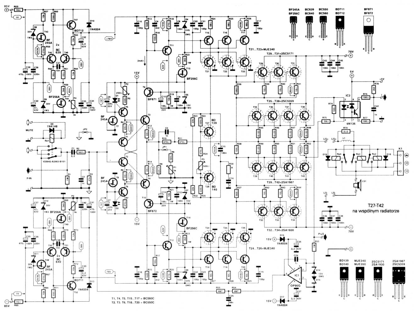

If you're looking for something tried and tested, check out this one:
More detail (and PCB) available at:
300/500W Subwoofer Power Amplifier

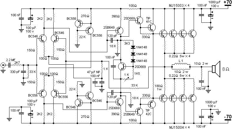

By coincidence, I found the one below yesterday. Looks interesting, but I don't know anything about it. Except that it could be from Elektor (as seen in the schematic style).

...first we are not supposed to post directly esp schematics ...
even though rods circuit is a work horse and if designed and used properly is actually a very good amplifier given the simplicity is made .
the P68's i 've made working more than 3 years continuously and absolutely flawless at 95% of the power for more than 12 hours a day ( powers a subs in a movie theater )...
Still this amplifier features no protection and if abused will eventually fail ..... design properly will mean pcb from esp
as about elektor circuits even though in simulation might work ...in real life it will be a nightmare to stabilize ...
Apex circuits s a very nice option i think ....

500W is about the limit of what is sane in a conventional class B amplifier. My guess is that a commercial PA amplifier in this class will either be class D or unaffordable. Not that there is anything wrong with class D, mind you. It is a lot more efficient, which helps to keep the weight down for one (less transformer and heat sink needed). But how does ultimate sound quality compare? Maybe somebody in the know can comment on this.

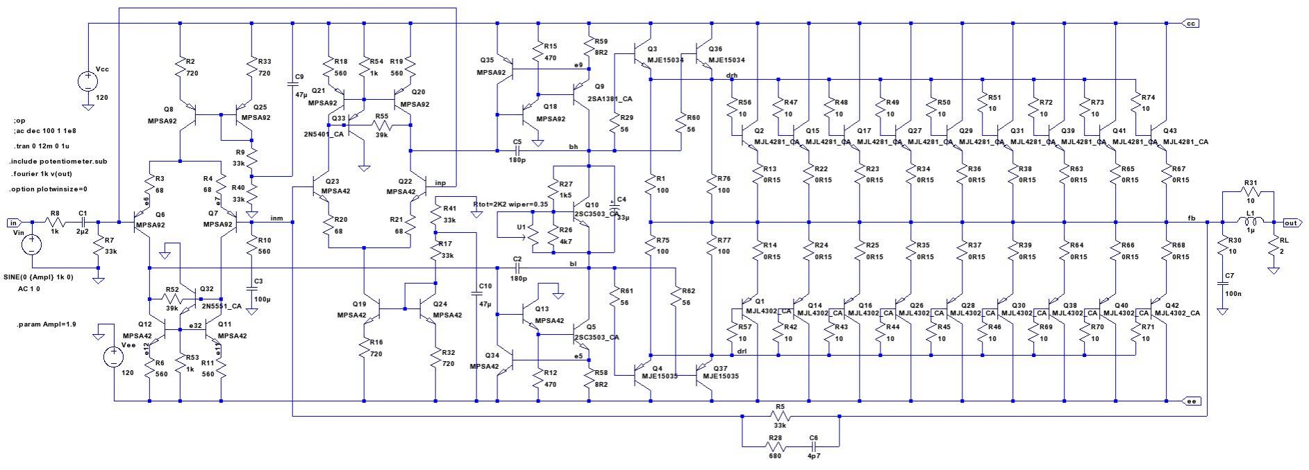

I have been doodling in LTspice with such a thing to see what is possible, but I am not building one. Don't have the funds, the time or the need for a 600W amp.
For output devices, the MJL4281 and MJL4302 work well. For ultimate performance. i.e. collector current not in the dreaded beta droop zone, about 10 of each is needed to drive a 2 ohm load (but you can get by with fewer of them). For 120V rails, output power is 3000W into 2 ohm, with THD at 0,0028%. Output current is about 55A by the way.
The input power is about 6kW, so we are nowhere near the theoretical efficiency - as predicted by AndrewT. This level of power is already somewhat beyond the power available from a normal 230V wall socket. I've seen a 3000W electrical heater melt its plastic plug to the socket when left on full blast for too long.
I present the schematic here, but it is nowhere nearly ready to be built. There are no VI limiters, for one. I haven't done any open loop analysis on it yet. The power supply is just two neat little symbols. In real life there would be a huge transformer, huge diode bridge, huge capacitors and huge relays to protect it all. Just taming the inrush current is a scary prospect!
